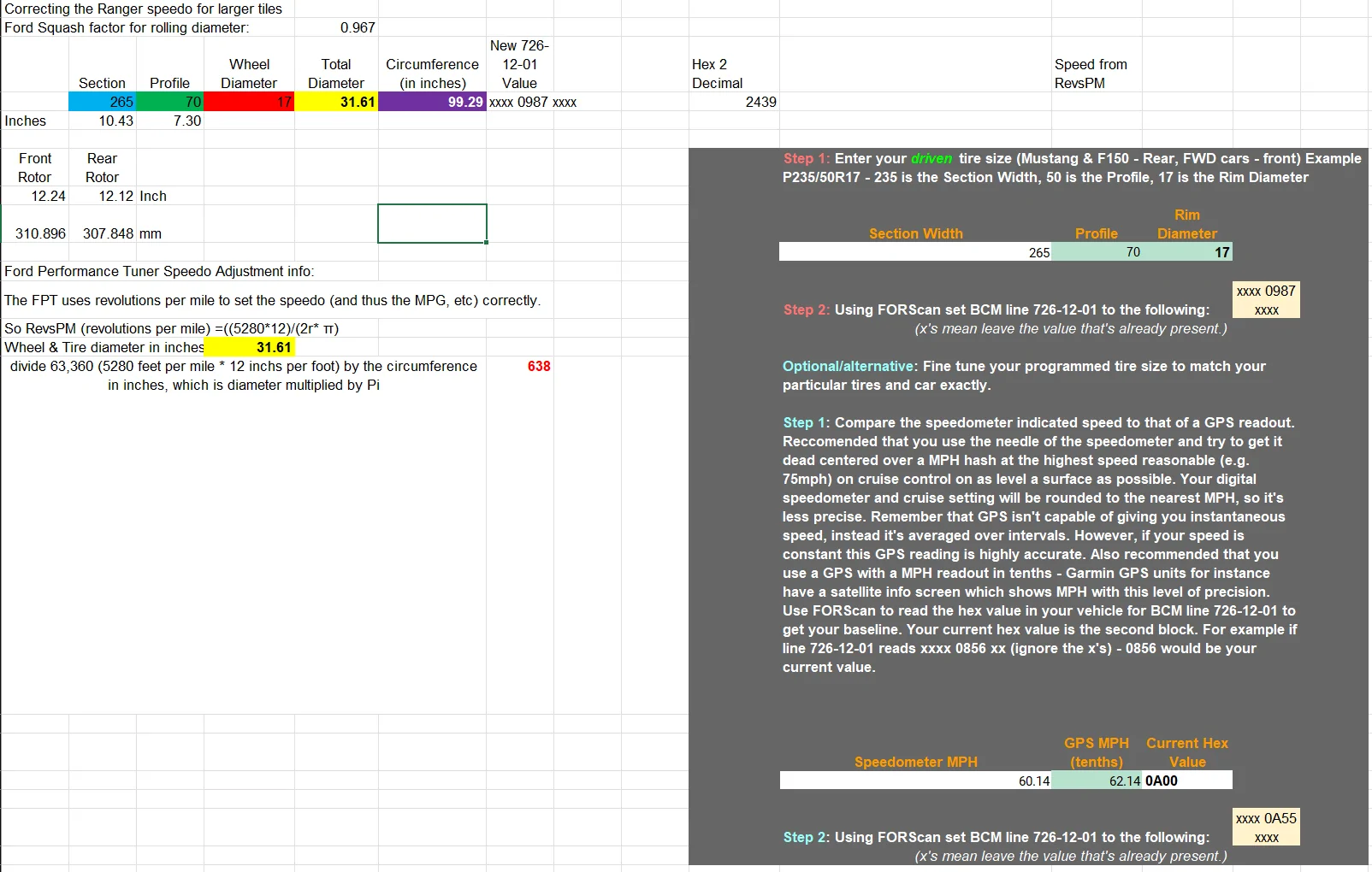

Just hoping this is helpful... originally from some post here on Ranger5G Forum...
It does vary by brand but a good start.

If you are looking for the circumference of circle with 31.6” diameter ...
Circumference = 2 x Pie x Radius.
Radius of a 31.6 " circle = 1/2 the diameter = 15.8"
C=2πr. 2 x Pie (approximately 3.14159) x 15.8" = about 99.3" or 2521.5 mm
Unfortunately, actual dimension varies a lot by manufacturer but that gives a really good starting point and a formula to work with. I cheated and Googled it. :)

I took Google's number and changed it, then drove 10 miles to see how close the odometer was. Brought the laptop and made an adjustment and headed back. It is really, really close now. The factories set the speedometer a bit fast as they have been sued for having it read slow. Traffic tickets and lawyers and all.
