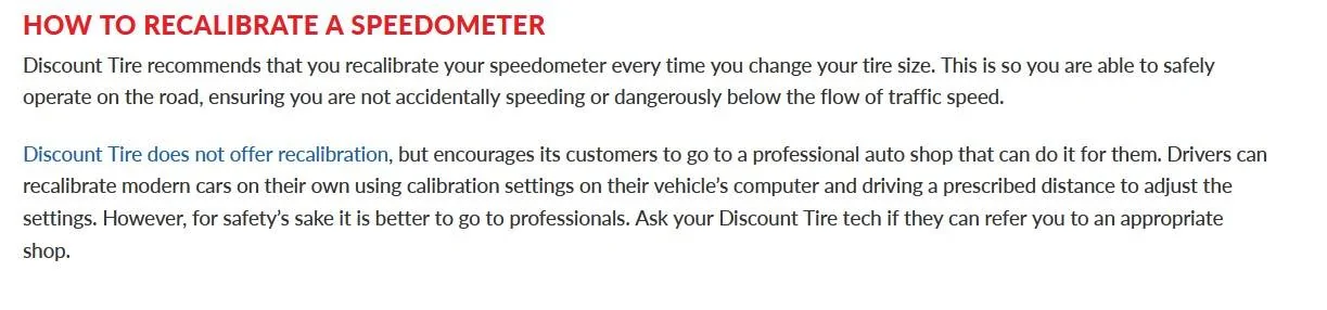

BTW, Discount Tire did not re-calibrate the tire size, see below.
Somehow the truck must have recalbrated iteself?
Or it was set to a higher tire size from the factory? I never tested the speedo w/ GPS before
My guess is the truck was set at th factory about 4% higher than stock size, which is a about the difference +1" in tire diameter makes. From my Googling, speedos seem to be set higher from the factory, doe liability reasons. I'll confirm when I put my smaller snow tires in in November and go a GPS speed test.
