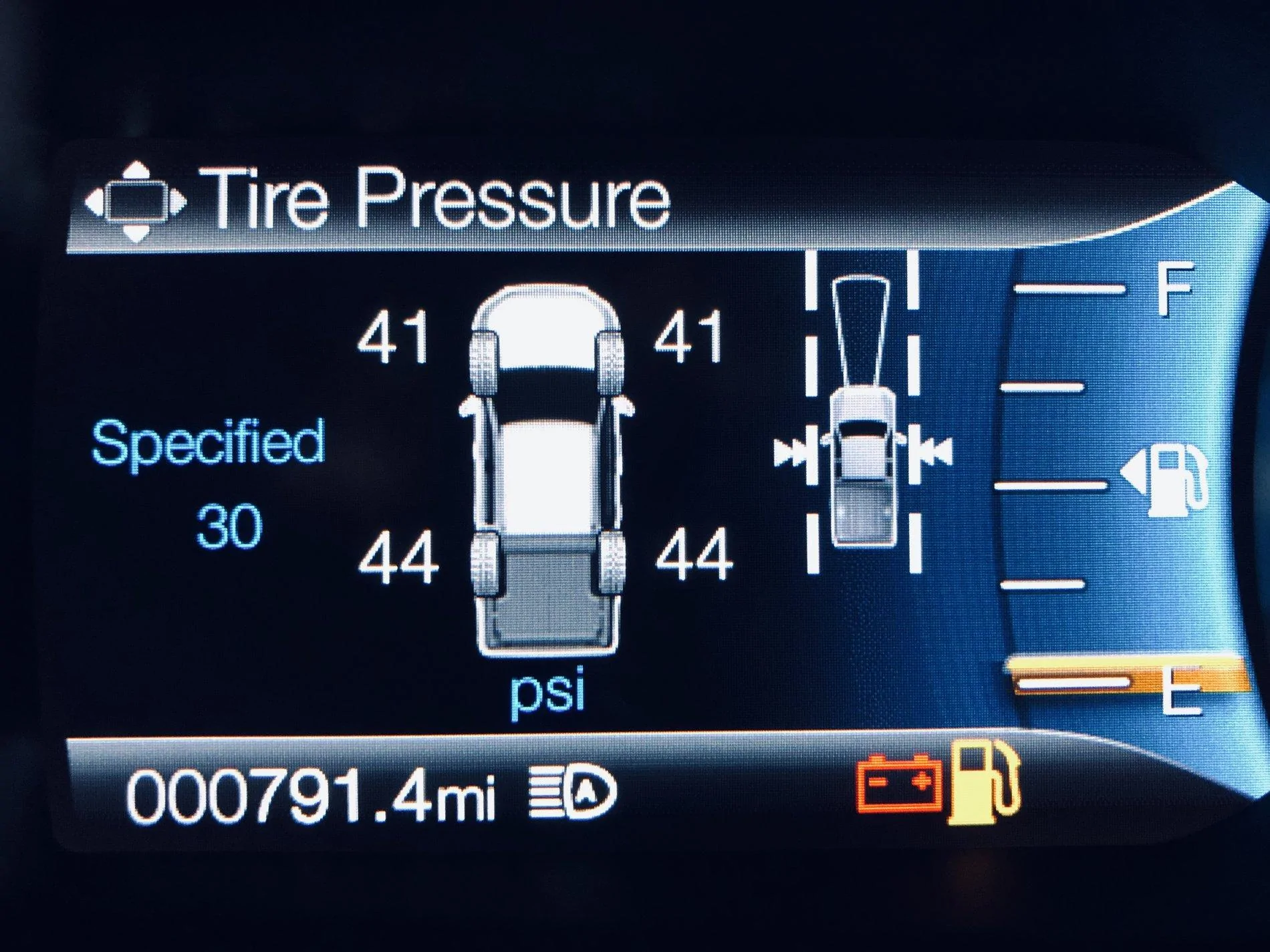

I found another FORScan option that works from the F-150 list https://docs.google.com/spreadsheets/d/1uDSQ1Z5a2Wt8-kjrSiVSlDFGFHnfeuhb3RTMVz95730/htmlview#
Specified Tire Pressure
And yes I know my tires are over inflated. I fixed that right after I found this option.
I’ll also add this to the wiki page as well.
It seems the specified tire pressure option works and displays.IPC - 720-04-01 xxXx xxxx xxxx
0 - (Disabled, default)
8 - (Enabled, show specified value)
