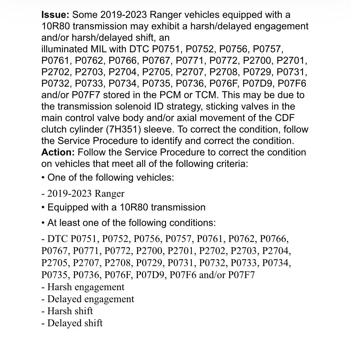

So a really common problem I'm seeing with all of our rangers is ROUGH and Delayed clunky shifting. I'm also seeing that alot of ranger owners have to replace their transmissions before they reach 100K miles. This sucks. You can bet this harsh delay and clunky shifting is a contributing factor to the short life span of our transmission
A brand new technical service bulletin (TSB 24-2046 ) was just released a few days ago on February 22, 2024.
Title: 10R80 Automatic Transmission - Harsh/Delayed Engagement And/Or Harsh/Delayed Shift - Non-Main Control Break-In Capable
Issue: Some 2017-2020 F-150, 2018-2021 Expedition/Navigator/Mustang, 2019-2023 Ranger vehicles equipped with a 10R80 transmission may exhibit a harsh/delayed engagement and/or harsh/delayed shift. This may be due to the transmission solenoid ID strategy, sticking valves in the main control valve body and/or axial movement of the CDF clutch cylinder (7H351) sleeve. To correct the condition, follow the Service Procedure to identify and correct the condition.
I've attached the TSB document for you to see but to me, it looks like a BUNCH of work on the transmission. There's even some language for newer/low mile vehicles to have a complete transmission replacement. Not some little gasket or plug and play replacement. Someone smarter than me can look at it.

Is it true that the tranny can throw a code and not illuminate the CEL? And so the TSB is for dealers to check for codes, even if you are not having any significant symptoms?
Stevedbvik1
Oct 4, 2021
2,731
8,131
2022 Ranger Tremor XLT
Checking for codes is part of the diagnostic steps but having a code(s) is not mandatory to proceed with the TSB.
So you need to have a symptom to have them apply the TSB? Or should they just check for 'hidden' codes?
airline tech
Aug 24, 2022
4,482
8,551
Midwest - KS
Aircraft Tech
Either one of those codes or a listed symptom or a combination of both.
and they are not hidden codes, they can be viewed with a scan tool - history codes.
If the check light is not illuminated, then it is possible to still have a failure code logged into history.
You can see this with Forscan as well.
