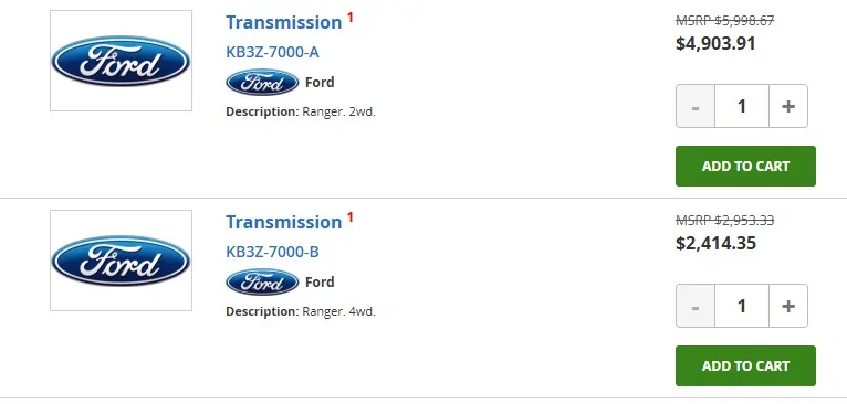

Here is the price for - OEM Ford Parts Direct, No high price dealer mark-ups for a reference of costs.
Labor = Approx 10.0 Hours - Book Time
@ (est 200.00 hr = $2,000 Labor

Why is there such a huge difference?

Thing only thing I can figure is volume. Way fewer 2wd’s are built??? So the unique parts are more expensive??
Are they physically different?

I'd almost wager that the units are the same length,
I'm curious. Does adding the cost of the transfer case to the 4WD bring the prices closer?

Just convert to 4wd at the price difference. Kidding, but $2500 gets a lot of conversion done. Seems like robbery. Back in the day the only difference was the tail shaft.

Driveshaft’s are different between 2wd and 4wd, most likely length difference seeing the flanges are the same on both. MSRP on the 4WD transfer case is around $2000. Of course it brings them closer in price but your still getting less material with the 2wd.
