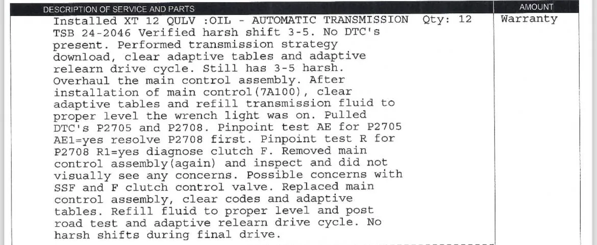

Mine just got finished having the second step of the TSB ( valve body) done. I have the MBS dipstick and they didn’t say a thing about it. I did mention it both times before having it worked on. I imagine the tech probably appreciates it and makes his job easier

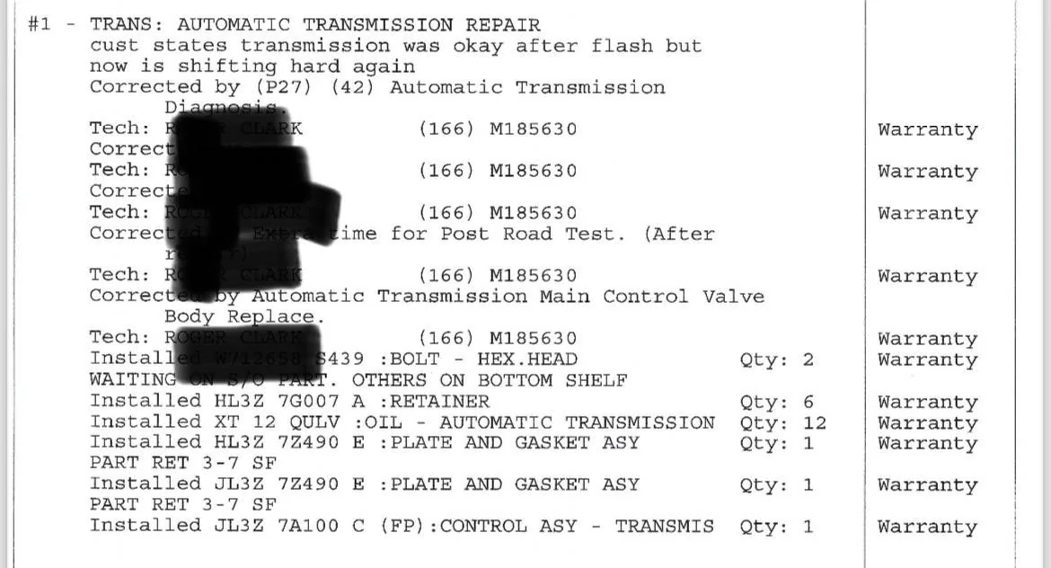

Took my Ranger in friday for TSB and fluid change friday. The tech reflashed, but did not do the fluid change. He said drive it 200 miles, then bring it back in. They want to either rebuild or replace the transmission. Sounded like they actually want to do the warranty repair. Does this make sense? I'm almost at 60000 miles.

Yes. I’m convinced that it’s a money maker for them. Sounds like they’re following the “plan”

Thanks. Sounded like they want to replace it either way.

So the second step of the TSB has been done on my truck. Looks like they did the inspect and clean on the valve body. But after reassembly and road test it threw codes. They then replaced the valve body and road tested good. I haven’t driven it yet as we’re still in Florida. My son is picking it up today and driving it 1.5 miles to our house and sticking it in the garage. He drives a Ram so his feedback will be useless ?. But it will be the first week of April before I can shake it down. We’ll see what happens.

I just dropped it off at the dealer again, and they are going to look and more then likely move on to the next step of the TSB.
Just got a call from the dealer and they stated they can't get it to flare the shift like it was previously and there are no DTC codes, so it looks like everything is fine. I told them it is more likely to show the flared shift first drive in the morning, and they said they would keep it overnight and try it again in the morning.
