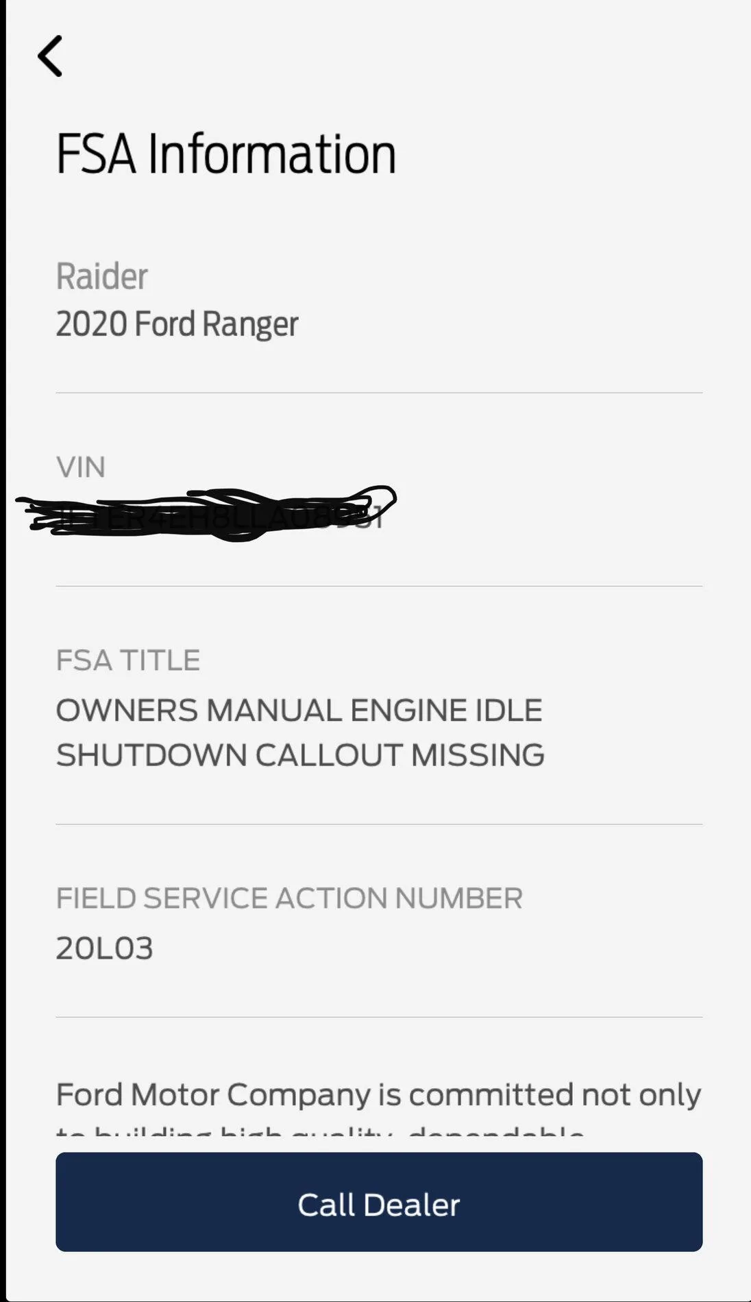

Anyone else get this? Anyone know what it means?
Yep, I have the same message. Not sure what action needs to be taken.

Hi Jon,
You will get a page insert in your owner's manual in most cases. It is an FYI as it was missed in the owner's manual printings for many Rangers. A pox on the responsible manager at Ford for such a lousy job editing the owner's manual.

So it’s nothing mechanical with the truck?
Hi Jim,
No...just to remind you that there is a setting from the steering wheel buttons on the left to function and possible disablement in cares like I had to do for this Inane Sync 3 update for maps...I burned up a ton of gasoline after I figured out why the motor quite during the install. This whole Sync system has to be broomed for a system that in more than Orville and Wilber used to get their plane off the ground.
There should never be a need for Forescan for any Sync related crap.... Flippin system needs to be abolished for forward models and only supported for people like us that are stuck with this POS.
I was there when Sync was launched and it was a POS....Nothing has changes...Still a POS. Head of Product Development that pushed the launch of Sync, lost his job over this POS system....Why it continues I have no clue other than it is entrenched. Sync needs to be DEFUNDED...
