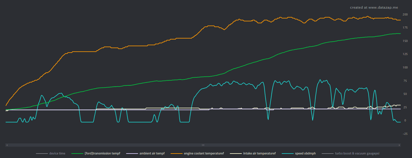

It does, but it would take forever to get any appreciable amount of temperature in it.
I used to think that Ford routed coolant from the engine and used it to warm the trans. After logging data and watching temps for a while, I'm not convinced that is the case. Our engines just don't make a lot of heat and in colder temps it is all they can do to get themselves up to temp, and the transmissions lags WAY behind that.
Best way to get heat in the trans is to drive...or idle through stop-and-go traffic, that does a pretty good job as well.
Here's a good example:
https://datazap.me/u/ctechbob/log-1705740120?log=0&data=1-2-3-4-5-6
Cold morning (23f) my 14 mile drive home from work. It takes almost the whole trip for the engine to get close to 200 deg, and the trans is JUST making it to over 160, which is generally regarded where the 10R80 is starting to be happy where the fluid temp is. (They like to be between 160-220).
