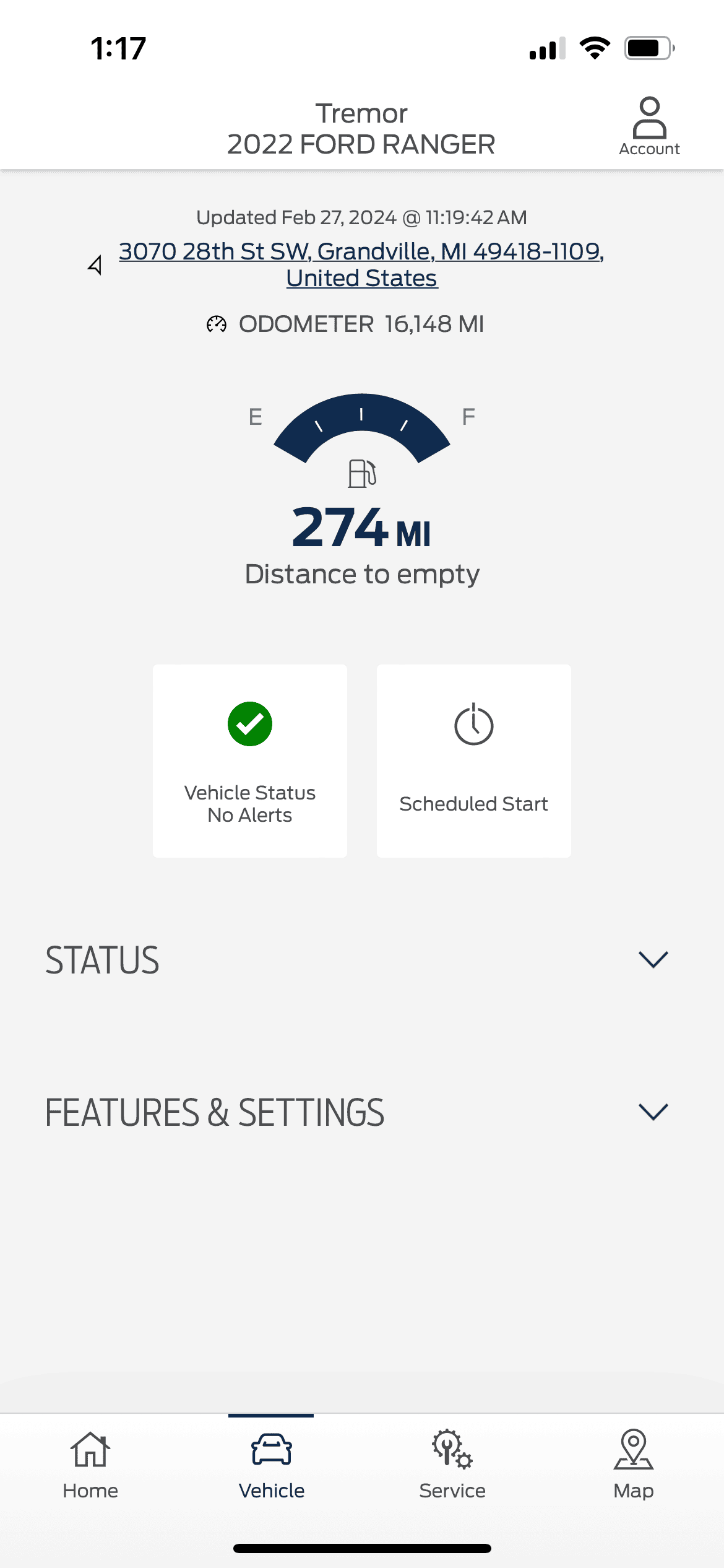

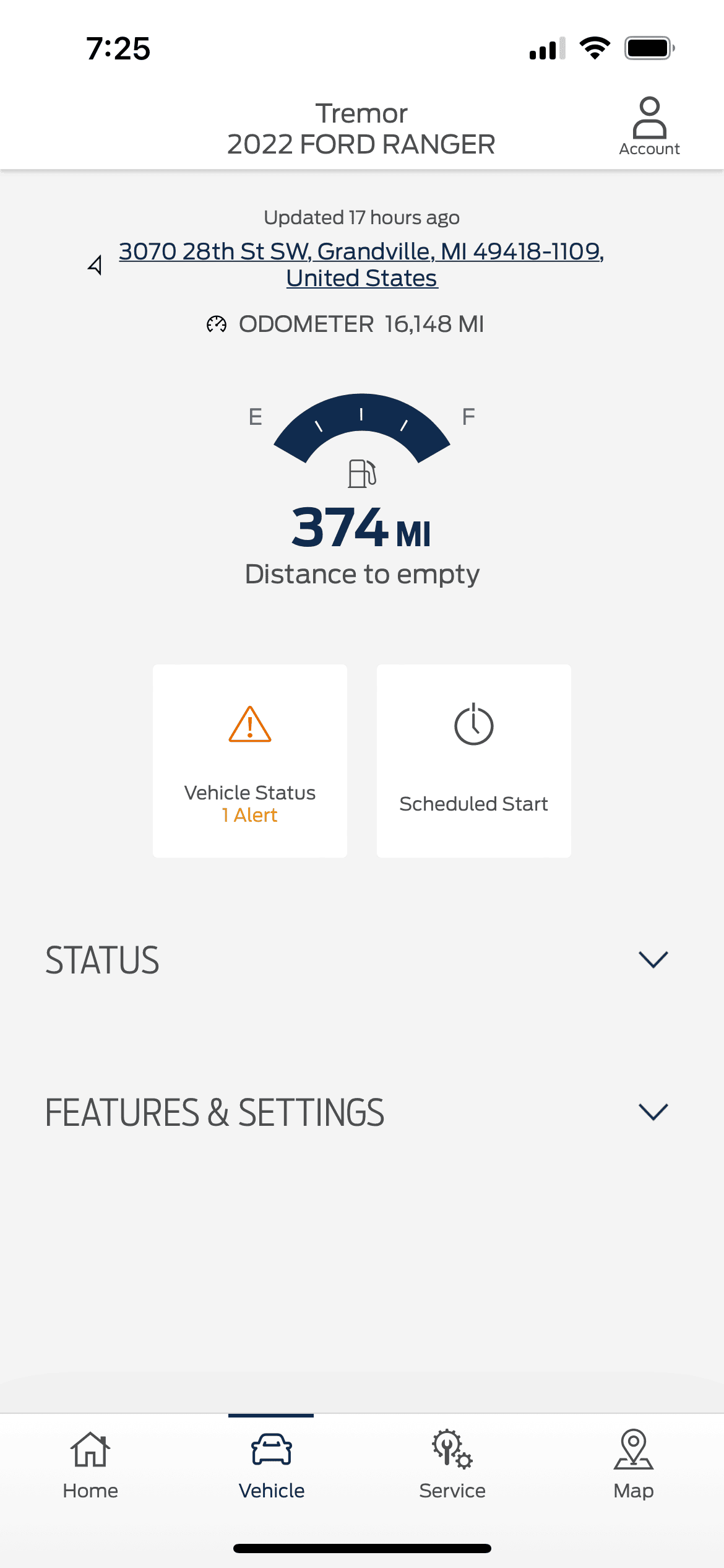

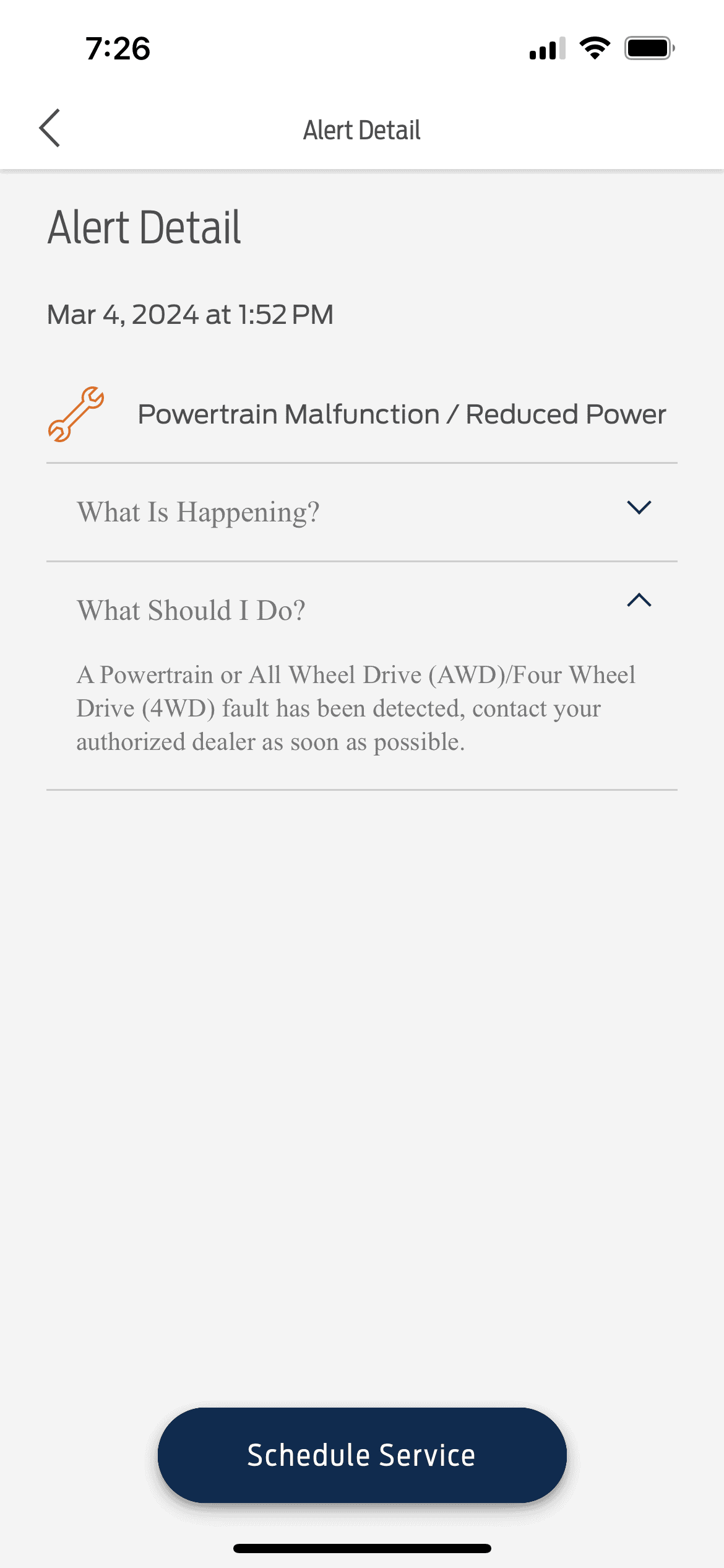

So my truck is currently having the 2nd stage ( valve body) of the TSB done at the dealer. Yesterday I got an alert from Ford Pass app for a power train malfunction. Texted dealer this morning to ask what it was and they said it’s repair related. Whatever it was also gained me 100 miles in distance to empty. ?‍♂

That's them test driving it before and/or after repairs, which is a good thing as some repair shops will apply a 'fix' then drive it around the block and say, 'all is good'.

Note no change in mileage from drop off date to code popping. So no it wasn’t driven according to the app

Well, that's odd. Maybe someone sucked gas out of the tank?

It added 100 miles of estimated range . It was pretty much a full tank when dropped off.
