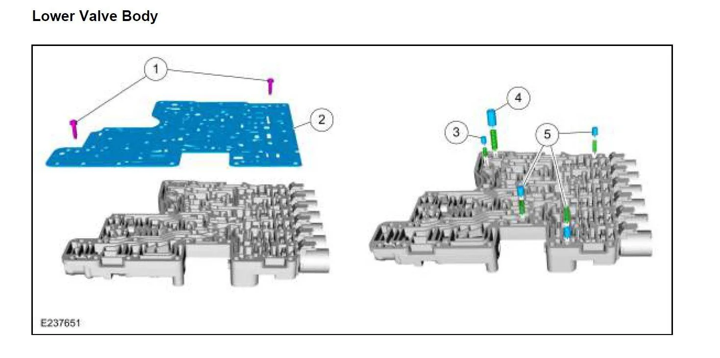

Here’s a great example
thats the valve body?
holy heck, that is not what I pictured a valve body to look like. lol
I can see how there would be issues with the design though. . . can I just get a manual transmission? please and thank you.

looks like that is the lower valve body without cover. . . and maybe without solenoids on it?
