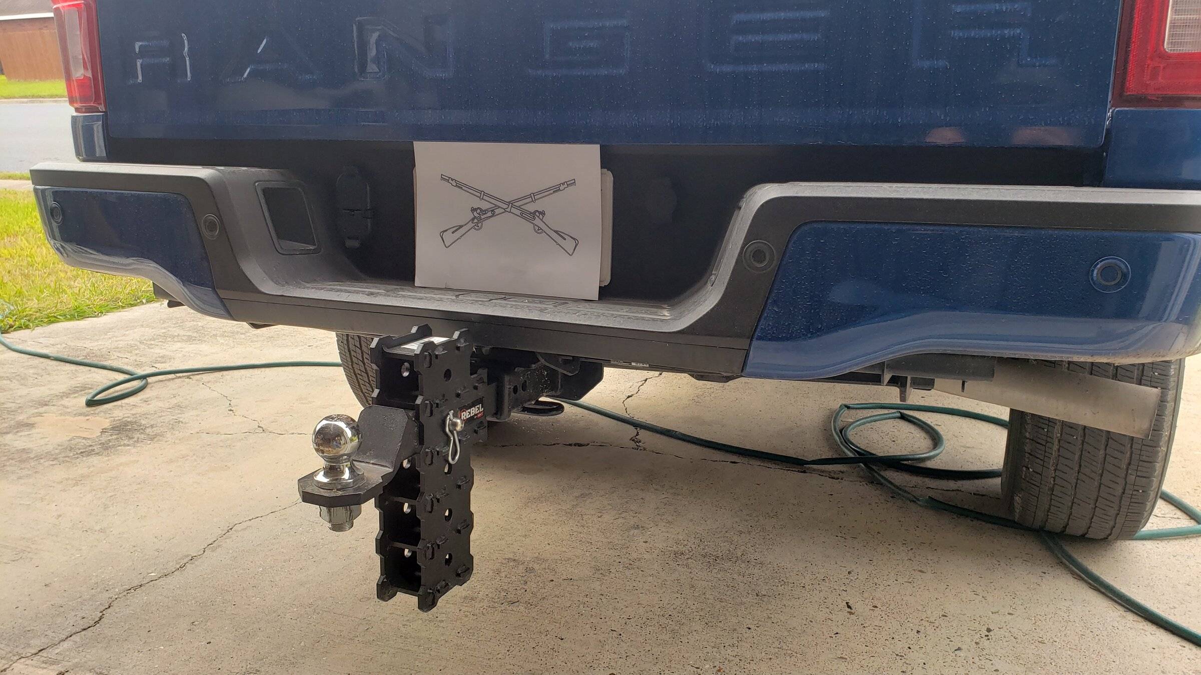

Yes you can do 7500lbs pull. This is my setup. The receiver says 8k with weight distribution hitch. Catch is the ranger is rated for 7500. Factory wiring, i bought and installed it.
Even legaly you are good.
I am no lawyer
But if this brakes the law as in not equipped from factory good luck with your wreck,
Then at least half of the heavy duty trucks running goosenecks and 5th wheels are not as equipped from factory. They all have aftermarket attachments. Could be a few with factory 5th wheel or gooseneck connections from factory????? No not predrilled holes in bed, but actual attachments.
I use surge brakes on my trailers, utility trailers, because brakes on trailers at a certain weight are required by law.
Though 7k is the heaviest i can go because my GENY HITCH is only rated for 7 k.
So..........
I am not properly equipped, and cannot tow 7500 lbs.
Ball rated for 8k and pins rated at 10k.
So yeah, you can tow, all rangers are the same. Just make sure you have proper equipment.
Be safe, drive smart, keep the rubber side down.

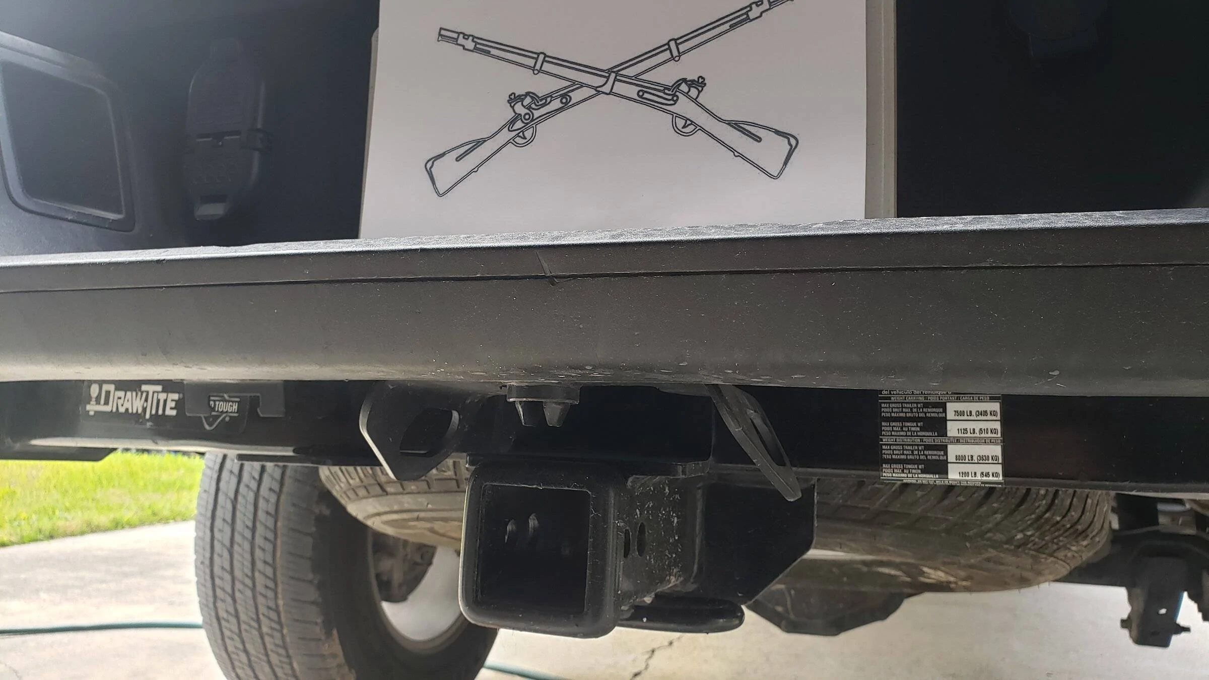

Thanks all. The manual link was helpful as well. And to clarify again for all the IANALs out there, I was just looking to confirm that my research was correct so A) the truck was able to tow at the higher listed capacity (ie specs the same between), then B) if Ford itself considers the addition of Ford parts which comprise the package effectively constitutes a trailer tow package installed post-factory. I have the dealer contacting Ford corporate to confirm and have submitted a query of my own with an initial response.
What I've confirmed so far, between rep and factory Ford manuals/documentation:
  • The tow package (53R) consists solely of a 4-pin/7-pin wiring harness and Class IV trailer hitch receiver (Fords is rated at 7,500lbs, installs in factory location in the heavy duty style as reflected in the manual)
  • There is no gear ratio/diff difference (both LSD, 73 code), nor motor/tune differences as the 2.3L ecoboost is the only option across the model for US market
  • There is no WB difference across Rangers, regardless of package/trim
  • Even trucks without the package have trailer sway control and tow mode included (confirmed on mine), and 53R packs appear to not have any further coding
  • There is no cooling upgrades (trans oil, radiator size, etc.) that I can find which would indicate any further differences between those with/without
Further, the CPO truck I picked up luckily has a trailer brake controller which satisfies many states' needs. I don't plan to tow often but if I do, will do so with an appropriately rated ball and associated safety gear.
