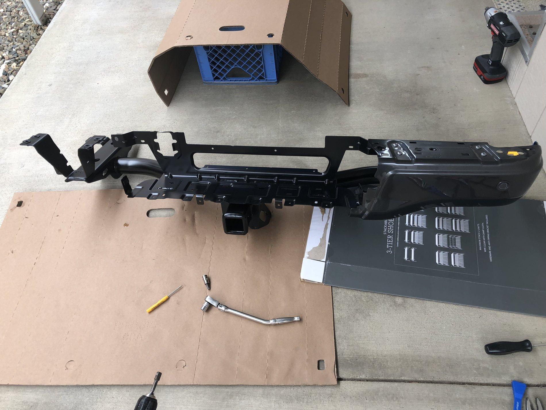

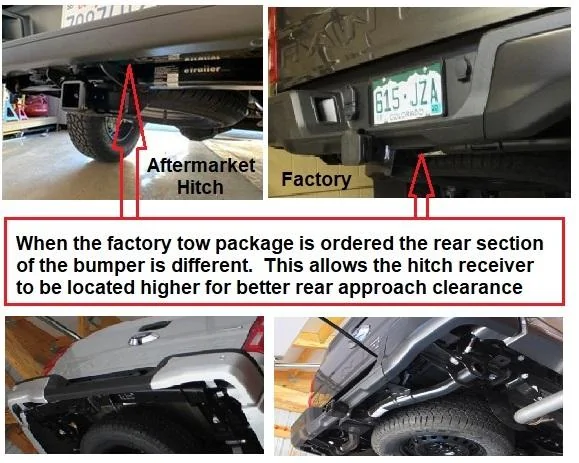

You folks keep forgetting about the rear bumper modifications. By the time they disassemble the factory bumper mount ball support and the bumper center section, and then re-assemble the new center section of the bumper and the hitch, the dealership will loose money on this.
There's a whole lot more to this than just bolting on the new hitch.

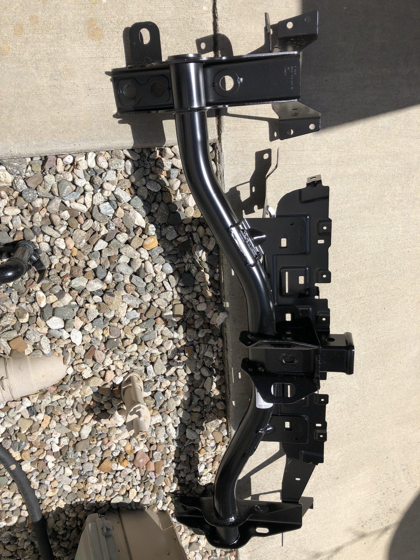

Factory Hitch

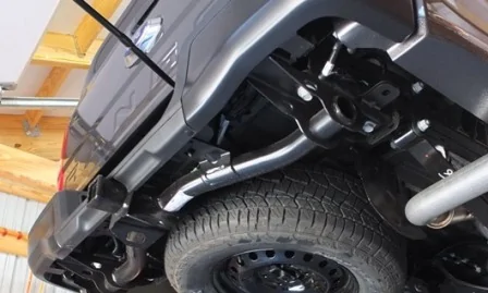

As viewed from below, factory hitch and bumper center section.

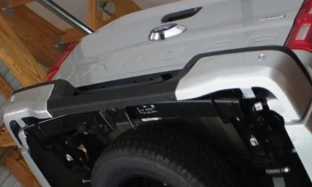

As viewed from below, factory bumper ball mount cross member assembly.
