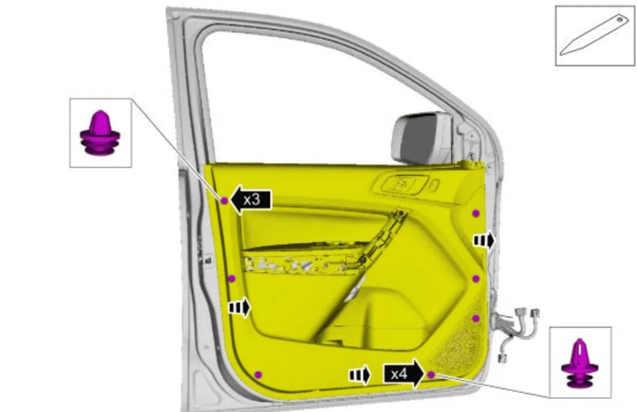

Anyone know the Part Number for these. I plan to install the TBC this weekend. I will swing by my dealer for a few extra clips. I do have some generic Subaru and Mazda clips, in case they fit.
Apples
Alan
Jun 14, 2020
687
1,318
Roswell, NM
2019 Ranger XLT
I don't know the number. I bought them to use on my then Honda turbo, but they're the same for the Ranger. Your local Ford dealer should know.
The screen dump shows the two types used (purple).
