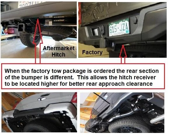

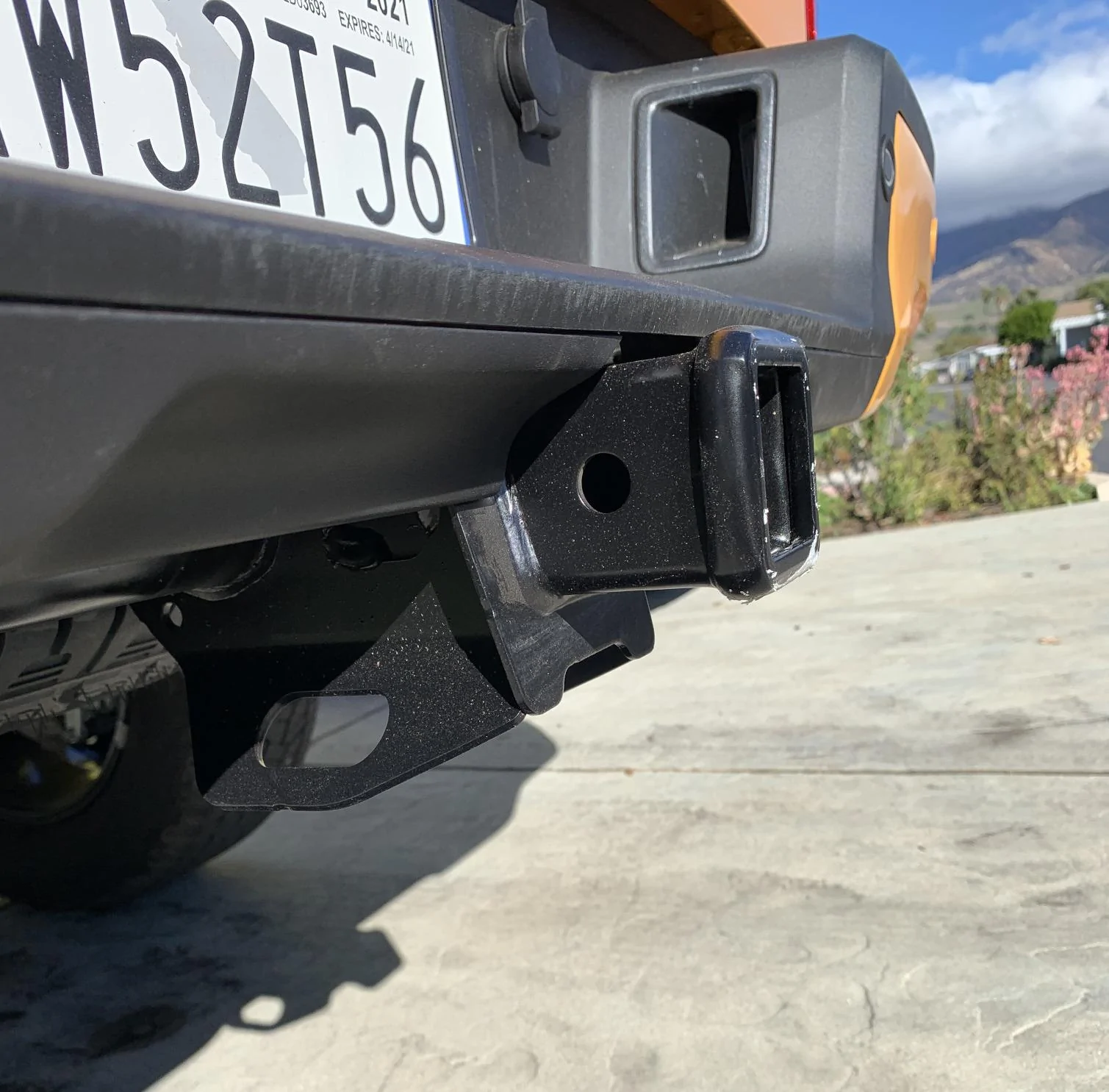

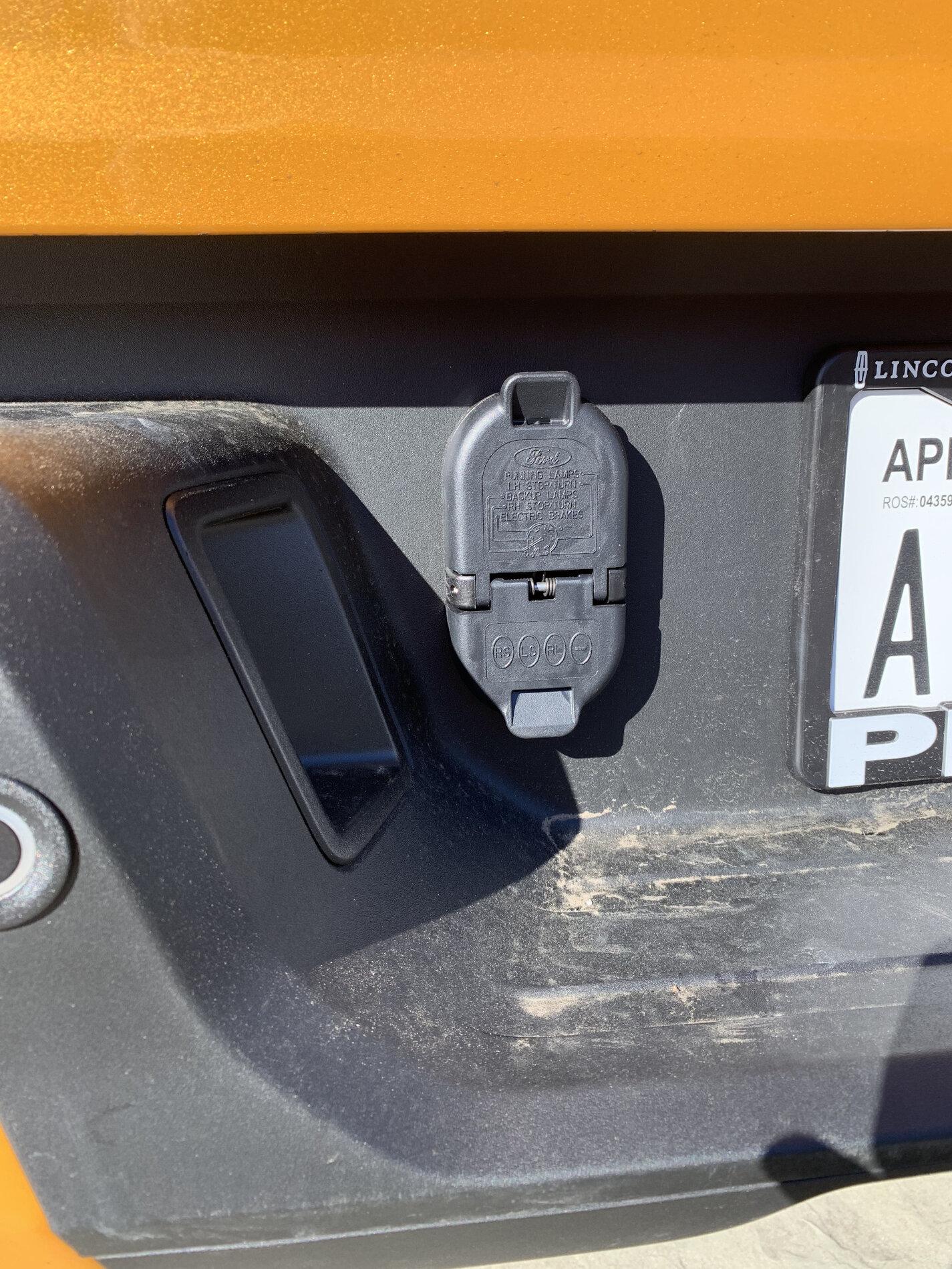

I had a Drawtight receiver installed on a previous 4X4 Truck that was prewired by the manufacturer. I towed a 17 ft. boat and this setup did a great job!I out an aftermarket receiver on. Drawtitght. 7500 pull and 900 tongue weight. Installed factory wiring and a factory 7 pin pkug on the bumper. There is a thread here with part numbers and lots of advise on how to do it. The drawtight receiver sits about an inch forward of the bumper. It does not protrude out like the factory one. No big deal. Weight carry depends on state. I plan on a small 21 foot 6000gvwr travel trailer so i will be getting after market trailer brakes too. A thread here on that as well. So long story short, you can instalk what you need for way less than dealer price. Inhave tow mode blind spot, trailer sway, just no locking diff or 4x4. Xlt model. Plan on upgraded shocks and exhaust and maybe a tuning mod.
