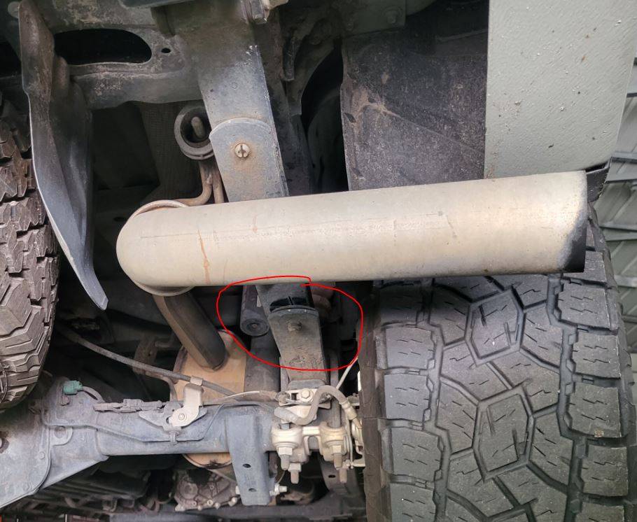

- OEM exhaust.

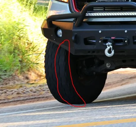

- Does not look not lifted. Although it does have bigger tires. Maybe a smaller spacer lift but that shouldn't matter.
- Your rear passenger leaf spring looks cockeyed in that one picture though?
- Does the front passenger tire have a bald spot? The whole inside tread looks flat. Unless its a camera thing.
It doe's look sort of crooked, I'll have to run out and look at that real fast. The tire is just the camera and lighting. The tires are in good condition and I just had them rotated after that trip to the Dragon where that picture was taken. I live off of the worst road in Alachua county, so I wouldn't be surprised if my suspension was a little wonky......Just checked and the leaf spring is crooked - good spot! I'll have to see if they can put it back where it needs to be.

I've just posted a few pics. Let me know if you need any more or if you want a picture of something specific. It all looks stock to me besides the tires and front bumper. The bumper doesn't weigh too much. I think its around 300, but that's not enough to cause a major shift in MPG and I don't generally have anything in the bed. When I was towing the bikes in the back with all our gear in the cab it was easily another 1200lbs and I didn't see much of a shift in gas mileage. I think I got 16.1 average over the whole trip. I usually get 16.4 if I drive it without thinking about how I'm driving it and 16.7 if I'm being gentle with it. That's still less than a F150 V8 coming out of this 4 cylinder though...

The tires are not OEM - tremor should have come with general grabbers - at least in 23 they did. but not uncommon on used vehicle to have different tires. they are similar weights to stock.
the truck comes a smidge higher from factory ~an inch.
