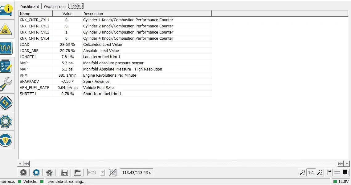

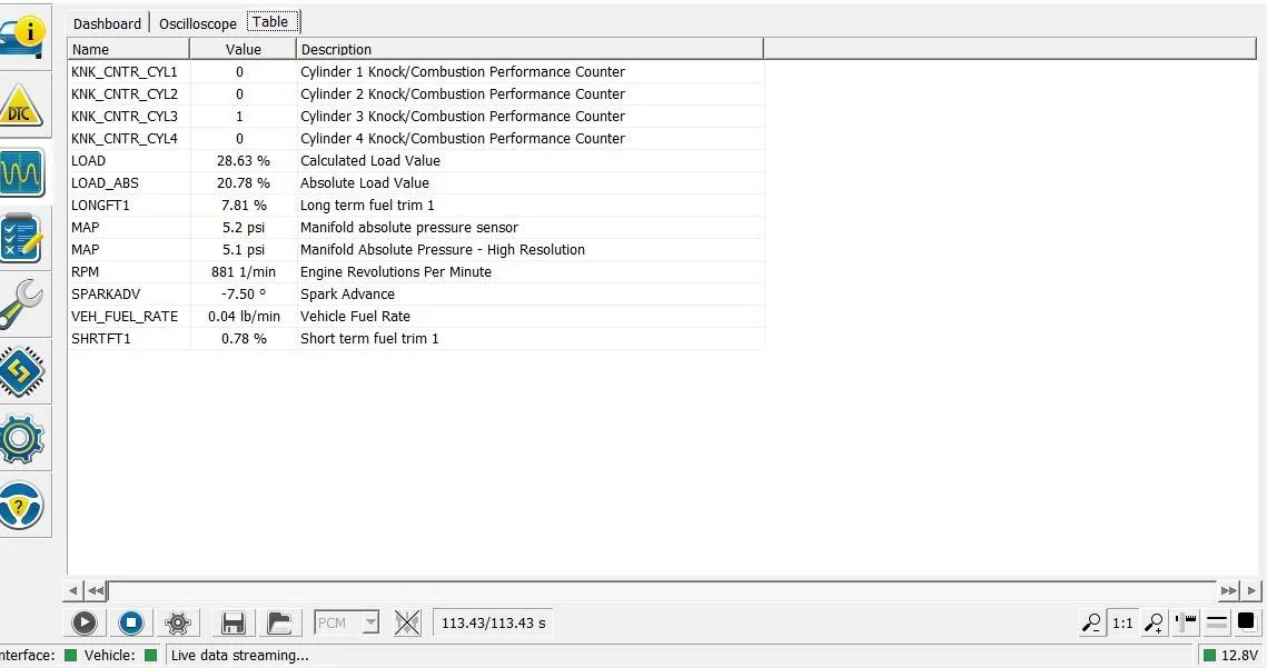

Just did a quick hook up in garage - all in garage, no driving.
KOEO
Cold Idle:
Hot Idle @ 198 Deg
Hot @ 2700 RPM - IN Park (Not Driving-Under any Loads)
This will at least give you a baseline reading on the MAP sensor and see if yours is off, Focus on MAP -KPA

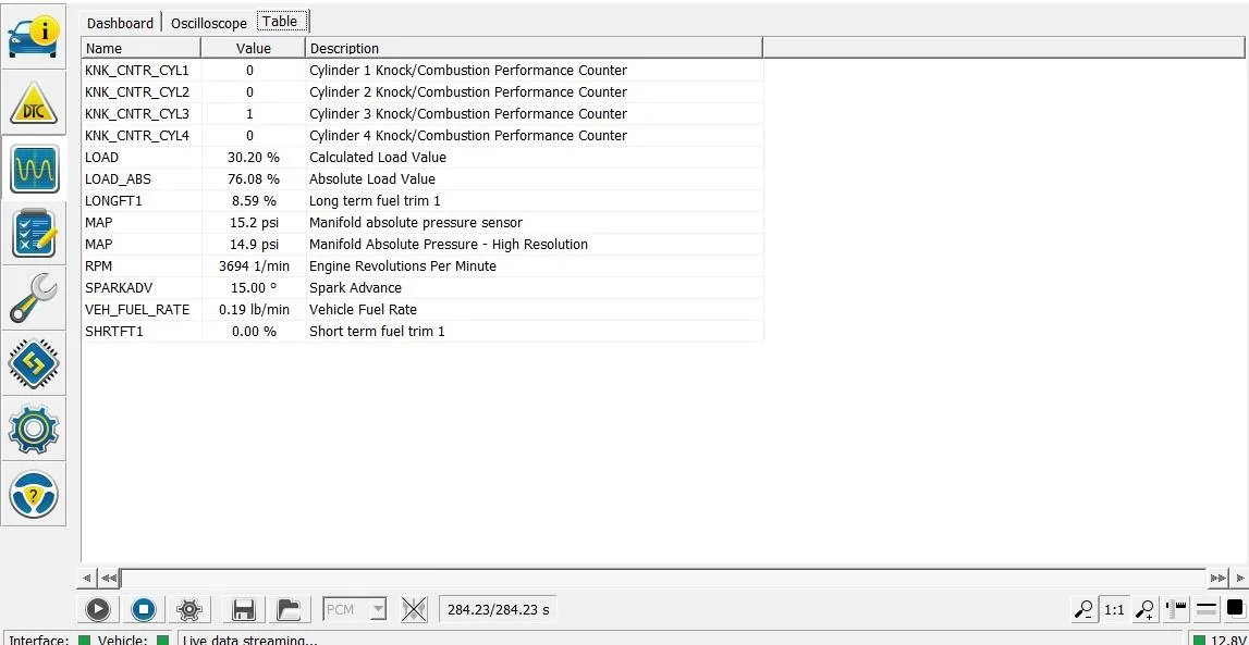

And a quick snap-throttle, to get the MAP PSI Reading to move and settle back down to idle.
I got the snapshot @ nearly 3700 RPM.
Snap Throttle = Push to Floor and Quickly Release, this checks the MAP for response
Anyway, it's a shot in the dark, but the only thing I can think of is the MAP as far as improper inputs to the PCM.
This is my First (Turbo) so I do not know if Oil can cause a spark knock, I do know that the Ranger is very picky.
I am thinking you may have a MAP sensor reading a higher PSI than it should and just wanted to give you a normal reading of the MAP Sensor

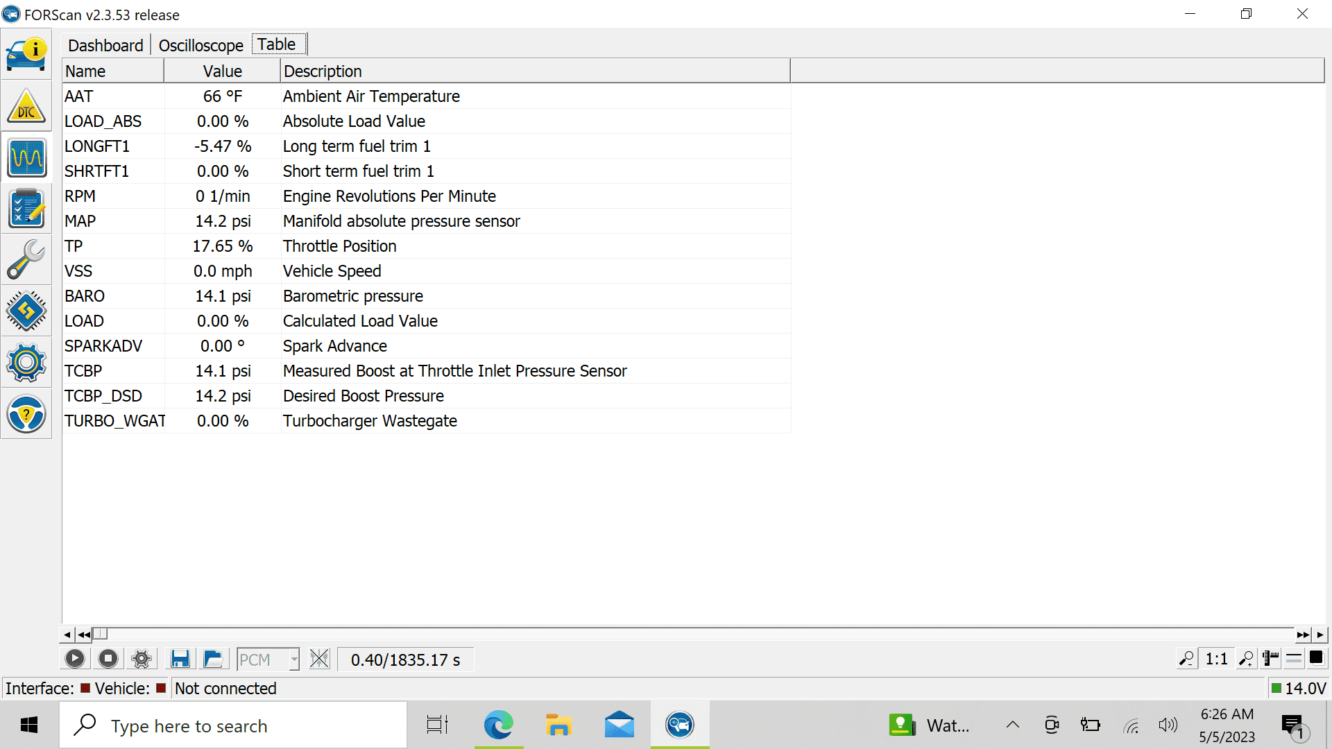

Another Confirmation Check:
Check these PIDS at KOEO:
Spec is 14.5, but 14.1 or 14.2 is good.
Baro Press: (PCM)
Map Press (Map Sensor)
TCBP Press (Turbo Charge Boost Press)
They should be within 1.5 PSI of each other, but equal is preferred.

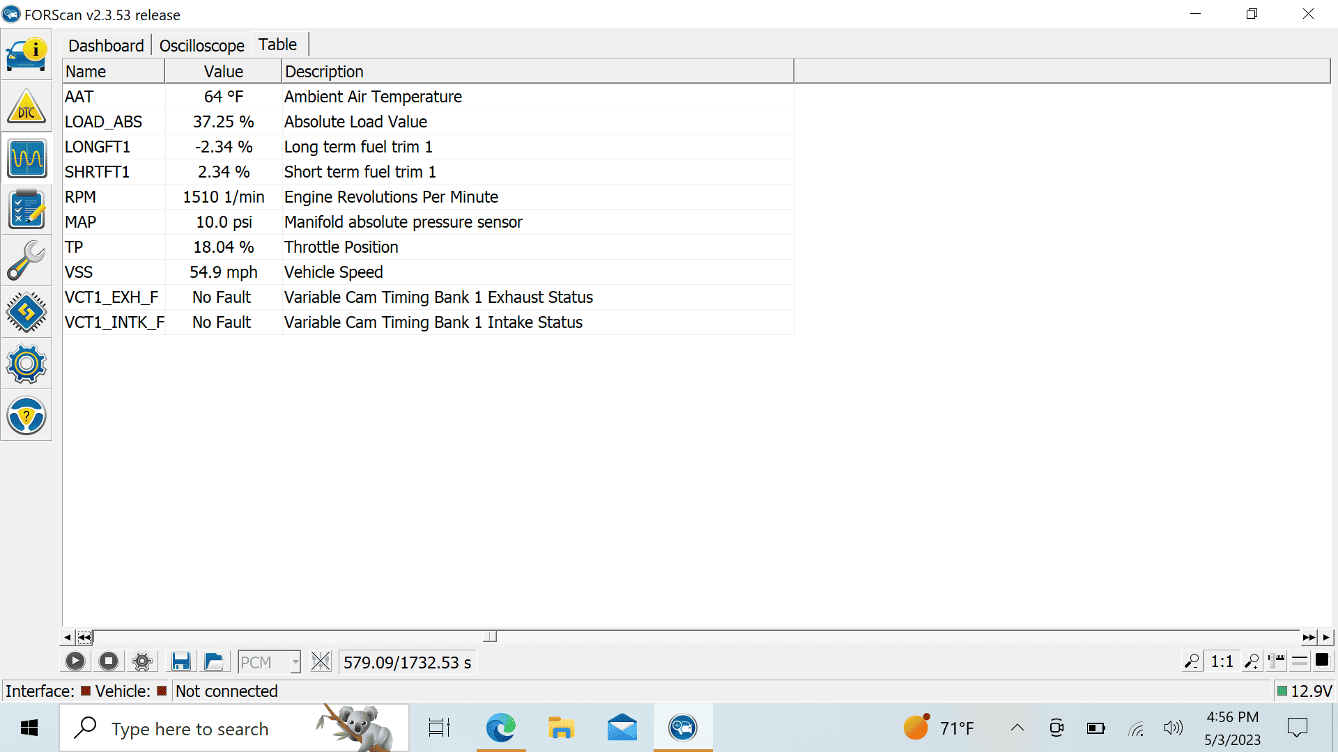

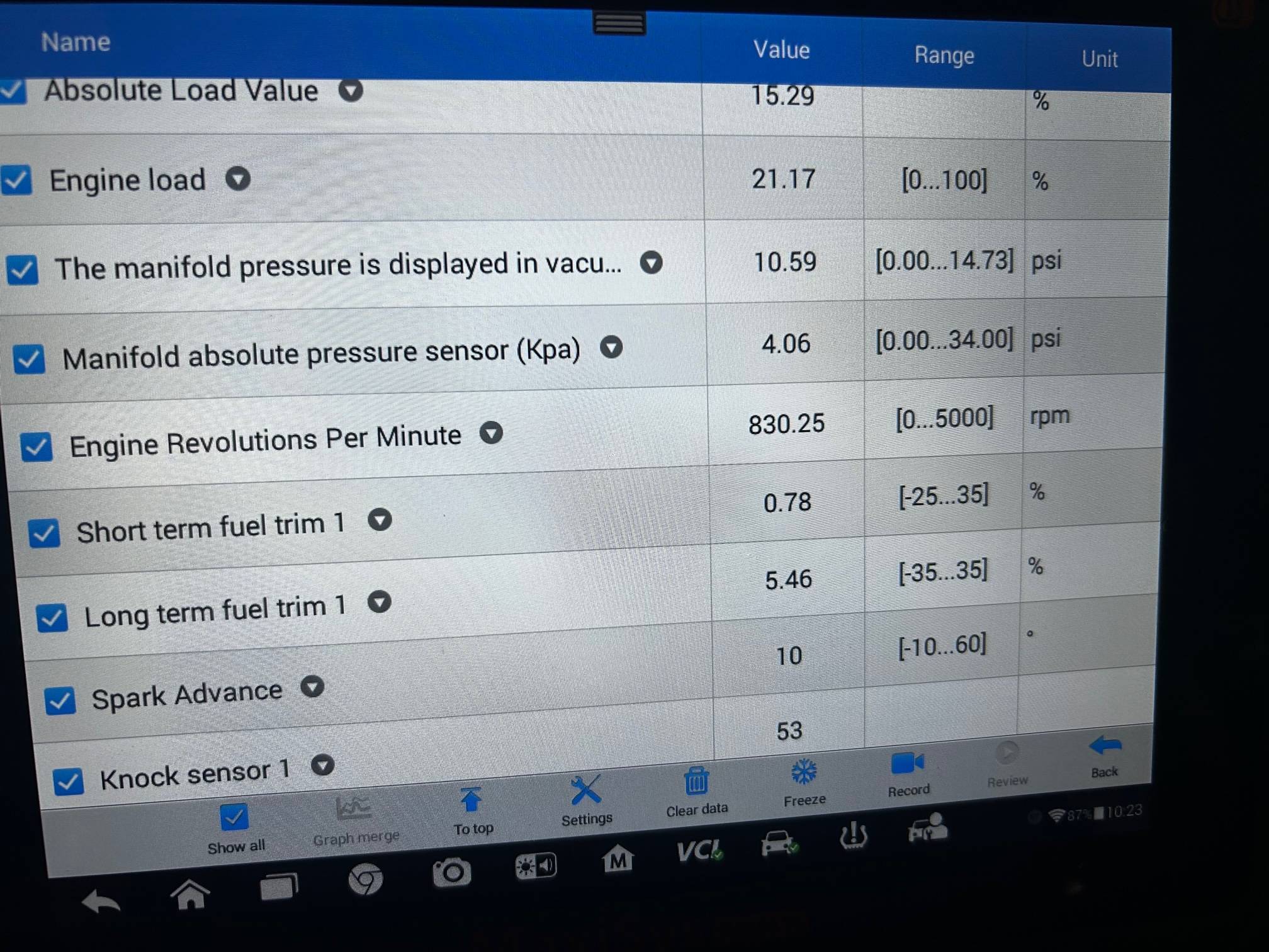

Well today the truck ran great. Ambient temp was 64 today, I'm still thinking this is temp based because of this? Did get some data though
Warm idle: just ran it 25 miles to work
This your data Warm idle
Hilly roads really make it impossible to get a good steady load reading
30mph
55mph

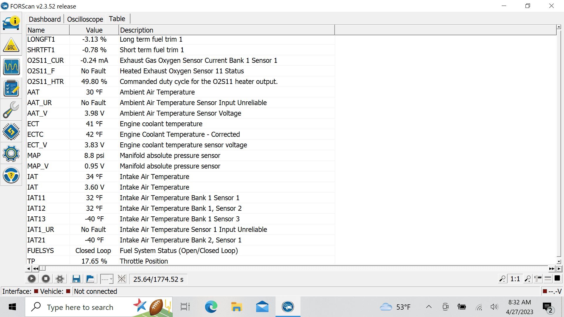

All looks good except 55 MPH and MAP is 10.0 PSI, a small difference from Spec of 13.9 PSI, noted but really matters. I am not sure yet.
So, if we back up to one of your other PID posts and look at the MAP of 8.8 PSI and Ambient Temps @ 30 Deg, by your TPS I see you are above idle but don't know RPM
So, being that another poster here has determined it to be based on Ambient Temps, then the most logical thing is the MAPT sensor, although reading correctly temp wise, may be reading MAP pressure wrong when colder temps.
Just a thought
All of the last posting of PIDs is what you want to monitor except add + Calculated Load
Calculated Load = Inputted data from various sensors including the TPS and MAP, ECT, RPM Etc.
The calculated load is what the PCM uses to control Spark.
So, it is still quite possible of a screwy MAP sensor reading.

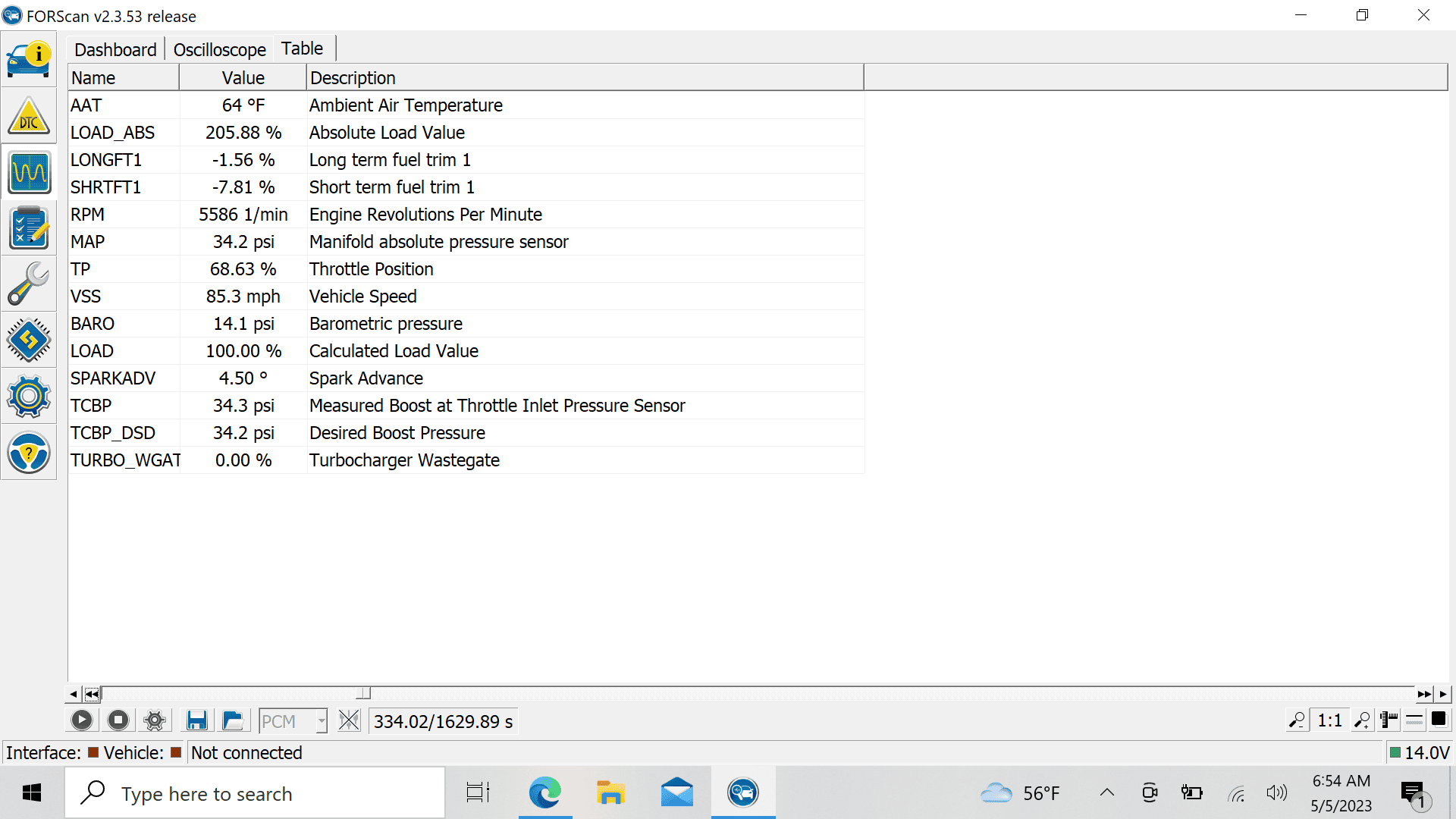

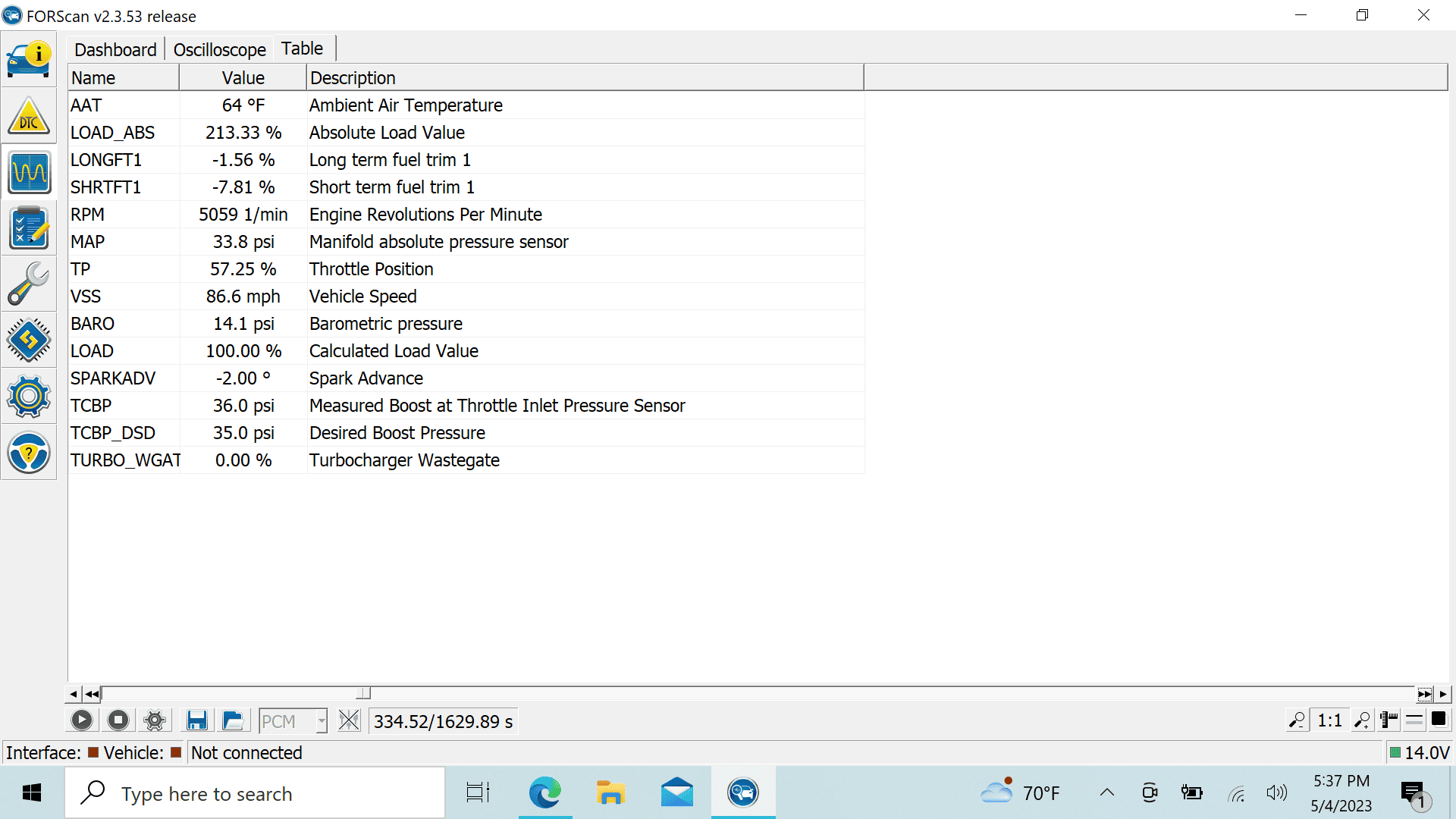

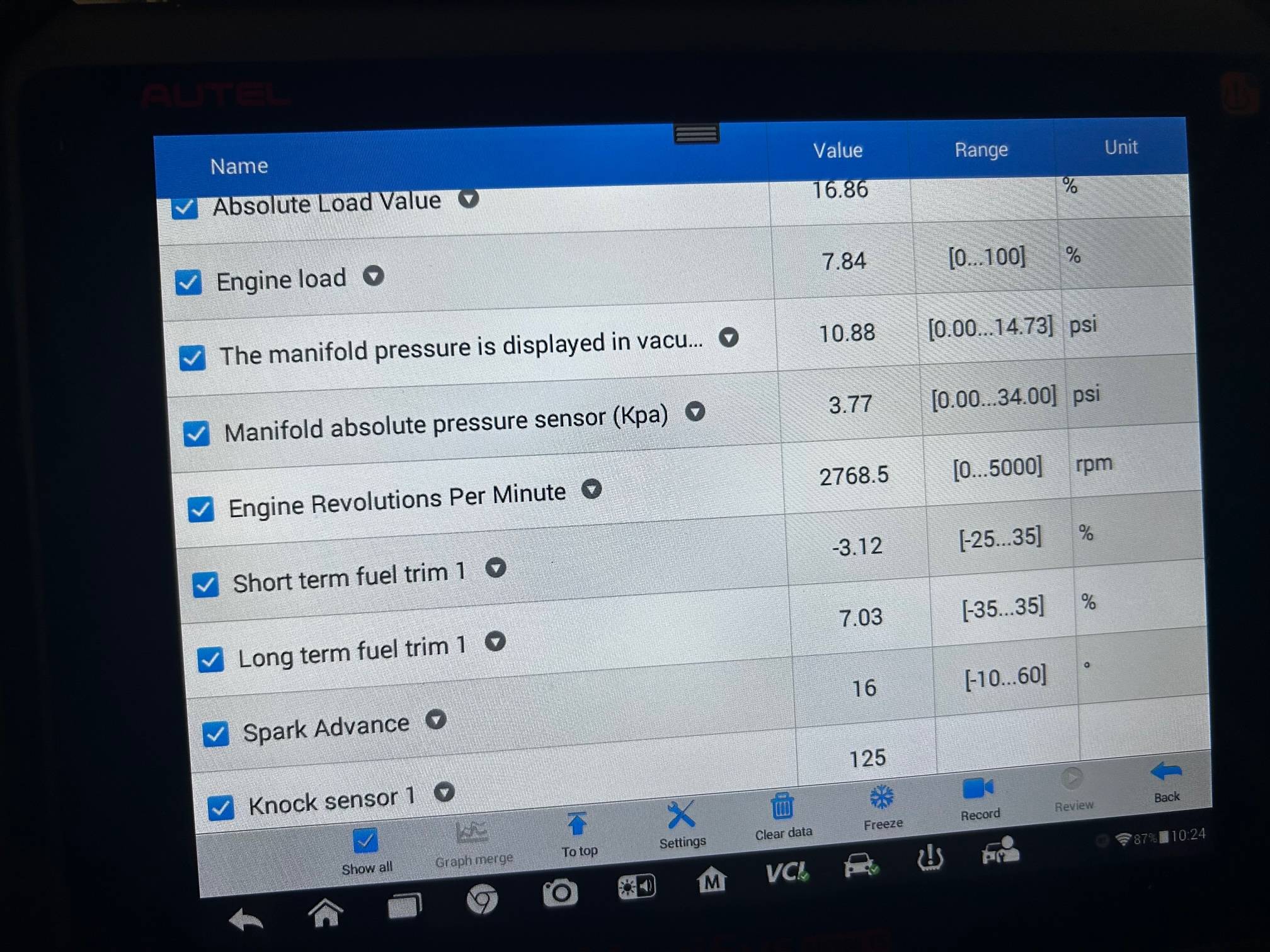

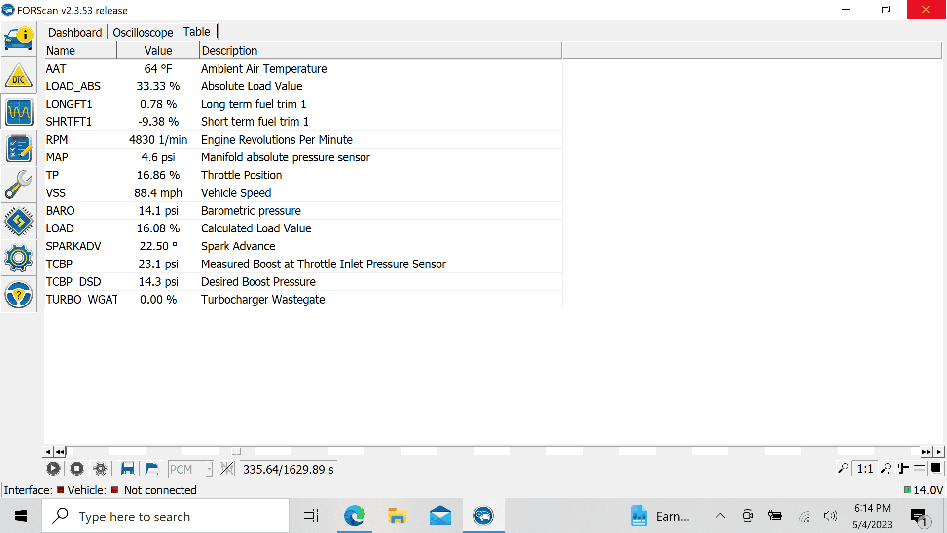

Did some more data logging and still everything looks normal. And today's screen shots.
KOEO
On my way to work yesterday I noticed the waste gate pid never moved so I decided to on the way home I was going to go 100% throttle to see if it report anything and it didn't. Don't know what is up with that, other than the truck responded beautifully when I did it.
So here are some screen shots of full throttle and decel.
Full throttle
MaxRPM
Max Load
Decel
I think I'm going to pull the plugs tomorrow and see if I can see anything with a bore scope I have. It's meant for the bore of my guns, so I don't know how the image will turn out.
Plus this will give me an excuse to put a little bit of anti seize on the threads since plug rust seems to be creeping up as an issue on here.
I did drop a can of seafoam in the tank yesterday so we'll see how that does?

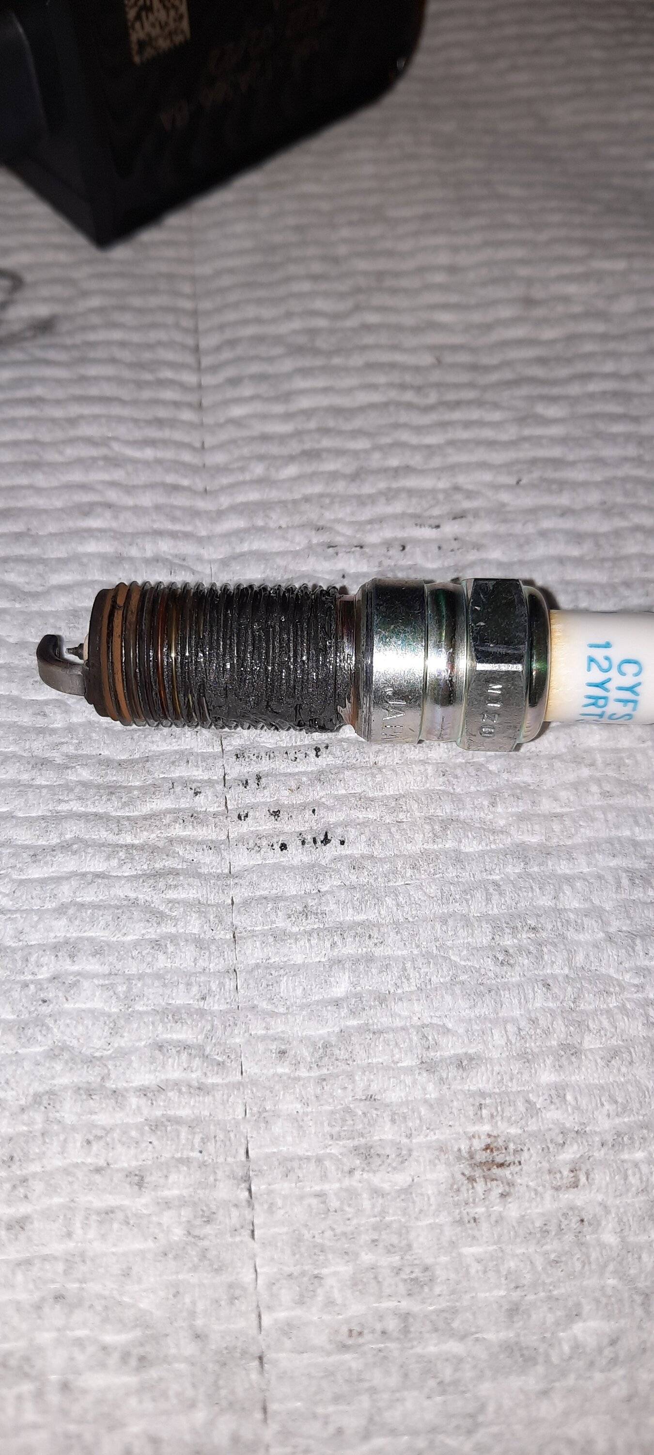

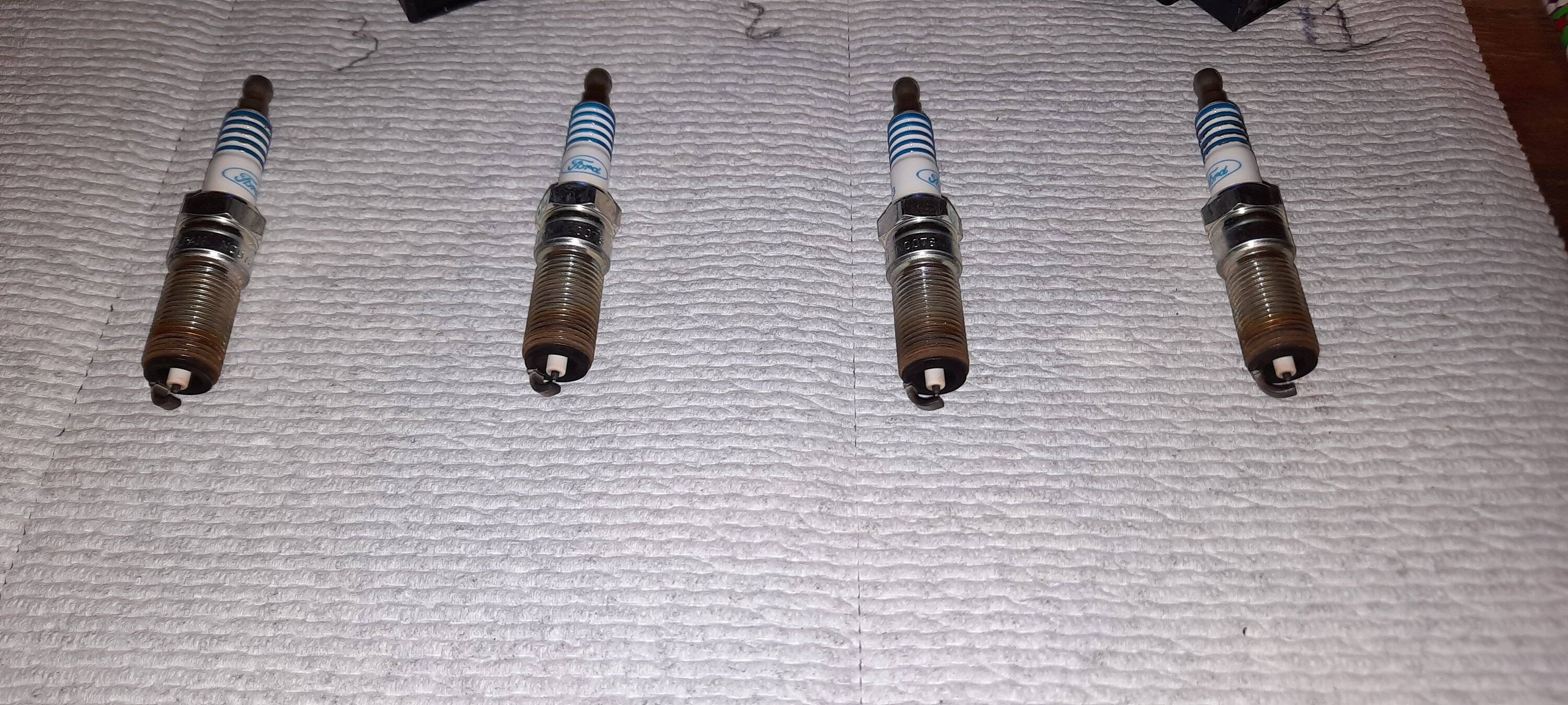

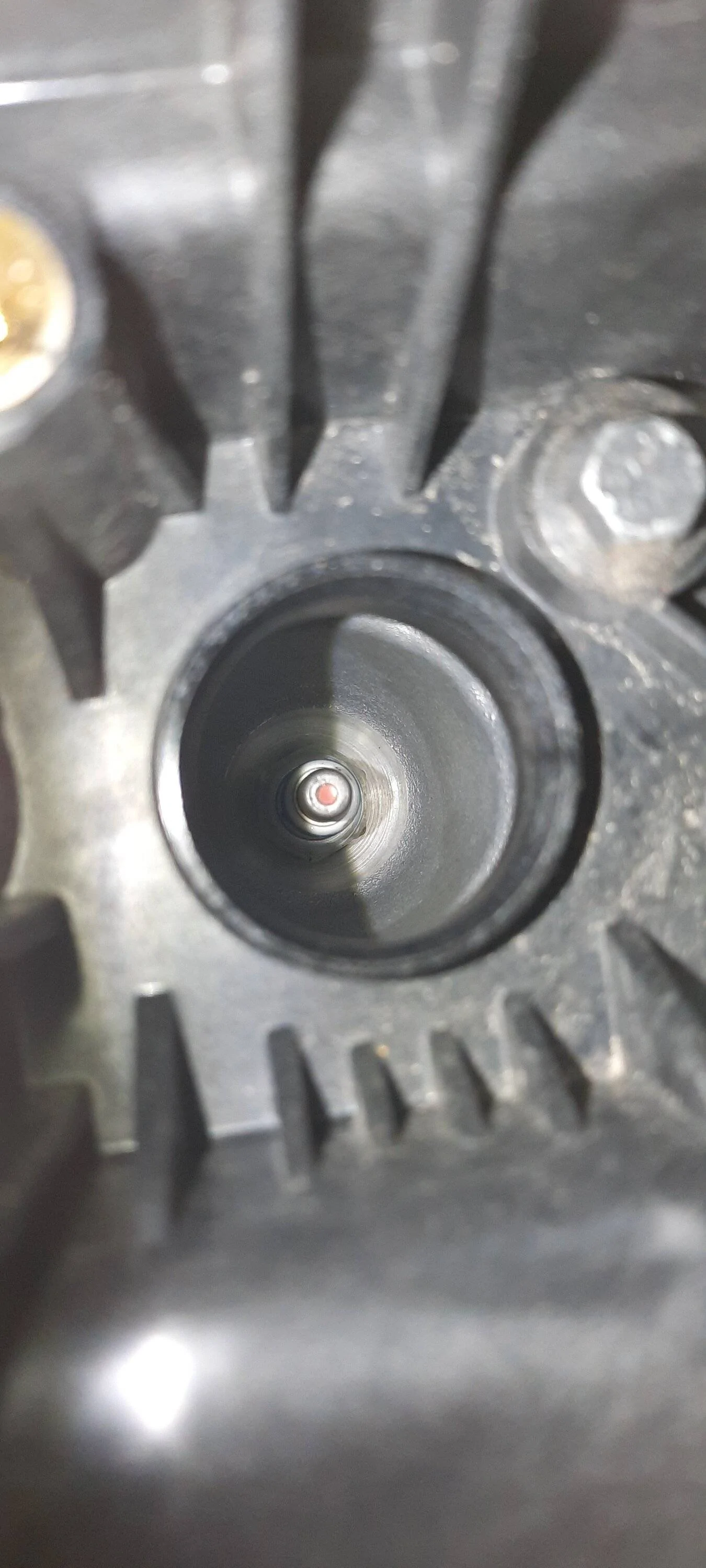

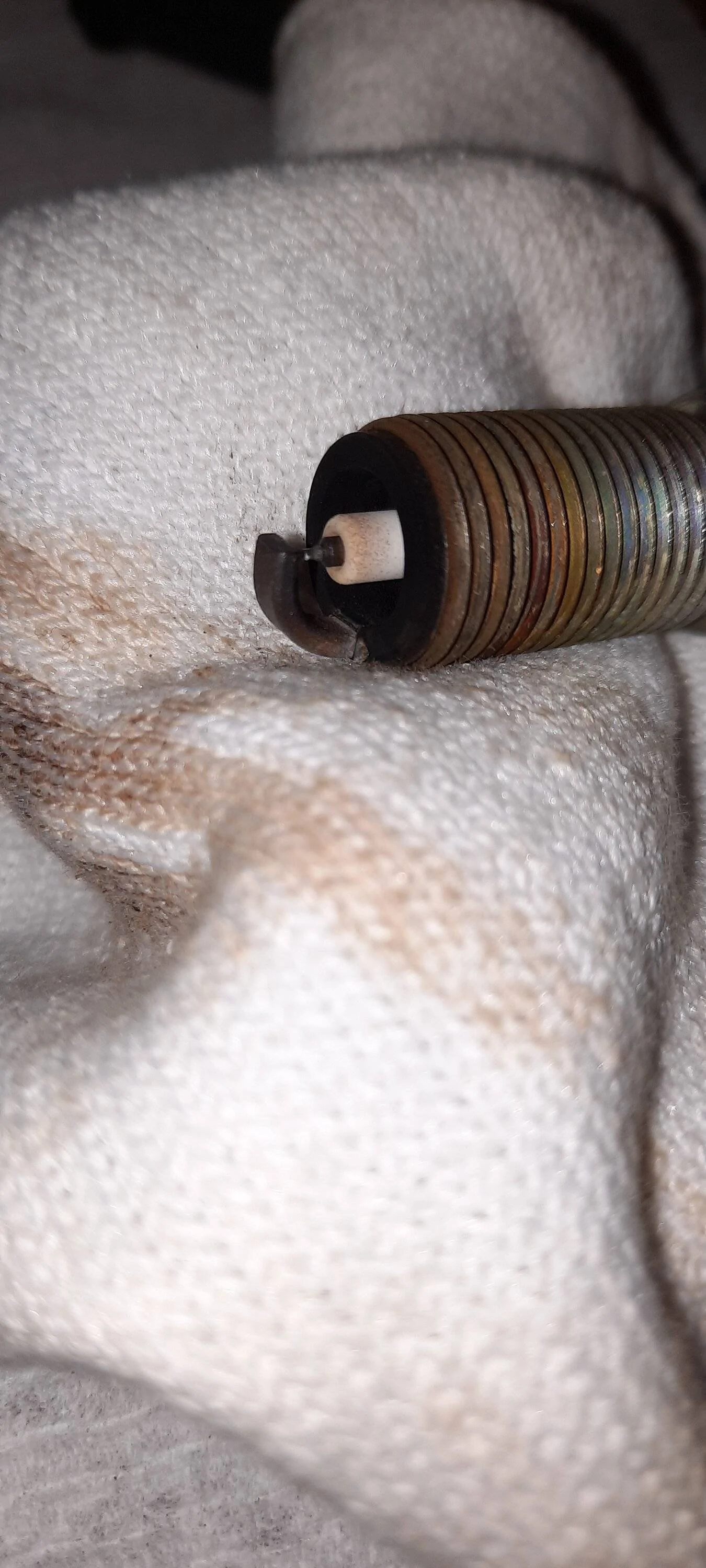

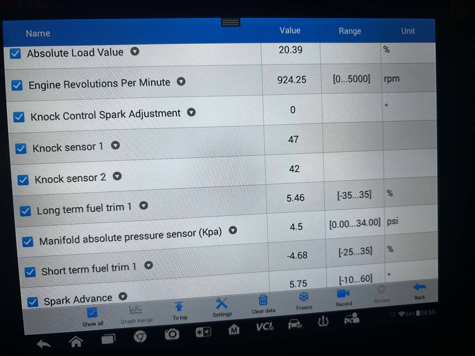

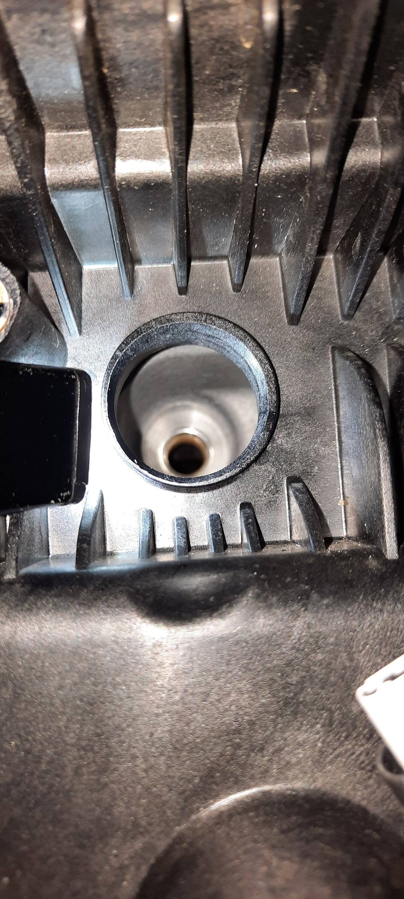

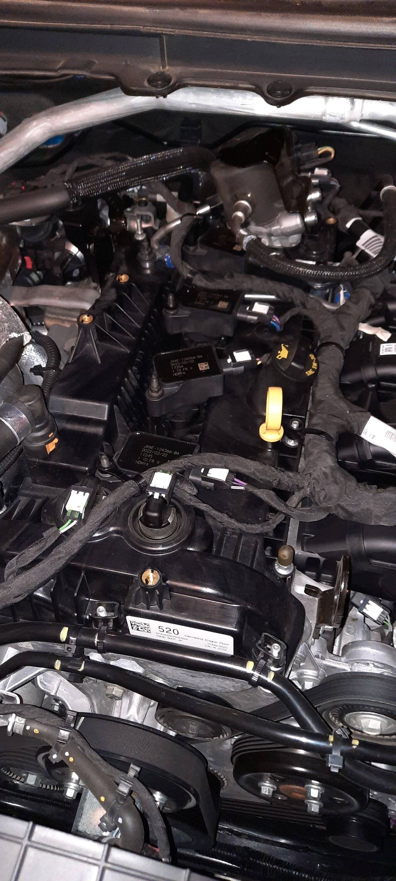

Ended up pulling the plugs tonight, good news is they look clean no rust. Bad new the bore scope was a bust.
This cylinder 1 almost think there is some tiny blistering on the tip of the porcelain?
And this is the one that showed a 2 count on the knock sensor
Just went with a skim coat or nickle anti seize.
And back to looking factory fresh
Well at this point I'm starting to run out of ideas on what to check. Going to give the seafoam a chance to do its thing, so I'll update the thread on how things are going.
Oh I did look at the waste gate operating rod when I started the truck and does cycle a few times so it must working and hear a hiss when it cycled.
