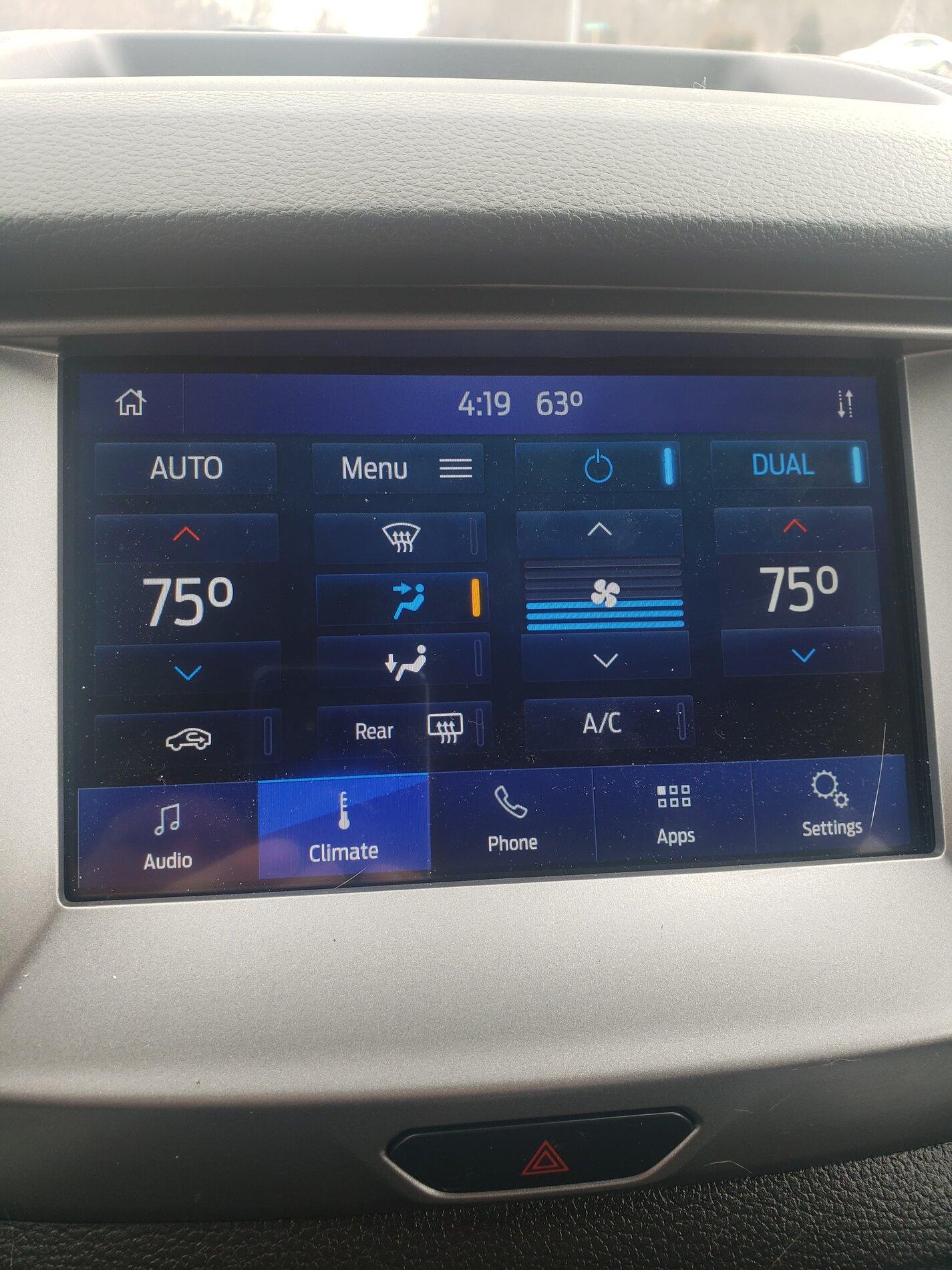

Yes sort of when I leave work it is set to 75 and not in auto with fan speed at 2 and it is just extremely hot. Now when I get home I just turn the truck off and leave the settings the same. So when I go back to work it is on the same settings and it blows cool air and the outside temp is 60 it is like it is switching to auto but it is not on
Next time you experience this click on the climate control button on the lcd screen and see if the vents are set to auto. They can be set to auto even if the auto button is not lit up and I have noticed that it takes longer for the cabin to heat or cool if this occurs. Press one of the blender door options and see if the warm air starts flowing.

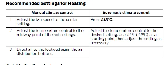

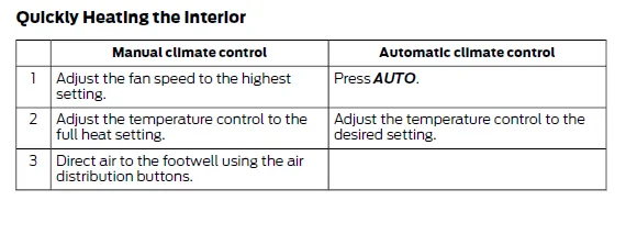

It may work erratically like you are describing if you have it in Recirculate mode. Once the cab is at a temperature either hot or cold that is comfortable, turn the Recirculate mode off.
BTW, the 2021 Owner's manual hasn't changed, at least as far as Climate Control is concerned..
Also, be sure that the cab temperature sensor is not blocked. It's on the lower right driver'ssise panel ahead of the ignition switch.
View attachment .jpeg copy.pdf

I am just talking about the temperature coming out of the vents. Is is 30 degrees outside when I leave work and I have my temperature set to 75 and fan speed on 3 with dual control pushed now on my way home from work it is blowing way hotter than 75 degrees. But when I come back to work is 60 degrees outside but my climate settings are the same as when I left work and it is blowing cool air not roasting air like it is in the am. I am just wondering why there is such a different temperature coming out in the am then there is in the evening. Here is a pic of my settings it it loads
