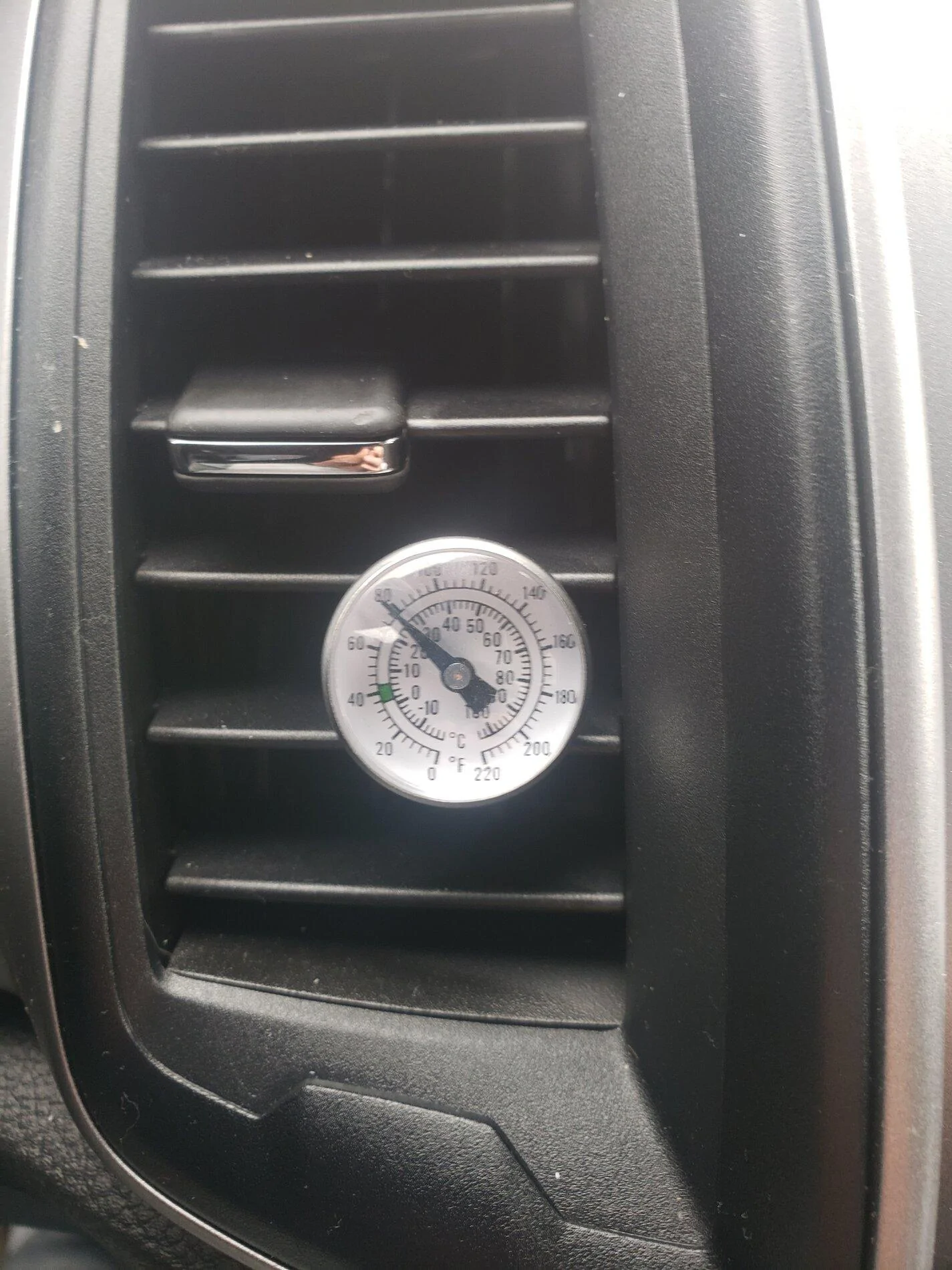

I am just talking about the temperature coming out of the vents. Is is 30 degrees outside when I leave work and I have my temperature set to 75 and fan speed on 3 with dual control pushed now on my way home from work it is blowing way hotter than 75 degrees. But when I come back to work is 60 degrees outside but my climate settings are the same as when I left work and it is blowing cool air not roasting air like it is in the am. I am just wondering why there is such a different temperature coming out in the am then there is in the evening. Here is a pic of my settings it it loads
And here is a picture of the temperature i am getting using a thermometer when going to work will get another temperature of it leaving work

I used a thermometer on mine on my way to work and it read about 78 out of all vents as the picture shows but will check mine again in the am when I leave work which is when it really asks up and see what it reads
