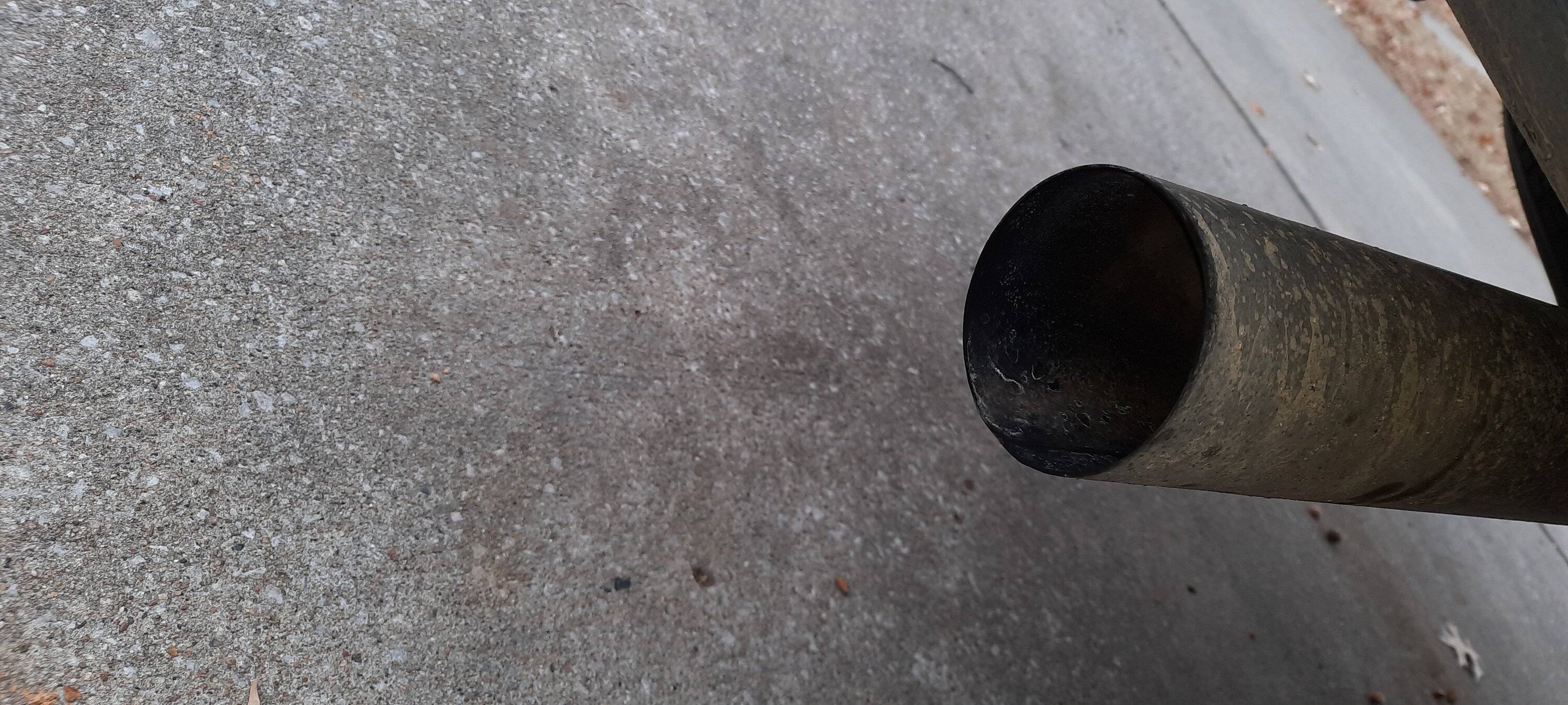

Did find a little soot in the tail pipe, don't know why I didn't check this earlier. But I think @Rp930 may have hit the nail on the head with the carbon build up in the cylinders. Don't think its doing this anymore or we would of seen it in the fuel trims. So my plan is to run a few tanks of cleaner through engine to clean things up and see if that does the job.
Like you guy's have said nothing is showing up in data and plugs are clean, so its programing or carbon in the cylinders.
@airline tech yeah its going to be interesting learning about all the new tech that is on these engines.
Thanks to both of you for helping, that's what I love about these forums :thumbsup:
The truck is not pinging for now, so either the temps are warm enough or the seafoam is having an effect.
We'll call this solved for now and if anything changes I'll update the thread.
