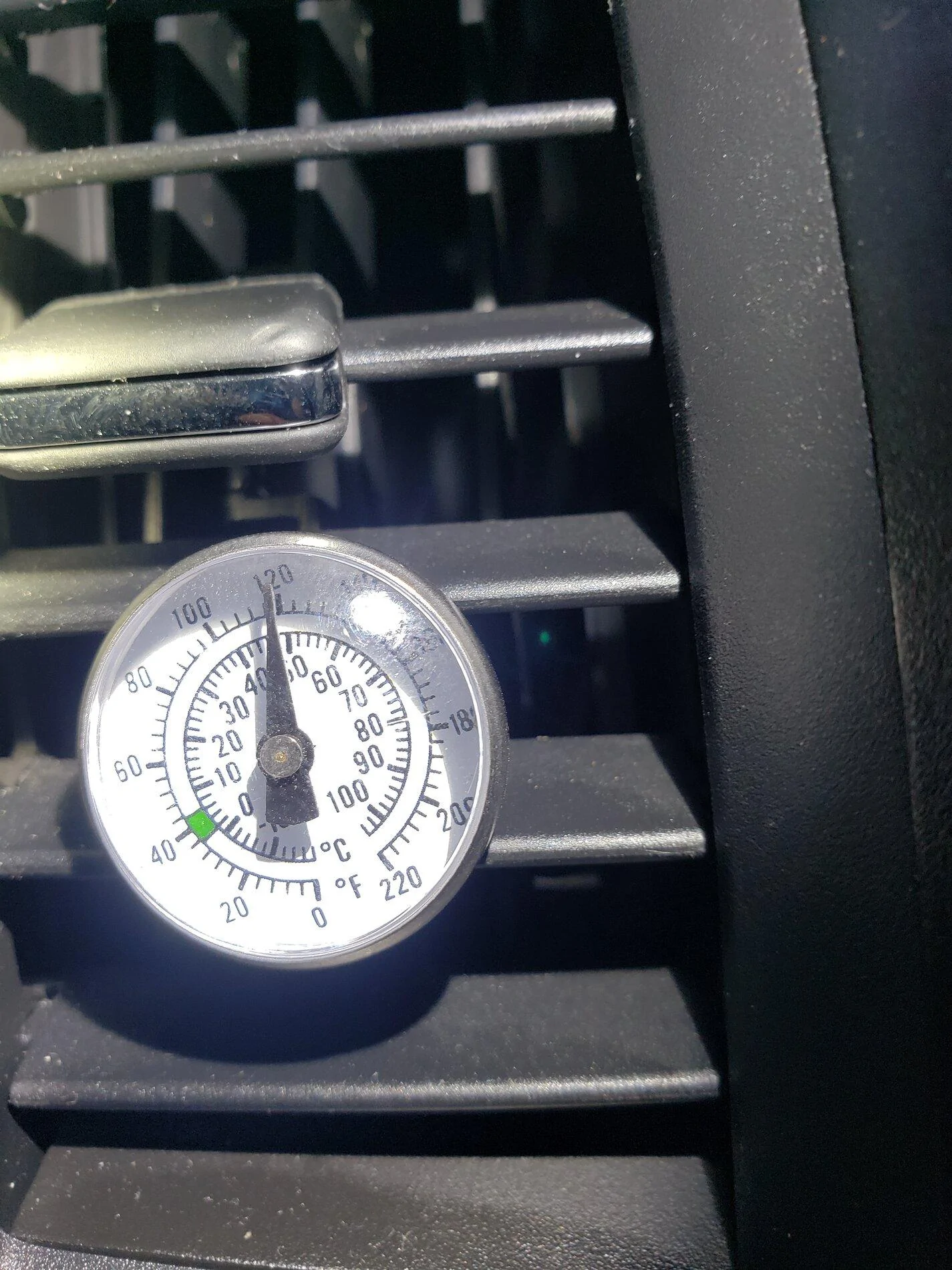

I used a thermometer on mine on my way to work and it read about 78 out of all vents as the picture shows but will check mine again in the am when I leave work which is when it really asks up and see what it reads
What was the temp on the way home?
I'm curious about this, even though I just use AUTO and let it micromanage everything for me. If in manual it shows a specific temperature, I would expect it to stop increasing or decreasing temperature once that number is reached. But maybe there's a bug and it shouldn't show a number, if it actually works like a cold/hot dial.

this is what it reads on the way home. The ford dealer told me that even though I do not have anything set to auto at all that my truck will still raise my temperature to max until the it reaches the temperature what I have it set to
Wildly inaccurate. You measured it right at the vent. You need to measure the ambient temp in the middle of the cab away from direct sunlight or near any vents.
That is not sunlight that is the flash from my phone at 6am in the morning and when I dropped it off at the ford dealer over night they checked it the next morning and got the same temperature
Oh I think I see what you're saying.
It makes sense to me that it will blast hot air like that because you're not setting the temperature of the air coming out of the vents, you're setting the temperature of the cabin. It gets the cabin to temperature by blowing air that's hotter than the desired temperature until the cabin has reached the desired temperature, just like a furnace in a house. In AUTO the fan speed slows down and the temperature of the air coming out of the vents will lower as the desired cabin temperature is reached. In manual it will just keep blowing at whatever speed you set it to in whatever direction you set it to, until the desired cabin temperature is reached, then it will back off on the temperature.
If you have it set to blow quickly and out the upper vents then I can only imagine that it's not super comfortable. AUTO will set heat to come out of the floor vents because heat rises. It'll also defog and defrost if it needs to. It doesn't blow hot air out of the upper vents because that's less effective and less comfortable. Similarly when it's hot out, the AC will blow from the top instead of the floor, because cool air drops.
