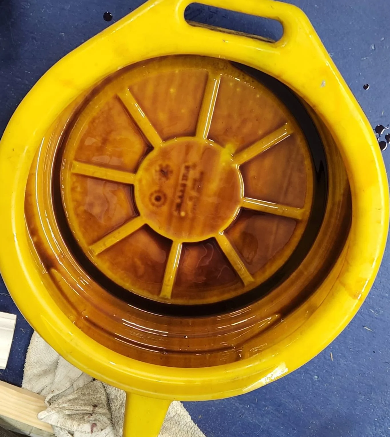

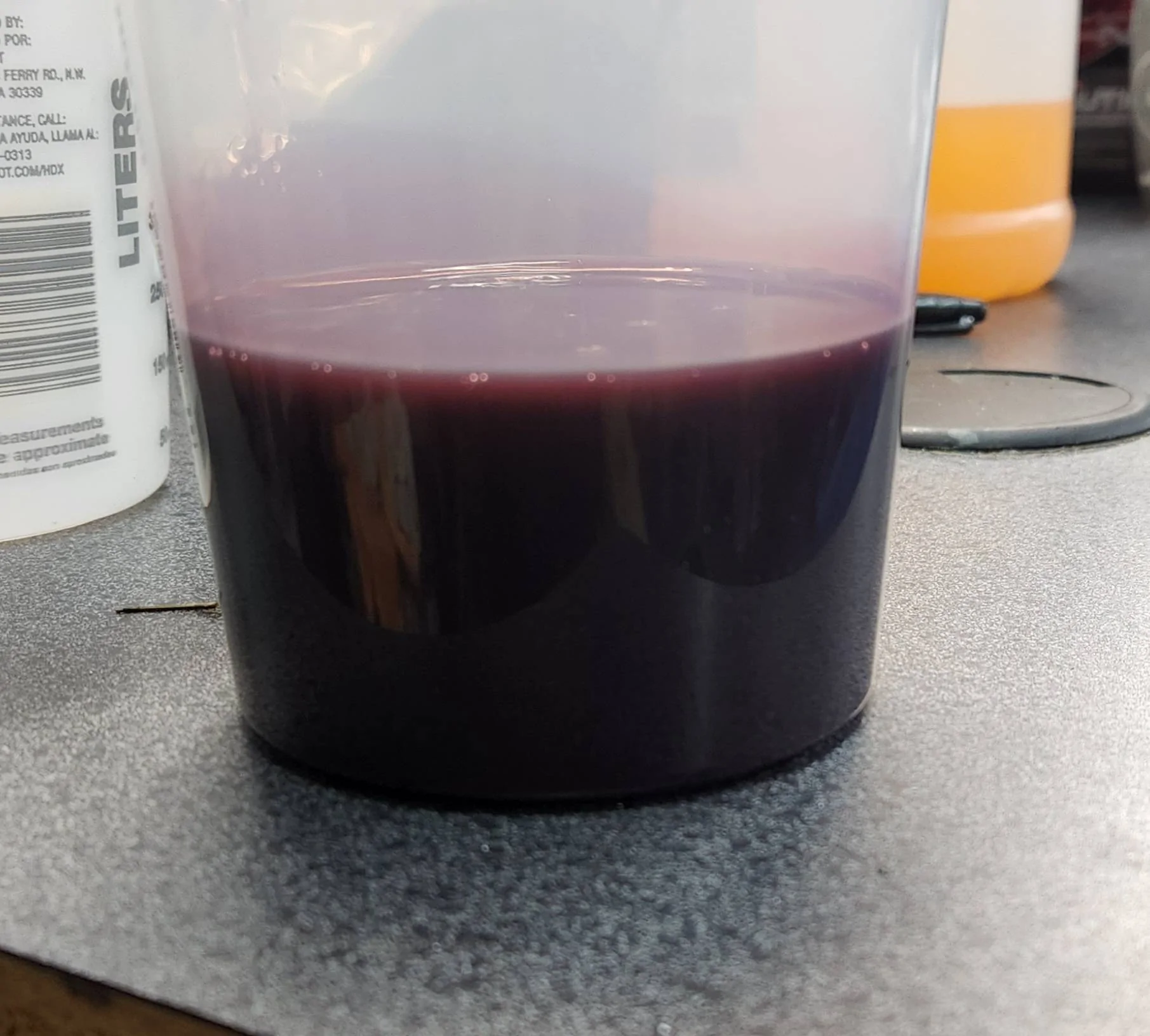

38,500 mile on truck and just got done doing all 3 , rear axle was bad black with a lot of build up on drain plug,
front little dirty not bad
transfer case bad ...... fluid black /drain plug dirty
pictures of the transfer case below
Used Red Line oil D6ATF 2 q on transfer case
Red Line gear oil 75/90 2 q rear 1 q front
below

My experience was the same. Changed at 30k. Rear and t-case looked like tar, front not quite as bad.
Previous truck i changed the t-case and rear every 30k. The front had to by done by the qwicky lube with a pump, so every 50k. At 30k and 60k they drained out dirty, by 90k there was some pink, by 120k the lube in both looked like new. Less wear as things break in. Based on that, I plan to change the axles and t-case at 30k (done), 60k, 100k, then every 50k after assuming I keep it that long.
I used Redline D6 and axle lube also, it's the only synthetic axle lube I found that specifically meets the Ford spec in the owner's manual. Owner's manual calls for 80w-90 conventional lube.
Also I found that while the fill plugs and drain plugs are the same size, only the drain plugs have a magnet so make sure you put them back in the right place.
