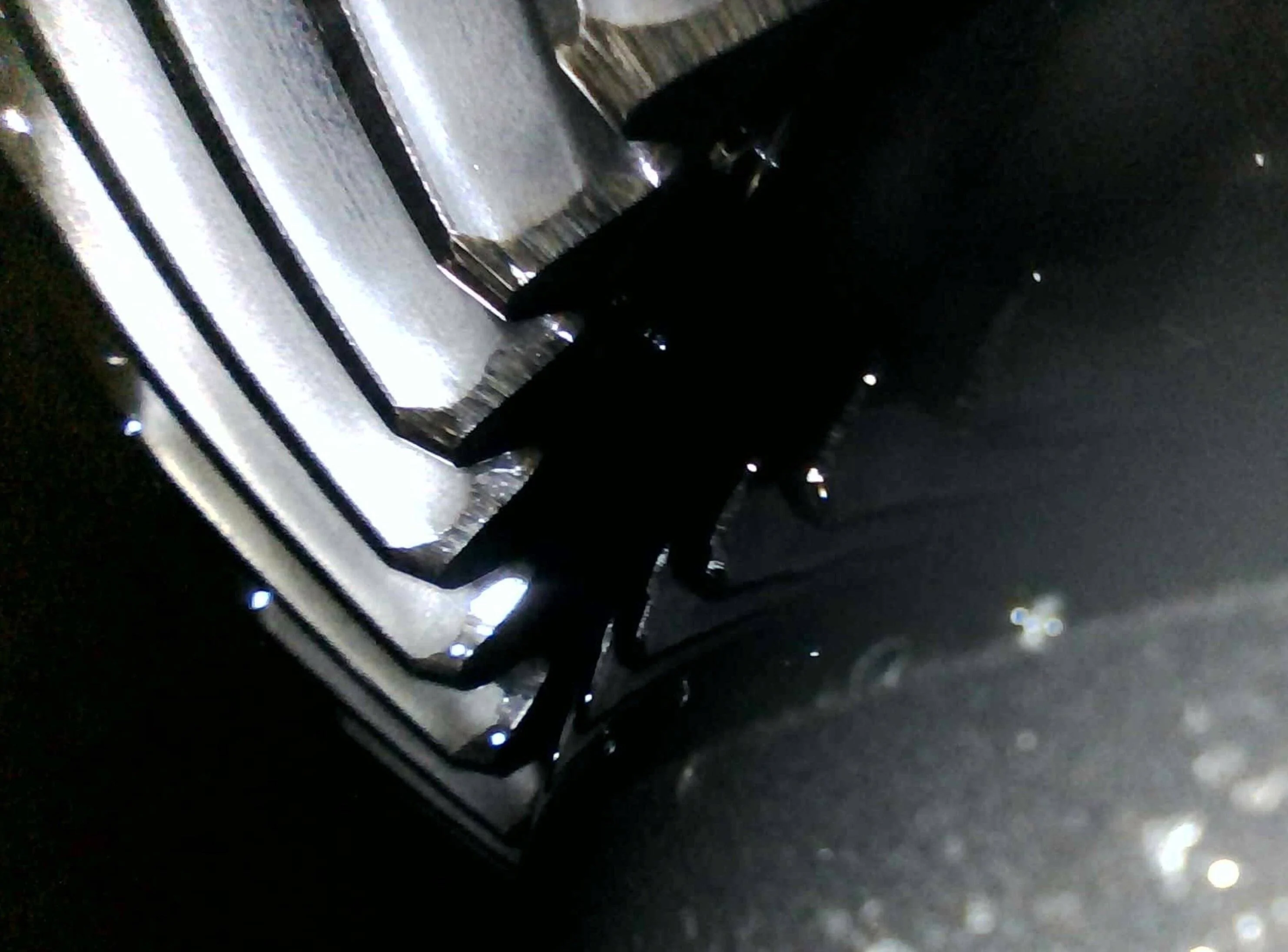

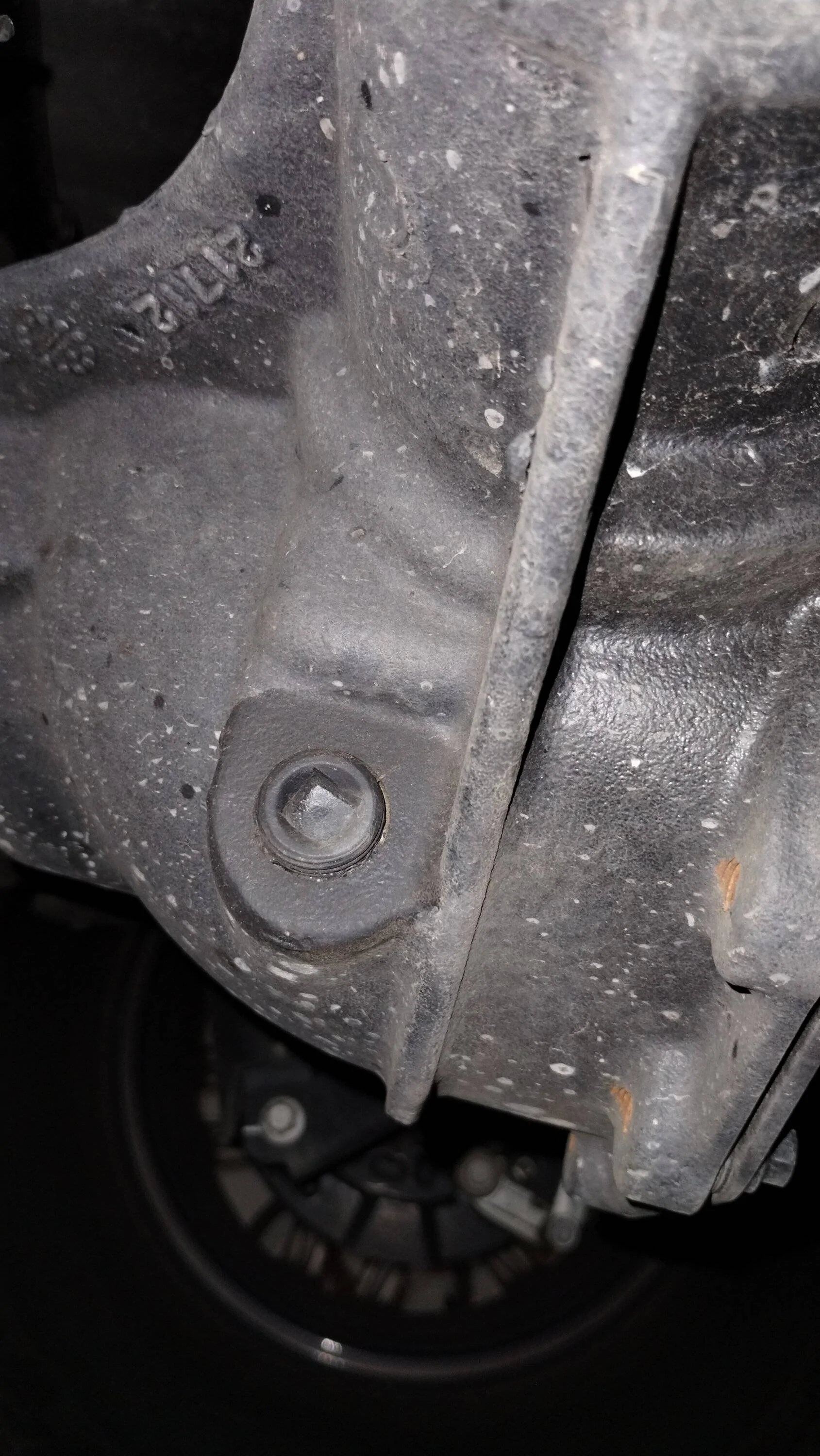

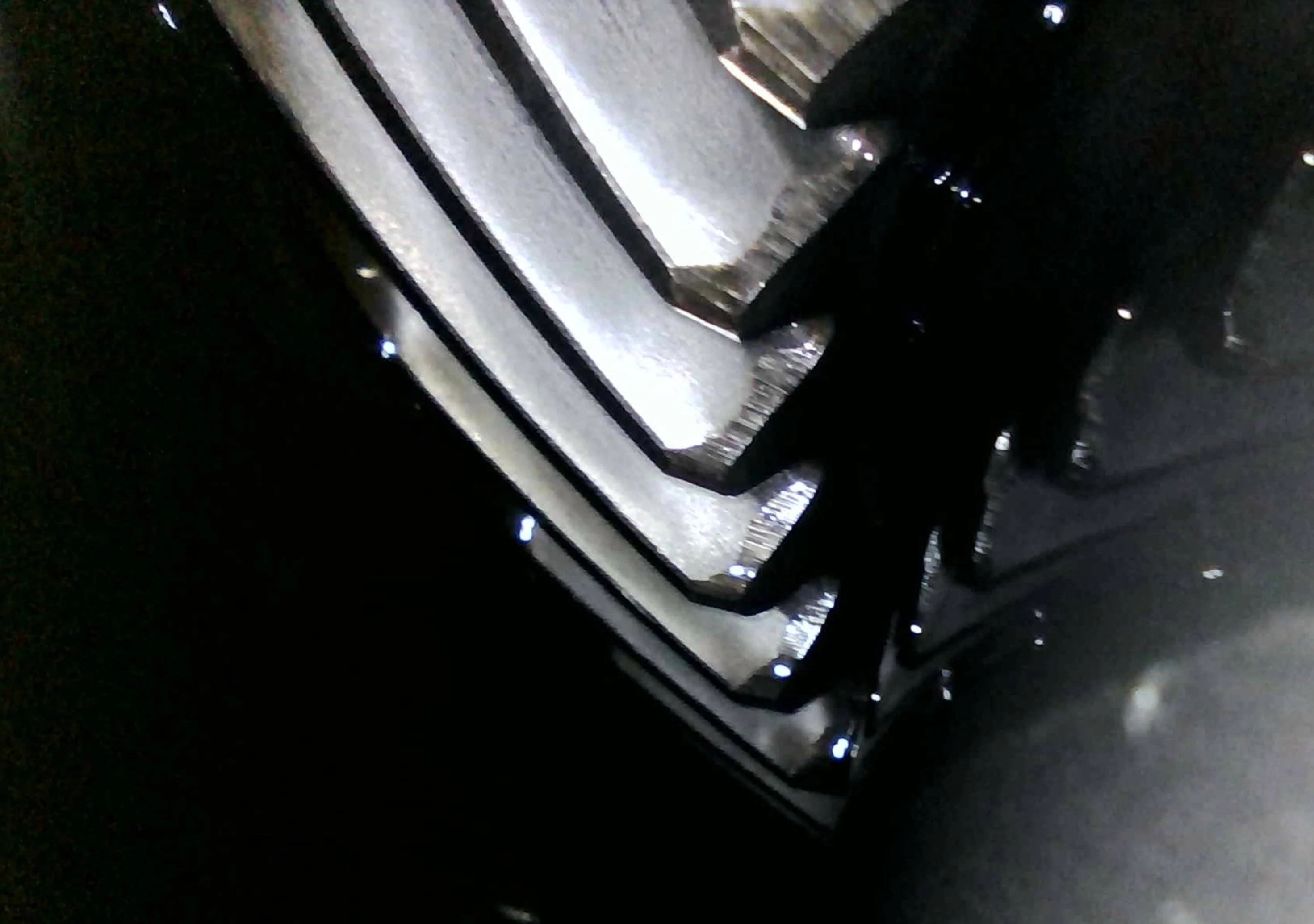

Rolled over 30K miles last week, and as part of the maintenance for that milestone I drained and filled my rear diff. The fluid that came out was a dark amber color, with only very little (very fine - almost like a mud) deposits on the drain plug magnet. While I had the drain plug removed, I used my borescope to peek inside the diff. I think the gears look great. I should have thought to scope in through the fill hole as well, but was in a time crunch and was lucky to think about any borescope shots at all.
