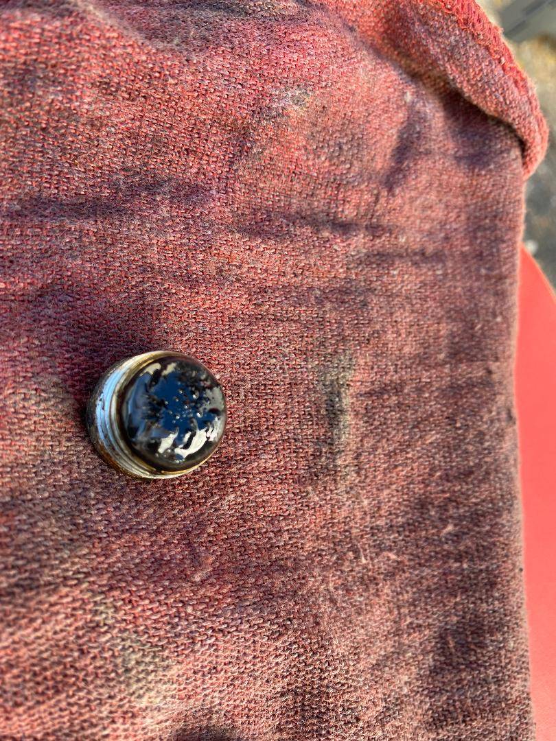

I changed my rear diff fluid today. I went with Harvest King 80w90 synthetic gear oil. The oil was dirty an the magnet on the drain plug was covered in metal paste. Lowering the spare would have made access to put the lube bottle into the drain hole but I just put some plastic tubing on the spout an squeezed away. I have 24K on the ranger now. I didn't do the front or transfer case since I've only use four wheel drive a handful of times for probably less than 10 miles.
Do your front transfer case. It's easy, everything in there is always spinning and since it's not a lot of fluid it should be changed pretty often.
