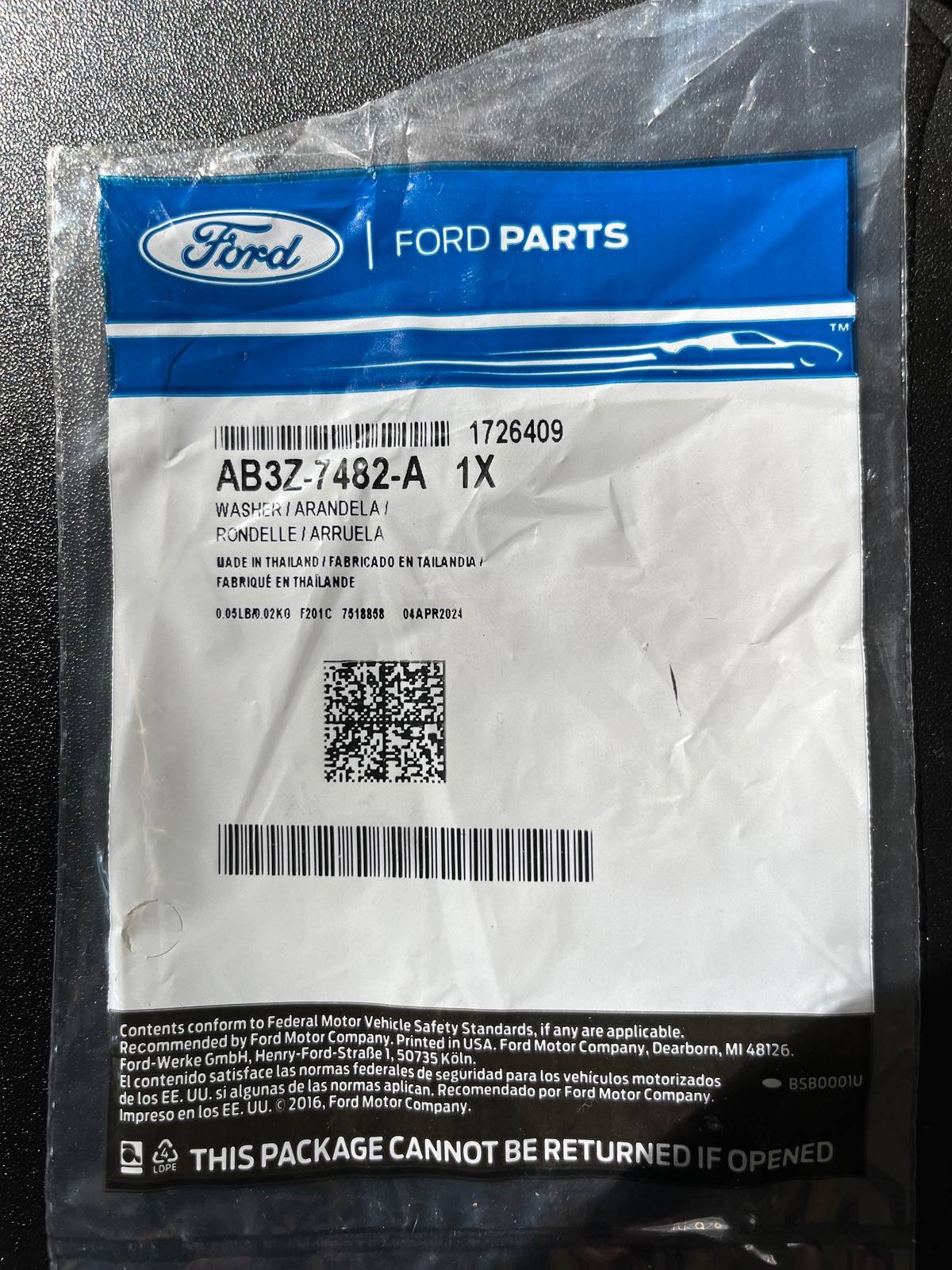

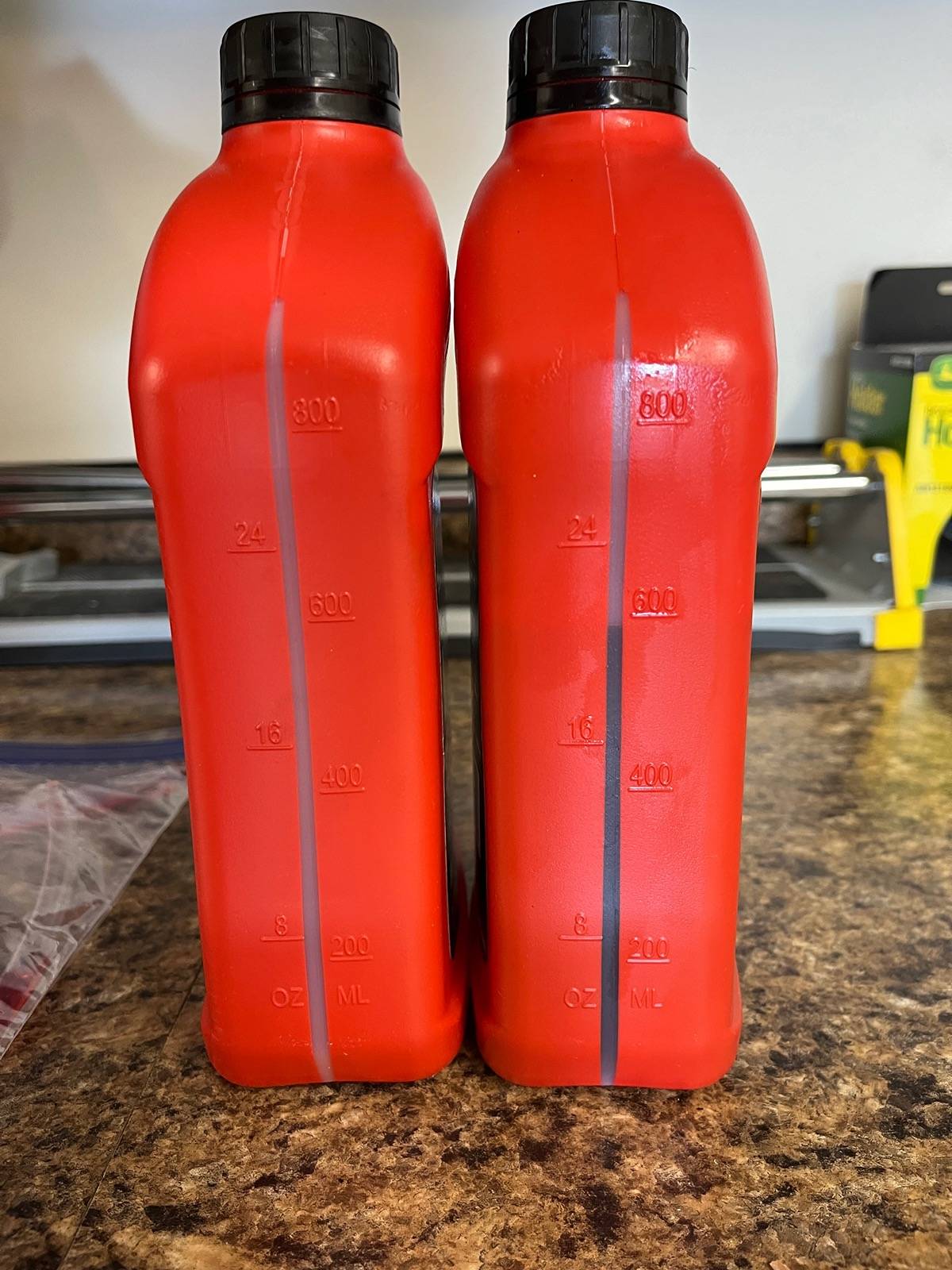

I just changed the transfer case fluid on my 2021 Ford Ranger XLT 4x4. 55,390 miles. The drain and fill bolts required a 10 mm hex head/Allen socket to remove. Both bolts were easy to remove without any issues, and yes - I started by removing the fill bolt first in the event the drain bolt would not loosen. I live in Minnesota, where our roads are heavily salted in the winter, but no signs of corrosion on either bolt. The fluid was dark, as expected, but no signs of any problems - did not smell burned, no visible chunks of metal or debris in the fluid, and nothing out of the ordinary on the drain bolt magnet. I did purchase new crush washers and they were around $13 each. Not trying to start a debate on whether they should be changed or not - it was my choice, and $26 isn’t going to break my bank account. I’ve owned a few Honda vehicles and they always had crush washers for drain plug washers, so it’s something I replace out of habit and good practice. I used Ford Motorcraft Mercon LV Automatic Transmission Fluid (Not Motorcraft ULV Transmission Fluid, which is used for the automatic transmission). Check your Owner's Manual because there is a difference! (Not trying to start a debate on which brand transmission fluid is the best to use . . . I use OEM and have never had an issue). Both bolts were torqued to 18 ft.-lbs. Purchase two quarts of transmission fluid. The Owner's Manual calls for 1.2 liters. I used one quart, plus approximately 10 ounces, and at that point, fluid started to slowly trickle out of the filler hole. I used a hand pump and it took about 10 minutes of my time to pump fluid back into the transfer case.
Crush washer/seal part number - Ford: AB3Z-7482-A.

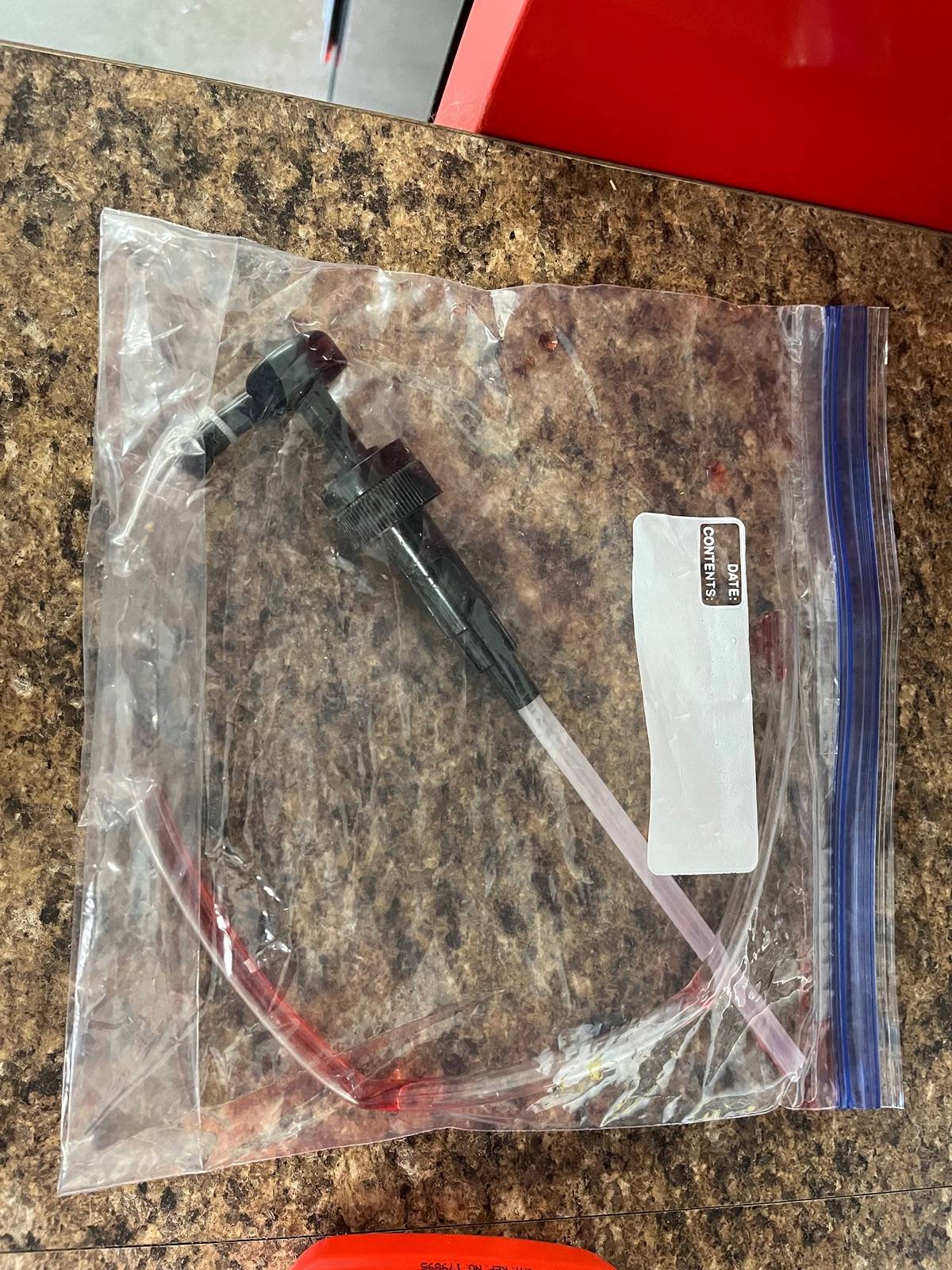

Make sure you have a pump ready to put the fluid in. A funnel won’t cut it 🤣
True that! I used a repurposed garden sprayer (a little 1 litre one) remove the jet and put on a pvc tube. Put the oil in and pump it up! Works a treat.
Similar to this:
