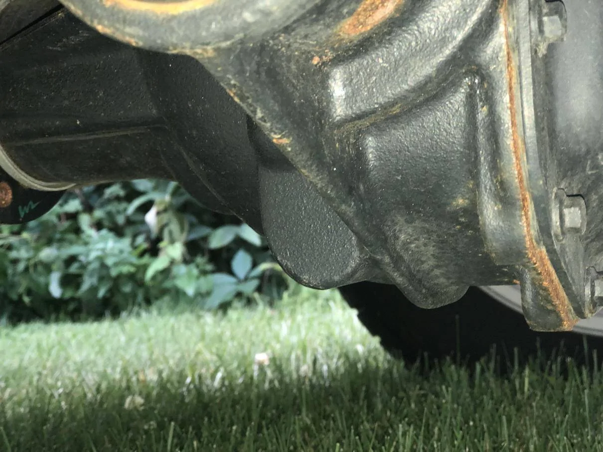

I wouldn't say "all". At some point in the 2021 model year they phased out the drain plugs.
It took me a while to get under my truck. I'm sore from remodeling the garage.
Anyway, you're right! I have no drain plug. I think I was confusing my buddies '21 with mine, and he does have a drain plug. I blame 'oldtimers' disease.
A few weeks ago we spent a lot of time changing shocks and such, and scoping out the one and only rear anti-sway bar available. We both decided to skip that mod.
Anyway, mine has the right spot for a drain, but it looks like someone forgot to drill and tap a hole. I'd like to try that, but I don't think I'm brave enough to try it. Plus, I have no taps anywhere near that size.

They didn't forget to drill and tap a hole. They just stopped doing it to save a few bucks. Some 21's have drain plugs and some don't.
Your choices:
1. Do it the old fashioned way, get a new diff cover gasket and hope it doesn't leak.
2. Take it to the Valvoline Quicky Lube where they suck it out through the fill plug with a pump. $79 versus the time it takes to do it yourself is worth it.
3. Get the Ford Performance diff cover for a Bronco, which I'm told has a drain plug. Their unit for the Ranger apparently does not.
