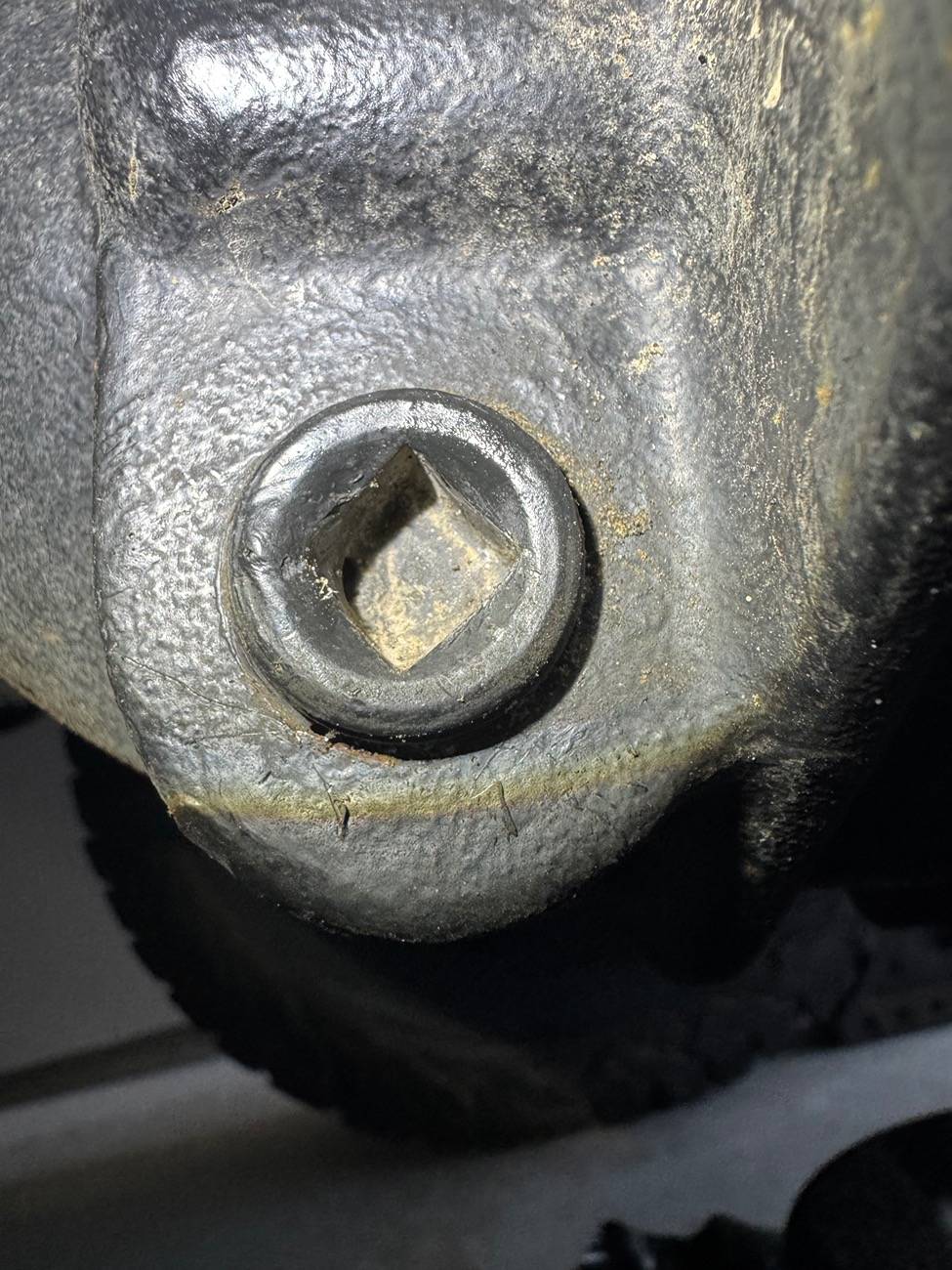

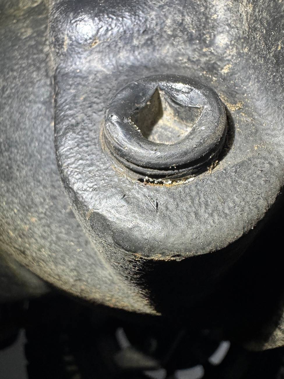

Question for the people here with more knowledge than me. Changing all the fluids and thought I was lucky with a rear differential drain plug. It is sort of deformed upper left corner 9 a clock in photo. So 3/8 ratchet does not fit in it. Also seems to have some type of sealant around it almost like it is welded in. Do not want to force it and cause more problems. Might just have to remove the cover?
Almost looks like you got a bunch of paint dried in that corner of the socket. I would try scraping it out. Then once you get it out replace the plug. Just go to your local hardware store and get a new pipe plug, that's all it is.
Correction! My bad that is the drain plug, it has a magnet in it. Maybe an auto parts store might have one. Or. Clean up the old one.

Just order a new one to replace it. They don’t cost very much. It’s thread sealant not glue. It’s only in there with maybe 20 ft lbs. it comes out very easily.

When you did the transfer case, did you replace the crush washer? I’m about to do mine so just curious.
I did not fill it yet was debating on getting one at the dealer tomorrow. First change washer still seems good. As was mentioned earlier they are not torqued on very tight.
