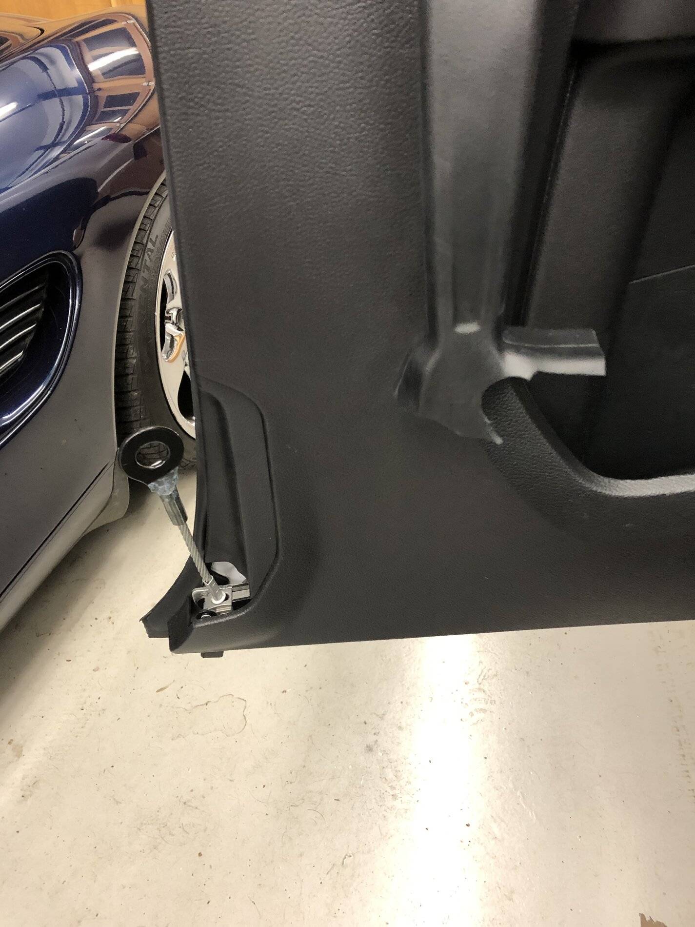

I have this exact issue on my 2020 build date 9/20, over a year after the recall date. Maybe somebody found some defective seat belts lying around and didn’t want them to go to waste? The webbing needs to go thru the eye, instead it was just held in place for a while by the plastic housing

I submitted the info with the NHTSA sorta just to see what would happen and I go a call in two days. The guy is concerned since it appears that this safety defect apparently wasn't corrected. Now I have no idea if I'm the only one with a defective seatbelt, but I do know that if I had a SCab I would go yank on the passenger seatbelt and see if it comes out, since if you don't carry a lot of passengers you would have no way to know by looking at it if you had this defect. I don't know if it's done on this board but I think if a mod can highlight that it might be useful.
As a side note the dealer says the new belt will arrive in 4 days which is pretty good if it happens.

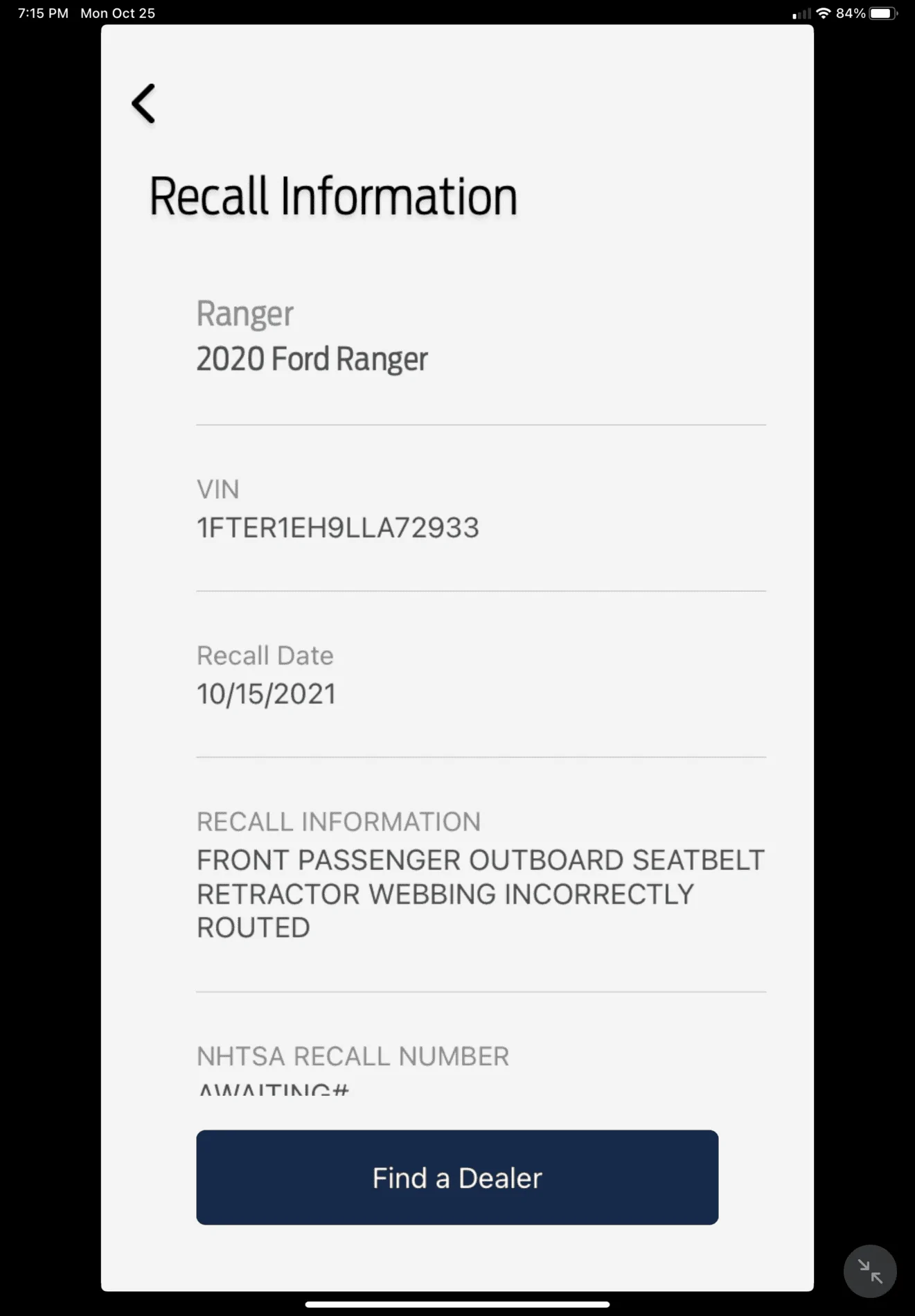

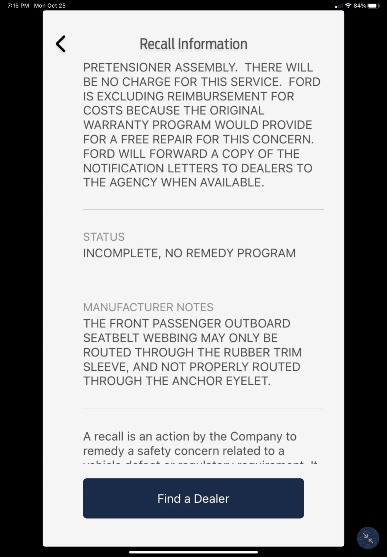

Just got this notice in FordPass. Looks like any passengers are going to have to suck it in and hop in the back until this is fixed...
