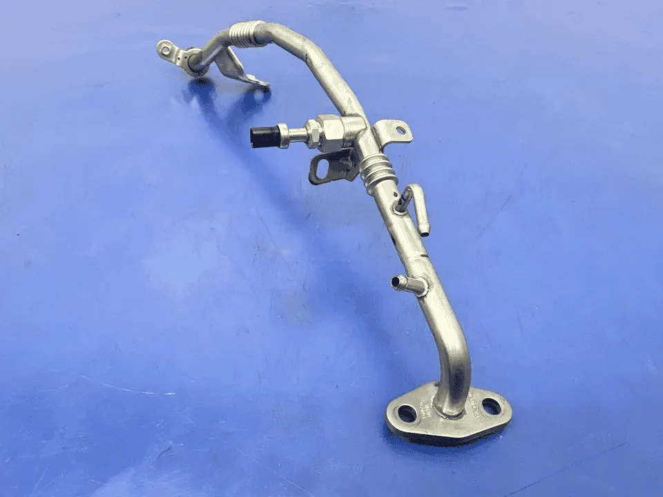

The problem I am seeing here is one people replacing only the sensor and not the tube. It may or may not be part of the problem. If the ports get clogged the it will cause problems. I'm telling you what fixed my truck and several other Rangers I have worked on and I also only use Ford parts, which yes are expensive I paid over $200 for all of my stuff.
Question for you on replacing the tube. (Assuming you mean the metal tube the DPFE sensor connects to and not the rubber hoses between the sensor and the metal tube.) Ford service manual says to remove the EGR valve and cooler to access the tube. Did you have to remove those components or was there enough room to get the tube out by itself? I'd rather not take off the other parts if I don't have to, but sometimes it's easier that way

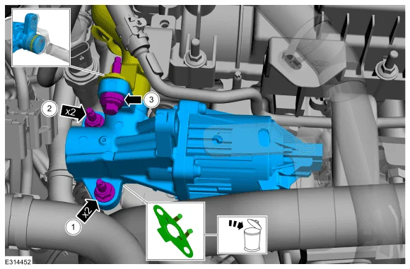

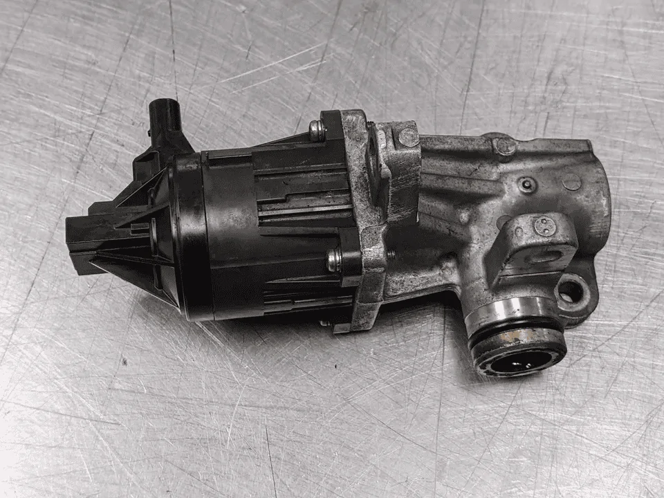

No, the EGR Valve connection is right on top, just (1) bolt (item #3)
The O-Ring (visible) is the EGR Tube connection at the valve
Looks like 3 bracket support bolts, 1 bolt for the EGR Valve connection and 2 bolts for the intake connection.
EGR Connection (O-Ring)
Intake Connection (Gasket-Between the Tube Flange) + O-Ring Between the Intake Flange and Intake Port) - (If needed) (Unsure if that flange connection will be free floating) after disconnection of the tube assembly.
Disconnect both (Rubber Hoses) - Clamps
Remove connector from the ERGT, remove the EGRT and inspect / clean the sensor, the IPC shows a O-Ring seal on the sensor but no Part Number for it, so it most likely will only come with a new sensor. (Inspect - O-Ring for any damage) flattened or cut / nicks etc.
If damaged it may take some digging to find a replacement (equivalent) high heat from a auto-parts store.

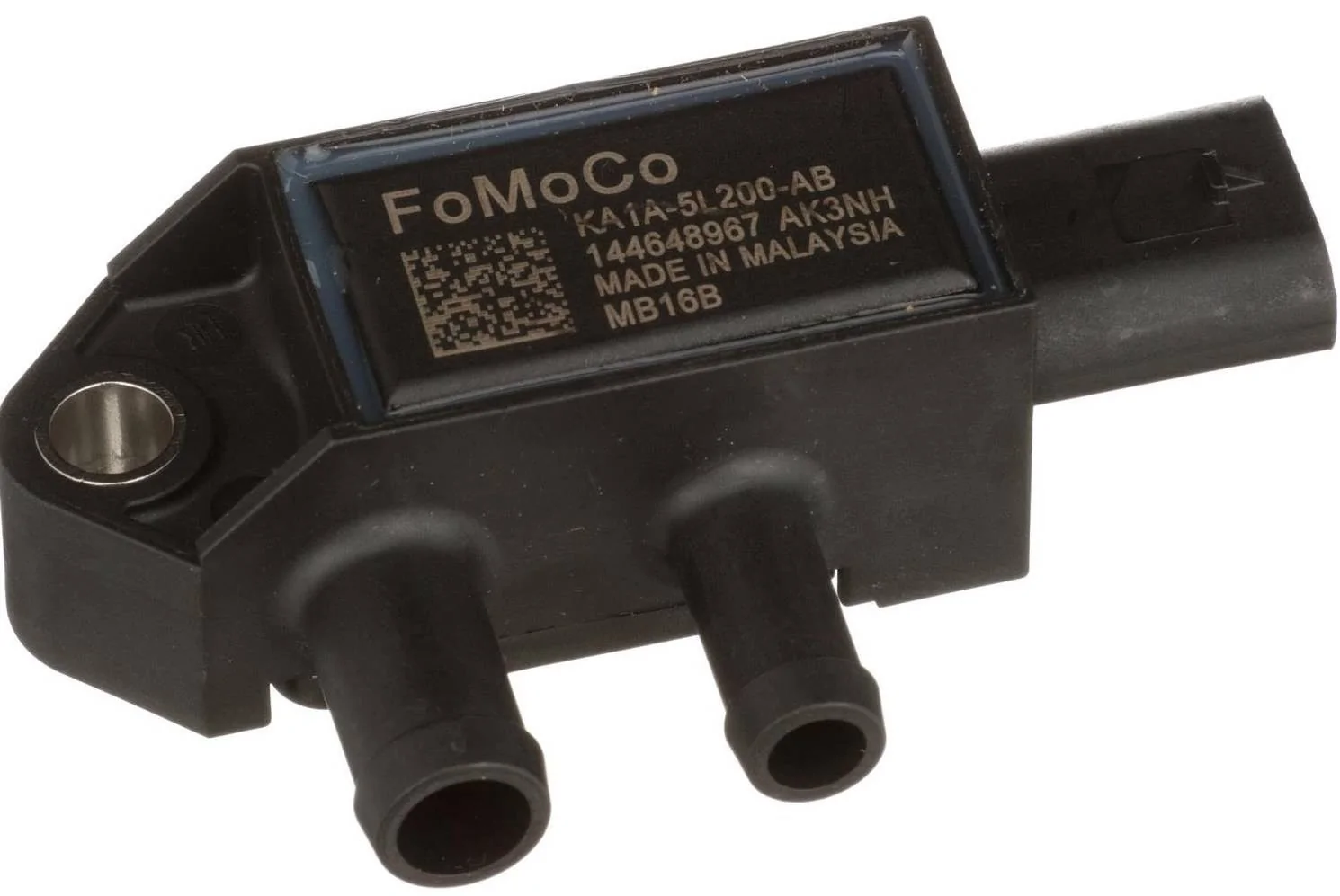

Just ordered 2 sensors from RockAuto (EGR Pressure Feedback (DPFE) Sensor) for $36.90.
2 day shipping arriving tomorrow.
It is a STANDARD MOTOR PRODUCTS Part VP41. Here's the picture they posted. Appears to be a FoMoCo part!
They have them in stock.
They arrived this morning. The print has been ground off, but they were sloppy with one and I can read "Malaysia" in the same location as the Ford part. It is identical to the Ford part in every way except for the ground off label. The FoMoCo can not be read, but it is clear that the lettering is much larger and bolder where the Ford logo is on the original. I think it rolls off the same line as the Ford part.
Yup, that's what made me make the original recommendation.
Not saying they won't switch at some point, but for now, stock up at the $18 price and roll with it.

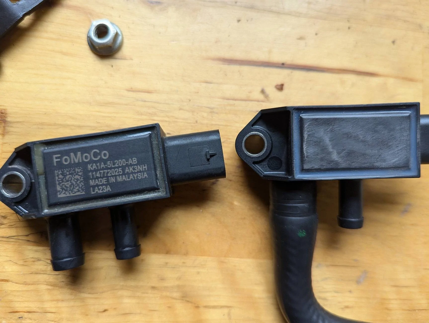

Ain't no way! I started having some bucking at low speeds about a month. I thought it was bad gas at first but it's been gradually getting worse. I was calling BS on this whole thread but I ordered the Standard brand and just installed it. Only went for a short test drive but I didn't feel any of the bucks or jerks. I'm still skeptical since I was convinced this was transmission problems but I'm hopeful now ??
Here's my factory sensor next to the new guy. Notice the sealant looks yellowed and uneven on the factory unit.
