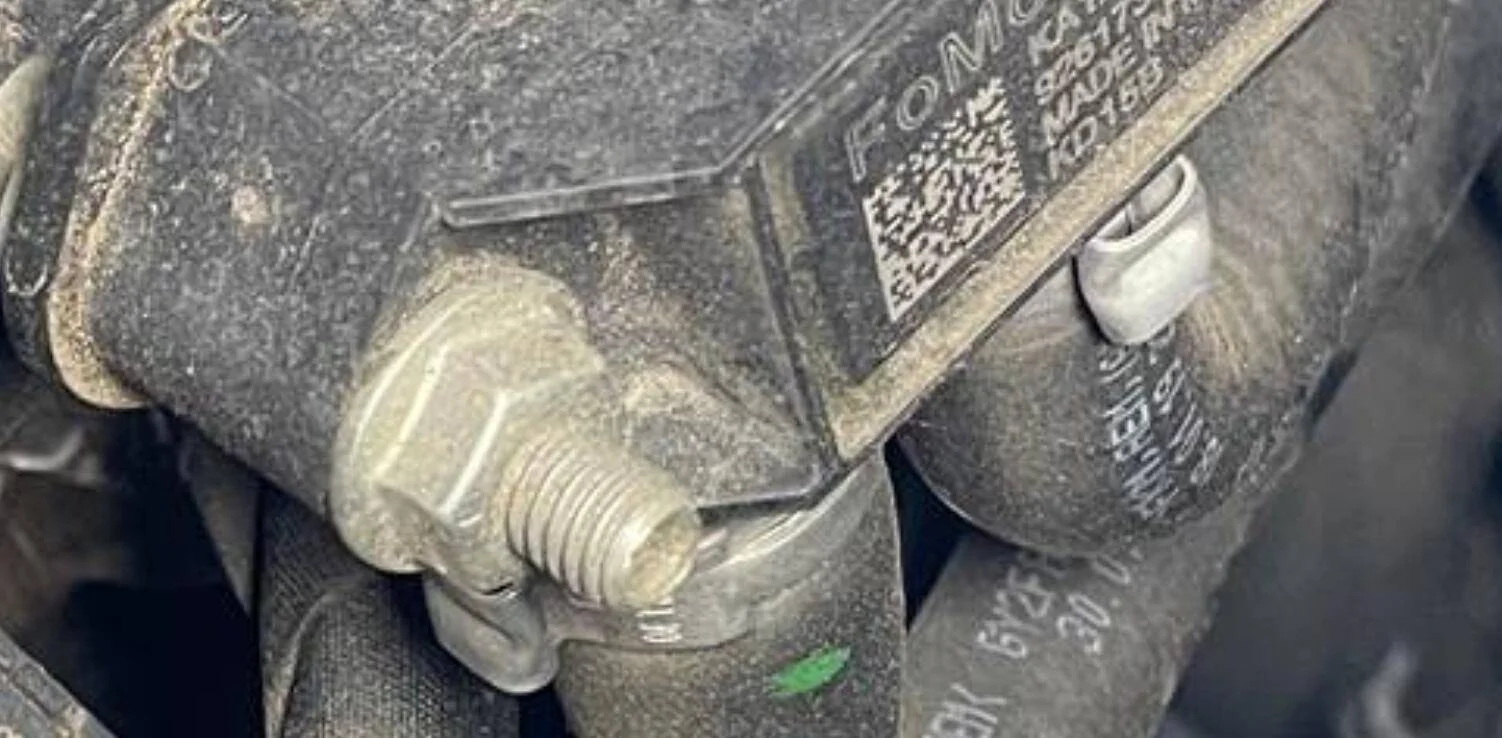

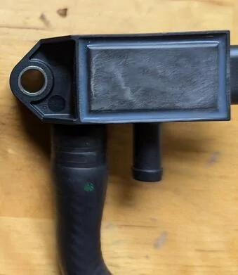

Order just the sensor and pull the sensor and two hose off as a unit. Place the hoses on the new sensor and reinstall. If you use hose clamps at the the sensor the next time around the job will take ~10 minutes as everything is easy to reach.
TIP: When placing the hoses on the new sensor, insure the dot on the hose faces towards the front of the sensor. This insures the hose are aligned properly. Look closely and you can just see the dot in the picture below.

Order just the sensor and pull the sensor and two hose off. Place the hoses on the new sensor and reinstall. If you use hose clamps at the the sensor the next time around the job will take ~10 minutes as everything is easy to reach.

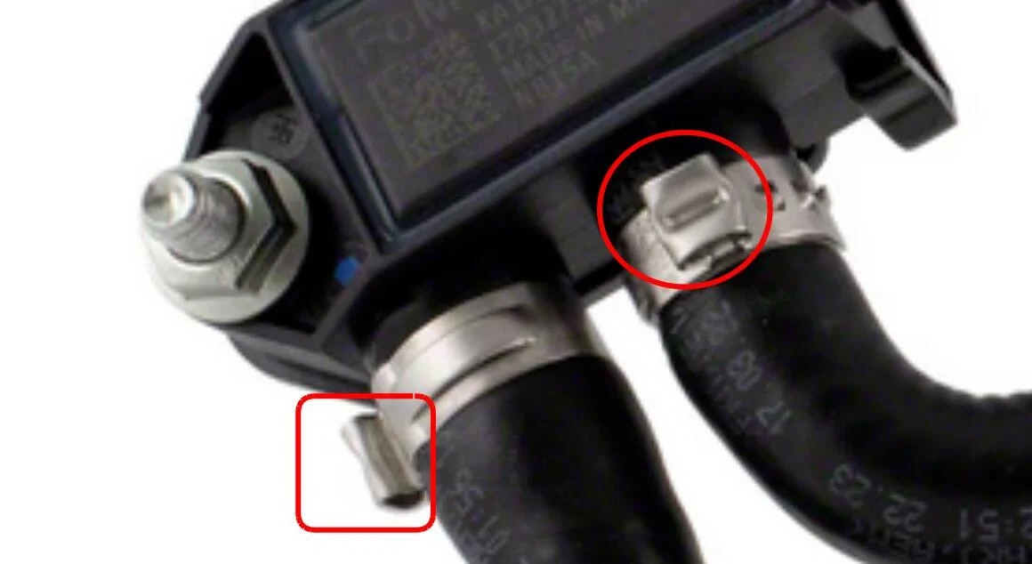

Thanks....I order just the sensor, but did notice the instructions show the removal and replacement of the full OEM sensor with hoses. For the clamps that hold the hoses on the sensor (closest to sensor) they look like different clamps than the others. Are they any different to get off with pliers? I'll be be keeping the original hoses as recommended so only would need to un-latch these connectors as show here.

Yes, and I did just that. The hose ends at the sensor have banded crimped hose clamps that will need to be removed. The ends that connect to the steel tubing can be removed with needle nose pliers. Simply squeeze and pull the hose off the tubing.
Once you have the sensor and the two hoses off as a unit, you can install the hoses from the old sensor and use new 3/4" hose clamps in this style. Be sure to orient them so they can easily be removed next time around, which will make the job will be much simpler.
To get the old crimped clamps off easily, insert a small flat blade screw driver into the raised crimped part of the clamp and lift. It will deform / loosen the clamp allowing you to remove it.

Got it, but I believe you are suggesting that I will need to acquire new clamps as a result, or can they be re-used?

They can't be reused. You will need to buy small hose clamps.
