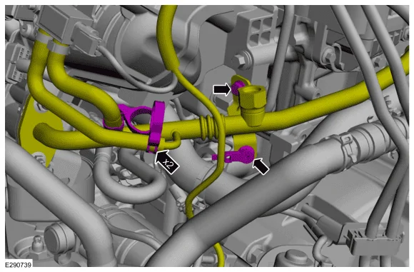

To highlight the Tube Assy:
Ref: The DPFE Sensor
The Right Hose is the Downstream Press (Intake Side)
The Left Hose is the Upstream Press (Exhaust Side or EGR Flow)
If you picture a restriction (inside the tube) this is the orifice (<=) and it is located between the (2) pick-up tubes on the tube assembly (roughly the location of the smaller pick-up tube (finger clamp)
When the EGR valve is closed, you have equal press on both pick up tubes, this is the Intake Manifold vacuum. (Low Pressure)
When the EGR valve opens (it creates a press differential) higher pressure on the Downstream (smaller pick-up tube) which routes to the Left Hose @ the DPFE
So now you have a pressure acting on both sides of the (Orifice)
The Pressure Difference
Now the sensor is seeing a High Pressure (on the small pickup tube) that feeds to the Left Hose on the DPFE (Upstream Pressure)
and
On the Larger Pickup Tube is seeing the (Downstream Pressure) (Ref) for the EGR Flow, it is measuring the pressure drop (as compared to the Upstream Press reading)
This differential pressure in the Orifice is how the EGR Flow is measured
A clog in the Orifice can throw the sensor reading askew or the small pickup tube
A leak from the increased pressure of EGR Flow anywhere along the tube can throw the sensor askew. (pressure bleed off)
Note: with all the pics posted of the DPFE water (it's always in the Left Hose on the DPFE) this is the High-Pressure side of the Orifice.
So, we have to determine if the water droplets can temporally block the Orifice and cause the fluctuating readings or accumulate on the High Press side (Upstream) of the sensor and throw the readings off.
Once it reaches the sensor, it has nowhere to go but evaporate if and when the Exhaust Flow has less moisture content.
any moisture that makes it past the Orifice and enters the Downstream side of the tube, it will be forced into the intake stream. Thats why we don't see any moisture in the smaller tube on the DPFE sensor (Right Hose)

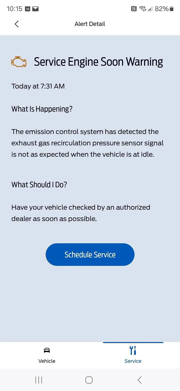

Well two days later I know have a check engine light and an alert in fordpass. Did I get a Bad sensor?

Well what an idiot I am. I plugged in forscan and it said hoses reversed. Lol
Check to ensure that they are in fact reversed, Ref diagram below for correct routing.
I just got this warning today after getting my Ranger back from the dealer for a regular maintenance! Bringing it back in the morning.
