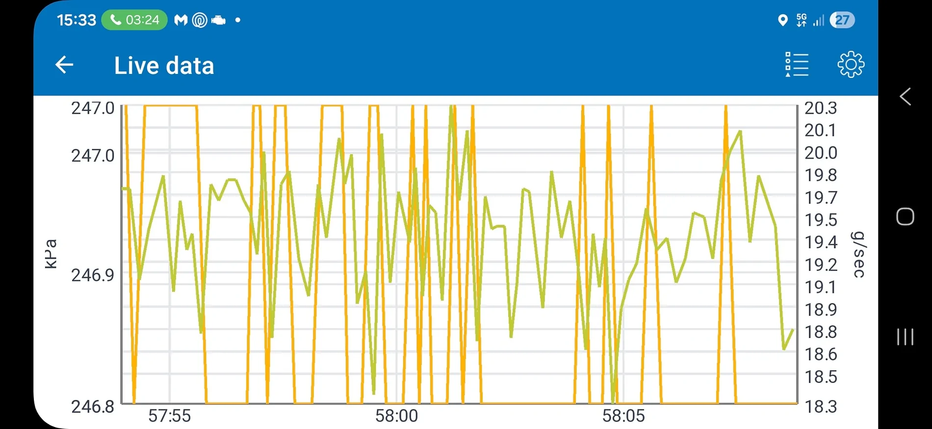

Update to the saga. I decided to buy a Hella MAF sensor made in China. Think it was a big mistake. I get over boost, and other times underboost, maf and map inconsistencies, maf and vaf too. Maf is all over the shop. Im buying a genuine one Monday.

I would go with (OEM)
If after OEM install - it still has issues for control
Try a KAM - Reset
Start Engine and let it (Idle Learn) for about 10 Minutes - do not touch throttle
You may try this with the (Hella) as well
I would also ENSURE the ducting is secure and in good condition between the (Air Filter Housing and the Throttle Body)
I would also do a good visual on the MAF sensor connector and its wiring. as its a possibility since this was disturbed - and the issues got worse - may be a sign of - Hey look at me
Summary
Bad MAF - Sensor Calibration (Aftermarket)
Bad PCM - Learned Data (Airflow Calculation)
Ducting (Leaks / Cracks) after the MAF sensor
Bad Connector or Nearby Wiring (Feeding The MAF)
