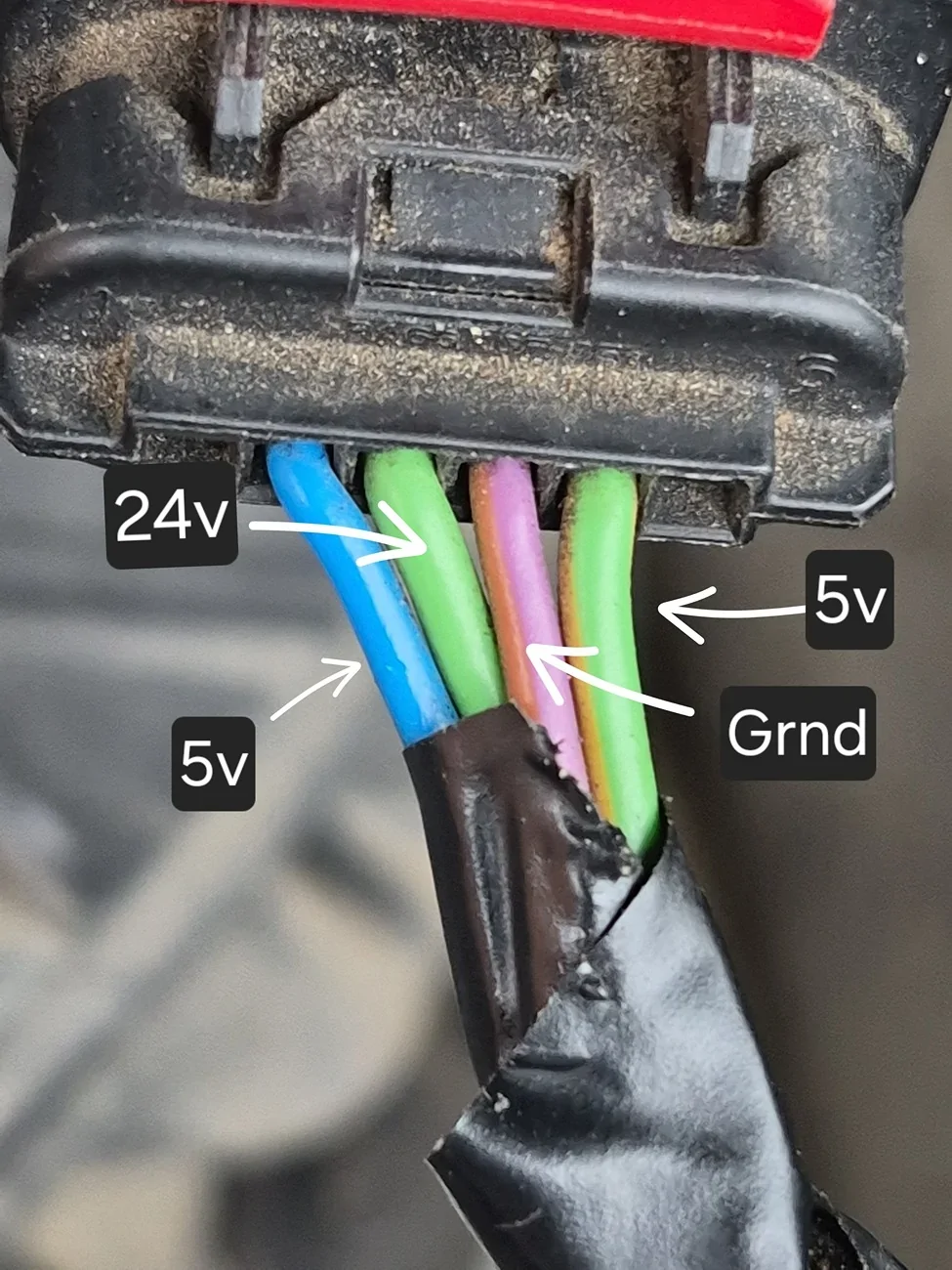

Ive done a PID of the MAF just Key On. It reads 2.5 on idle its around 19. The maf does react to throttle while engine is running. Possible learning error? Im going to reset KAM using forscan next i think

I've also checked voltages at plug. Green Yellow is signal back I think. Is this a modulated voltage? Are these correct? I've been trying to find data online but no luck. Its pointing more to an air leak.

Just to confirm - You have replaced with (OEM) and still have issues
You are wire testing (Via) back probing - 24 Volts is not right and your KEEO and Idle readings are not right - I cannot locate a wire (pinout) diagram for the 3.2
Something is not right - either the sensor is shorted or the wiring is and I wish I could see the wiring diagram for proper wire testing
Im trying to find it too. I will see whayvI can find

I am going to use a (Possible) Pinout - Not Confirmed - (Left To Right)
Pin 1 (Blue) = IAT Signal
Pin 2 (Green) = 12 Volt Power Supply
Pin 3 (Violet / Red) = Signal Return / Ground
Pin 4 (Green / Orange) = MAF Signal
KOEO - Sensor Disconnected (Meter)
Black Lead to (Battery Negative) and Red Lead to each pin
Pin 2 - 5 Volts
Pin 3 - 12 Volts
Pin 4 - 0 volts
Pin 5 -0 Volts
Then (Red Lead to Battery Positive) and Black Lead to
Pin 4 = 12 Volts
I may have the IAT & MAF Signal (Swapped)
Just a quick wire check - as the 24 Volt Reading has me questioning that voltage reading accuracy
I am also thinking that
The 4 wires consist of
Power - 12 Volts
Ground - For Heater (Chassis)
Map - 5-Volt VREF
Signal Rtn (MAP) & the PCM uses this as its signal (pick-up)

Pin 4 - 0 volts
Pin 5 -0 Volts
Pin 4 = 12 Volts
Power - 12 Volts
Map - 5-Volt VREF
Crap I made a mistake its 12v not 24v. I work as an electrical engineer and control voltage is 24v. I was in autopilot when I made the image. Sorry. Pin 5 has me guessing. Its got 5v on it. Surely the return should not have a voltage if the sensor is not plugged in?
Or does this get modulated and sent back on pin 4?

correct the IAT should read 5 volts (with it unplugged) and the MAF should read (0 volts)
airline tech
Aug 24, 2022
4,499
8,592
Midwest - KS
Aircraft Tech
Another possible is sometimes the Signal Wire is also 5 volts (unplugged) the PCM provides 5 volts on the signal wire and the sensor provides the ground path
The 5 Volt VREF is simply power only to the sensor.
The signal return is a 5 Volt supply and the resistance to ground = MAF signal
The 12 volt supply is for the heater and the ground is for the heater circuit.
I think the above would make the most logical sense with your readings via back probing - and you have no MAF signal and you are speed limited - it is in Limp Mode
So for me the MAF that is installed is bad and this is why it would be a good idea to reinstall the original and see what it does.
