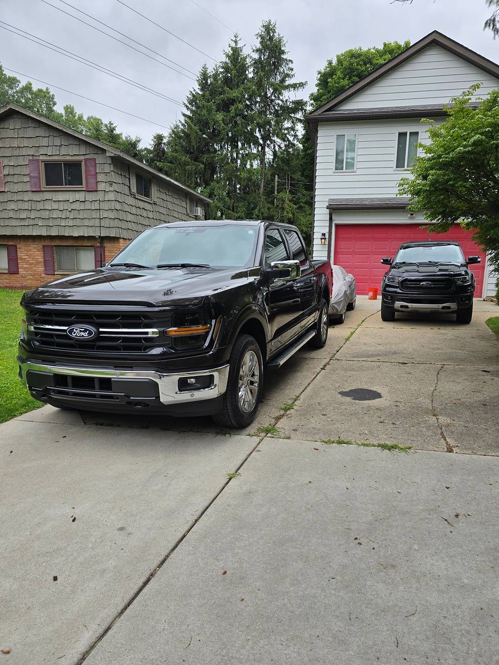

So, sorry for anyone waiting for an update, I'm afraid this isn't going to be very helpful. I've been doing a lot of data logging with forscan trying to get more of a feel for what is DPFE sensor related and what is transmission related and what is just quirks of the system. Driving the truck in the past few weeks, it's more or less behaved itself. This matches up with my past experience, the misfire/roughness seems to be the worst in spring/fall when it's a damp 40-50 degrees and disappears when it's dry in the summer/winter. However, since the truck wasn't having issues, I wouldn't be able to tell if swapping the EGR tube helped.
Even if the EGR tube fixed my truck, I realized it still would have a list of other issues that need addressed. (HVAC motor clicking, CDF drum weirdness, rusting rear door seams, needs new tires) So rather than fight it, I've opeted to replace it with a 2024 F150 powerboost.
Overall, the ranger has been a decent truck and has never left me stranded. But I'm tired of dealing with all the little issues and ready to move on. Sorry I can't provide more information to solve this issue for the rest of you folks.
