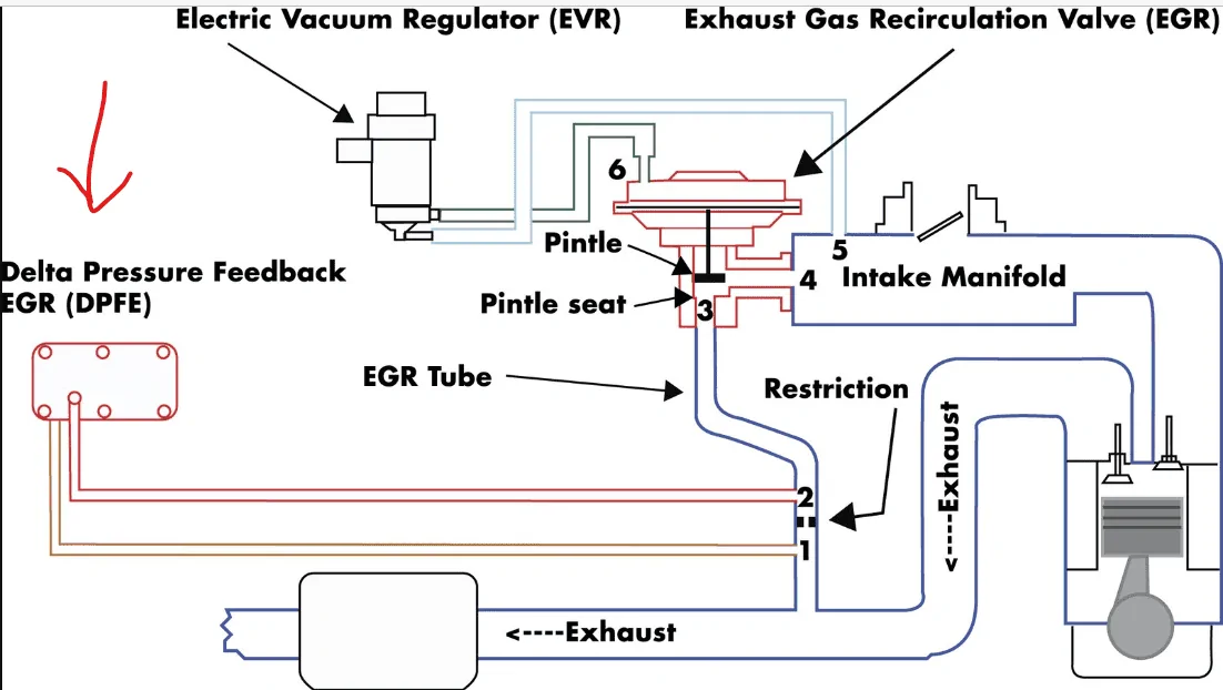

I ended up replacing the EGR differential pressure sensor KA1Z-5L200-A ($17 and in stock at my local dealer) instead of the whole assembly LB5Z-9J433-B0 ($30 but on back order). The assembly includes the EGR differential pressure sensor, bracket and hoses. Bucking is gone and 3-4 shift is smooth again! BTW, the water in the rubber hoses is normal, as combustion exhaust has water in it that condenses when it gets cool. Found a typical diagram of a modern EGR system. The failed EGR sensor is marked DPFE in the diagram and it is supposed to measure the flow of exhaust gas through the EGR tube. It measures the flow by sensing the differential pressure across the fixed restriction. The high the differential pressure across the restriction, the higher the flow. Lower differential pressure is lower flow. I suspect the failed sensor was not reading the differential pressure correctly (too low) causing an excessive amount of exhaust gas to flow into the intake

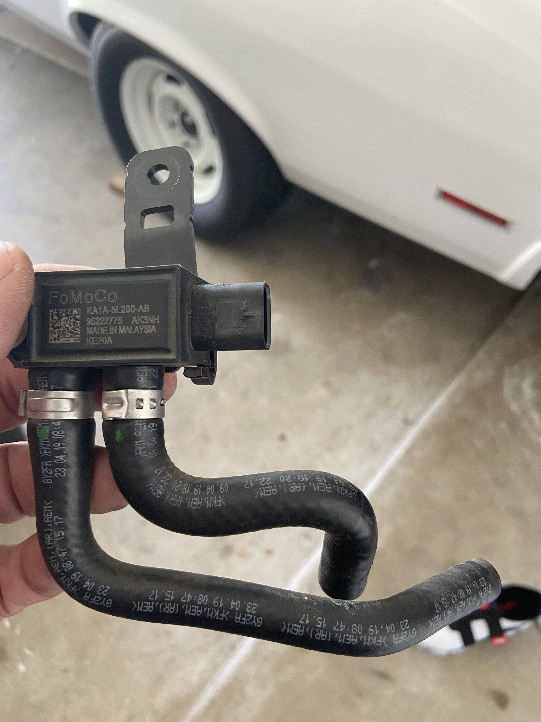

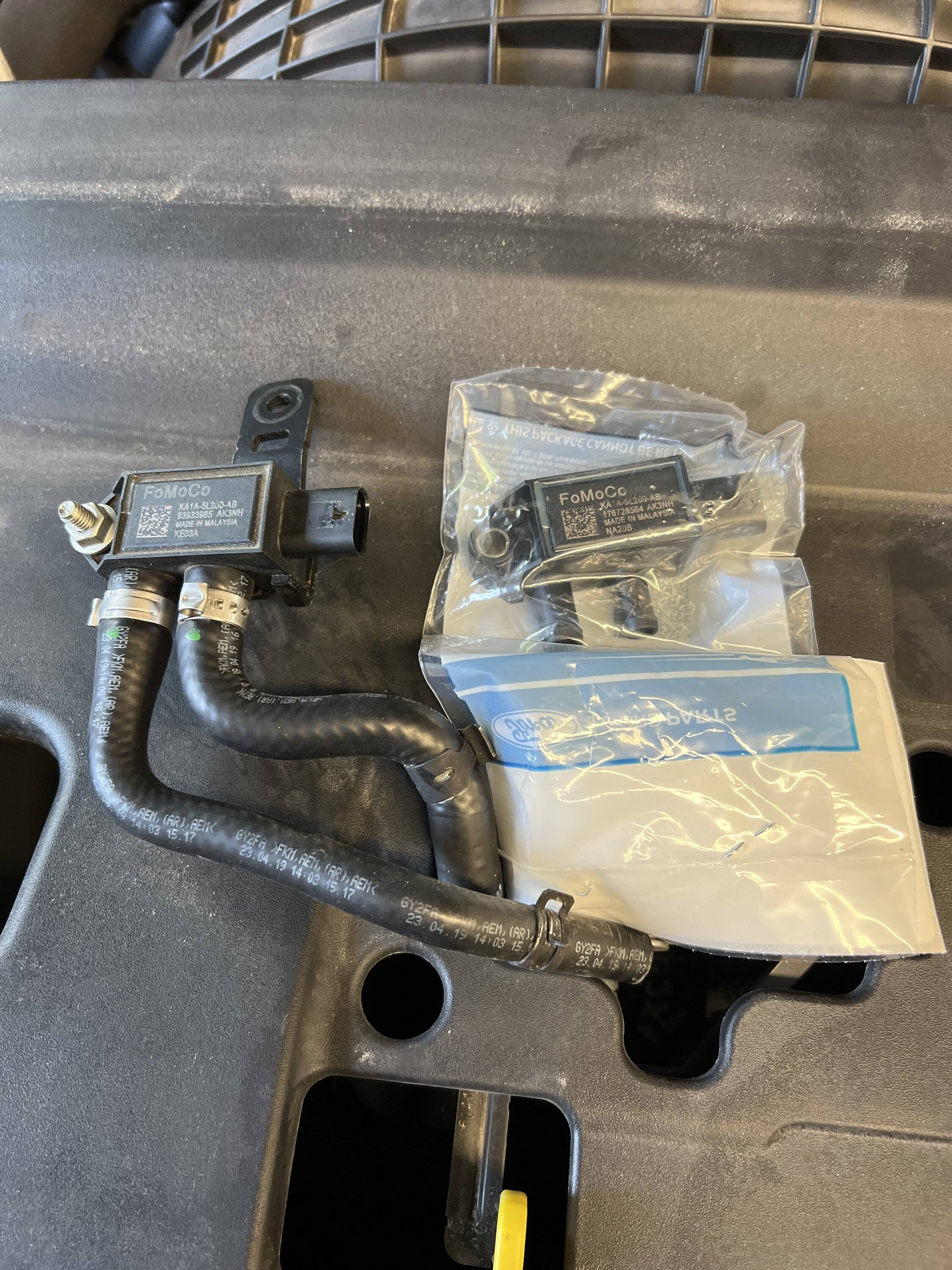

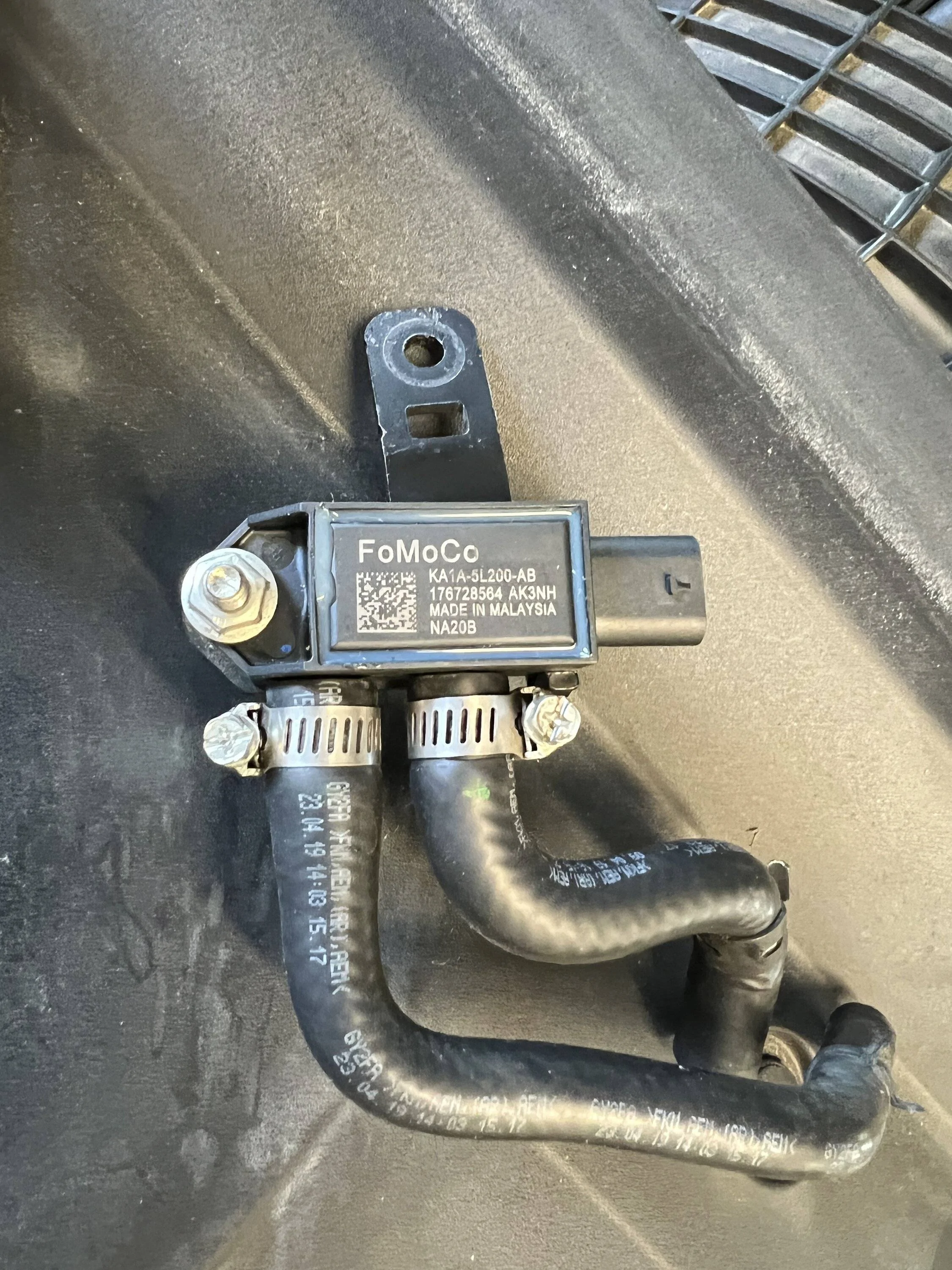

Pictures of old assembly and new EGR sensor connected to existing hoses and mounting bracket
