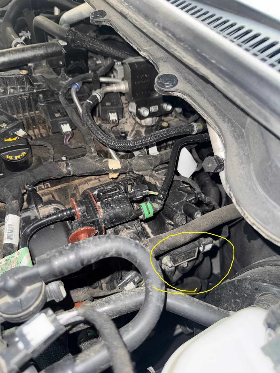

Nick, it is visible under the larger hose, just to the left (in the photo) of the brake booster. Single nut over the bolt, rectangular body, connector with the lock piece behind it, and the two hoses under it.

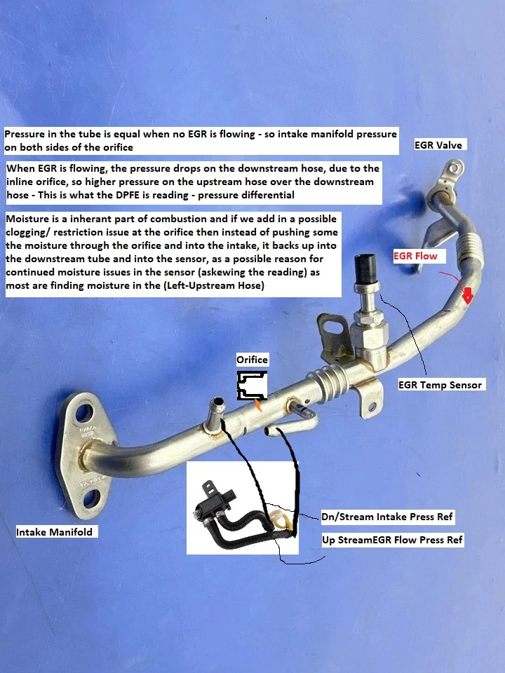

What was the code you had?
and
What was the DPFE sensor reading (Live Data)?
or was this a blindly changed shot gunned part?
Generally, the associated codes for the DPFE - P139A - P139B - P139C and P0401 - P0402 will clear on their own after 3 drive cycles with EGR events - (light will go out) and 40 warm up cycles to fully clear from history.
I am about 90% complete on my EGR System operation guide - so posting soon.
