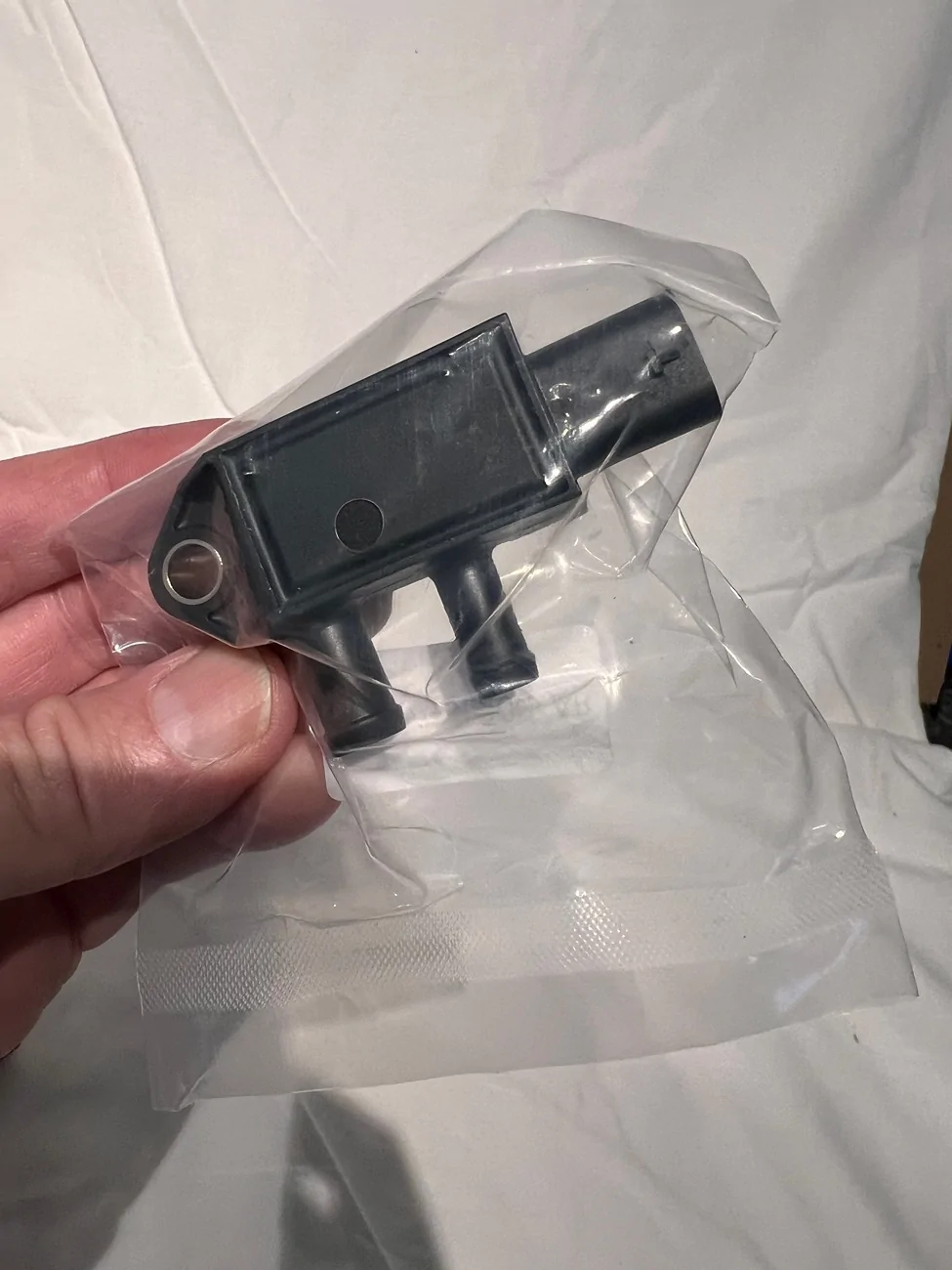

No markings on this one what so ever...... 👎🏽

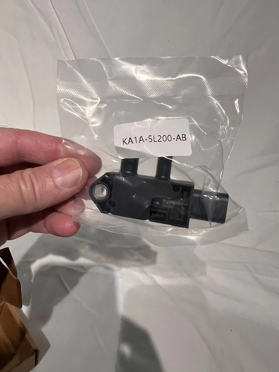

Clearly not Ford Stock... and maybe not even off the same manufacturing line. I've seen this happen on eBay and Amazon for this part. Wonder who manufactures them?
I guess it could be possible that the Ford Supplier could be manufacturing the part without the markings to get around the Ford contract.
The only way to know if it is reliable is to install it and see.
