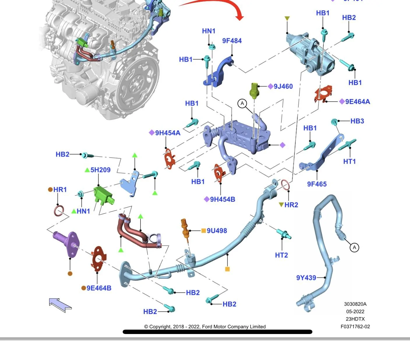

As I have stated - I did a deep dive into the compete EGR System, this is an example of the EGR Tube section - there are quite a few variables - I have not had the time to fully complete the document but this section (as it is currently written) provides a basic overview of the moisture accumulation in the tube assembly.
No - we cannot fully eliminate the moisture issue and yes it can reoccur (Repeat)
again I need to do some more (refining / editing) my rough draft - I currently have 83 Pages of system operation that I need to final draft - I have a basic understanding of what is causing the issues and it mainly lies in the - EGR Cooler (Lower Temps + EGR Tube) Temp + EGR Event Cycles (Duration) how long heat (EGR Flow) is being supplied to the tube.
I wanted a better system operation explanation than the manuals give , so I combined the manuals + Live Data (Drives) + Google Searches and put together a ref guide that makes logical sense.
Once you view a Live Data - Drive and record the (System Operation) you have a better view on why and how (moisture or DPFE Sensor Bias) causes the PCM to command more EGR than needed - this is the Buck-Surge and it all happens before it hits code limits (P139C)
it boils down to what is the (PCM's Learned - (0-Flow) voltage and pressure reading of the DPFE Sensor and its reaction time to EGR Flow.
He is my basic - EGR Tube (Section) - I think I still need to do some editing but for the most part is accurate.
