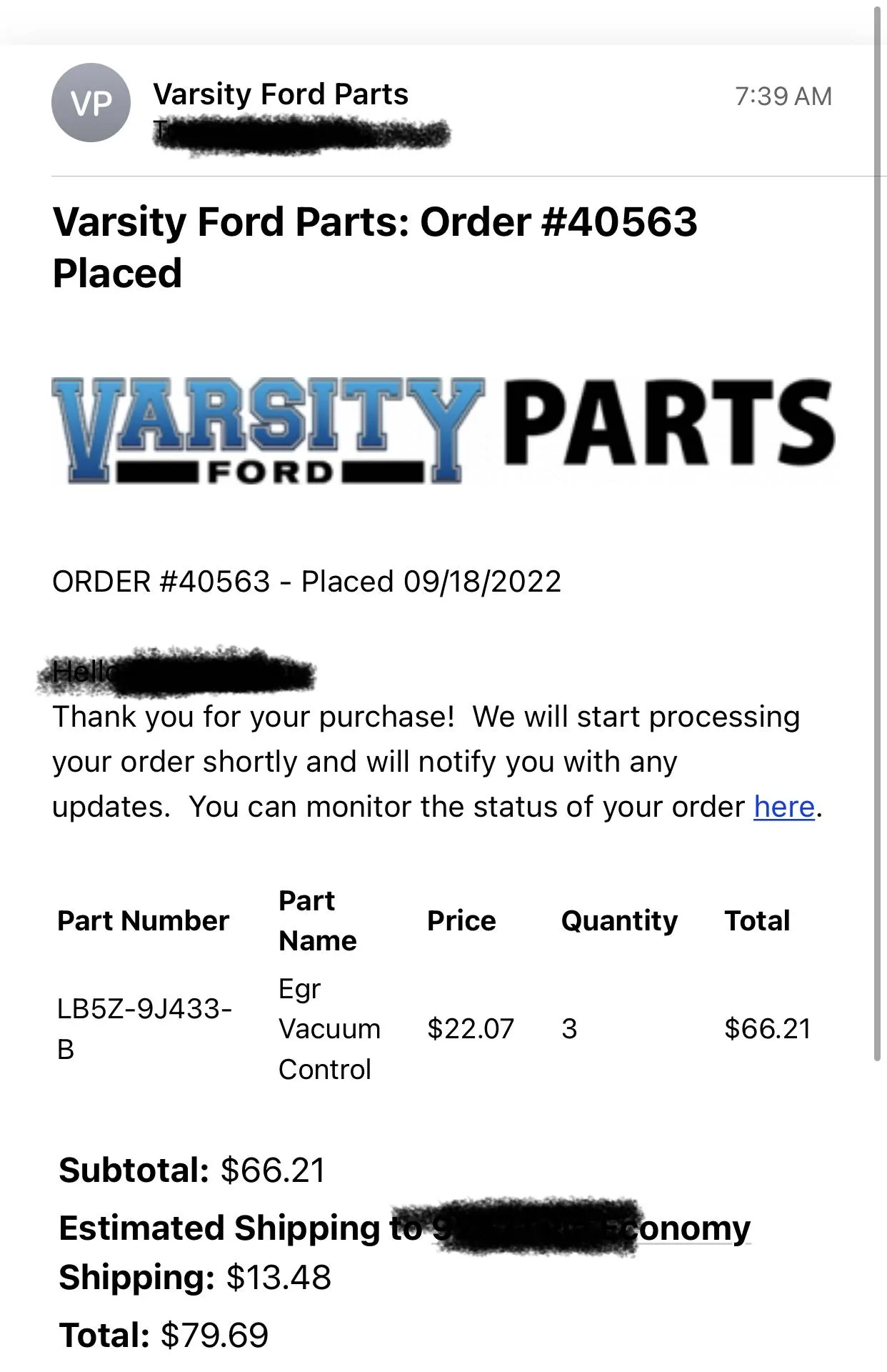

This Forum is the best!!! I’ve only had intermittent surging nothing that has ever been too bad. When I first bought the truck I installed a Mishimoto catch can I wonder if this helped my emissions system stay cleaner? I have a 2019 w/50k miles recently have noticed the ranger is a little more sluggish. So I’m going to change sensor and purchased 3 (2 for back up) I paid 22$ through Varsity Ford. Thanks again for all the information shared on this site the stealership will never help like this site.:clap:
