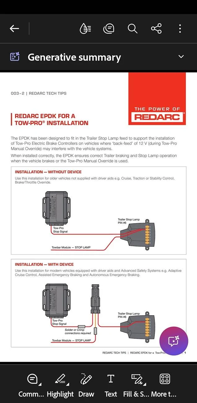

Reading the Redarc manual and they claim their unit compliments AEB. I presume via the brake light trigger. Maybe we're overreacting.
This setup is for Rest Of World Rangers, not Noth American. They have separate circuits for brake and turn signal lights, unlike NA which combines them for trailer lights.
The reason for the Lumen module is the Ranger uses two different types of control logic for the CHML depending if you have LED or HALO lights. It also is an isolator to prevent back feeding voltage to the BCM.
The reason for the harness to the CHML is because that is the only place to get a brake only signal without spicing into a major harness. Very poor planning by Ford on a truck advertised to tow 7500 lbs.

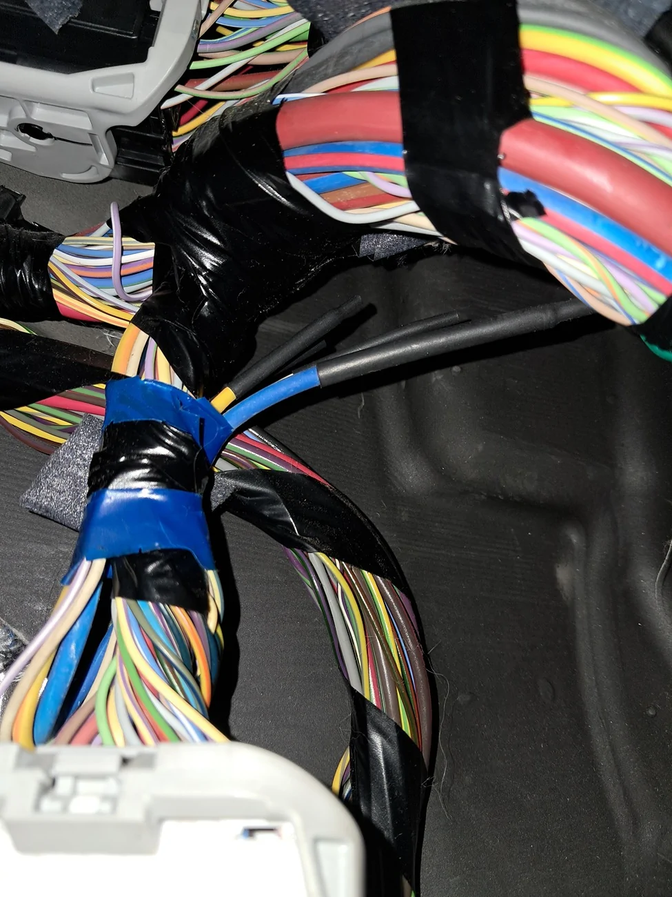

I looked under my dash and I have the four (one might be hard to spot) wires with the shrink tubing on them, so it appears I could wire in the Redarc:
I've got the Lariat with all the sensors, LED lighting and the automatic cruise control (when it feels like working). It really bugs me the CHMSL module specific for the Ranger isn't available. Is no such accessory needed on similar Fords? From what I read, the company making them before was bought y another and that seems like when they vanished.
I'd much prefer the Redarc although I wonder if there is any other well integrated solution.
