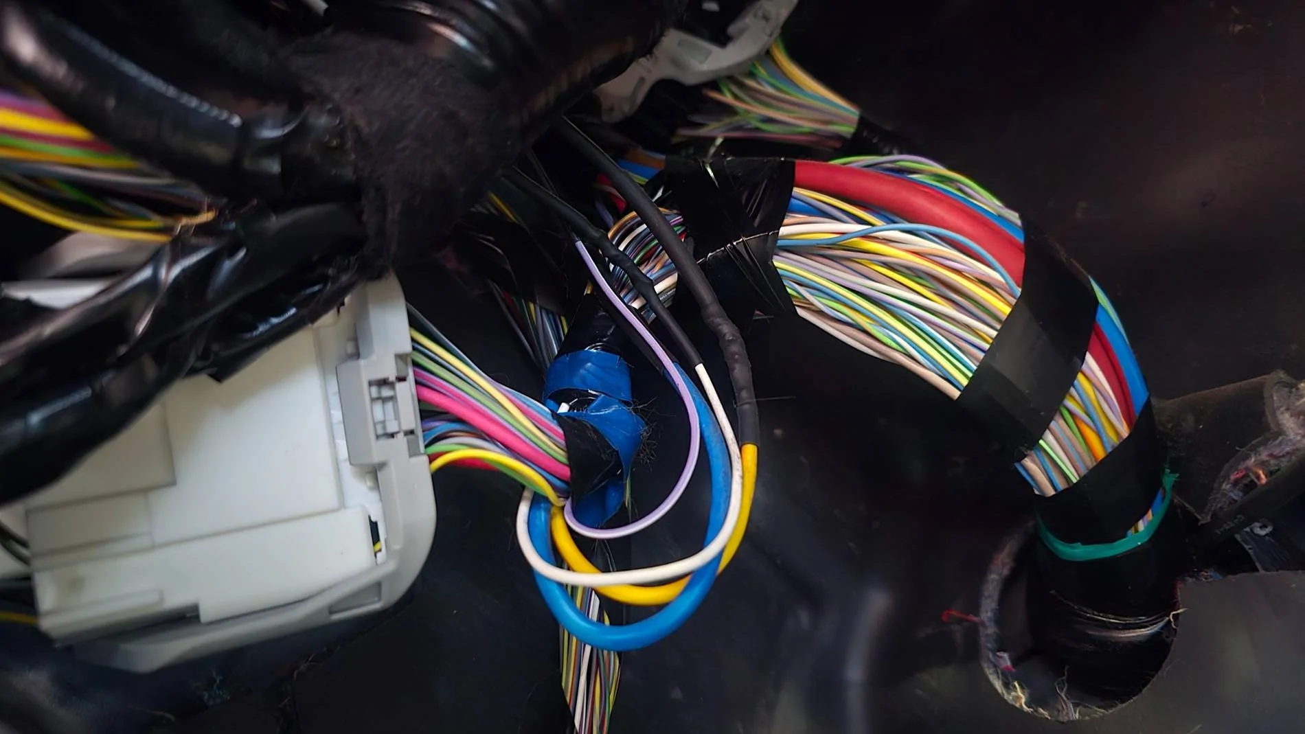

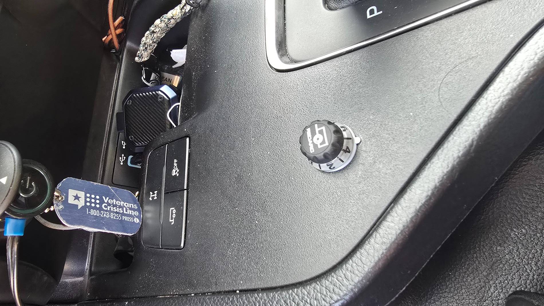

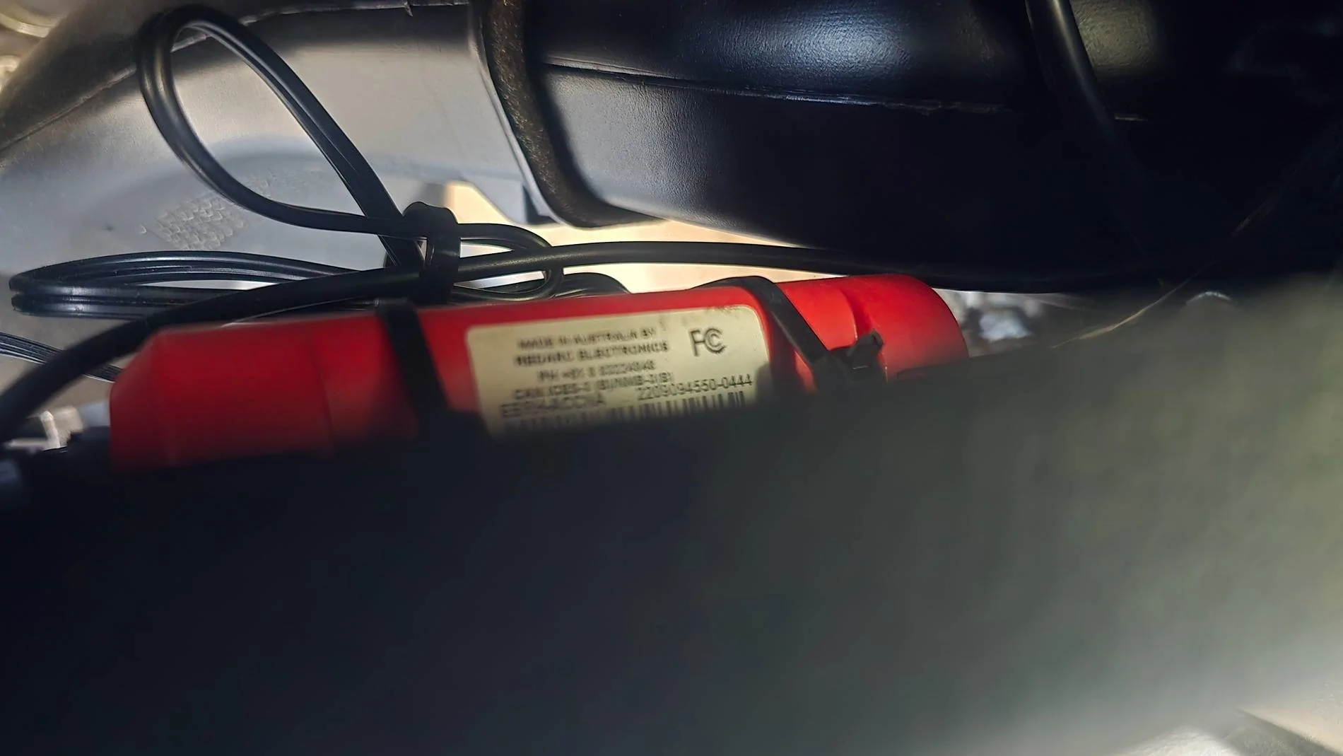

No did not tie in to the chisel. Connected to the 4 wires under the dash. Bingo.
Runs works just fine.
Bought about a year ago.
Thats where i soldered the wires,
Where i put the unit
Where i placed the controller
Simple easy no fuss
Simple easy no fuss
OK you have the just the Redarc brake controller and not the full Ford kit, we have been talking about.
