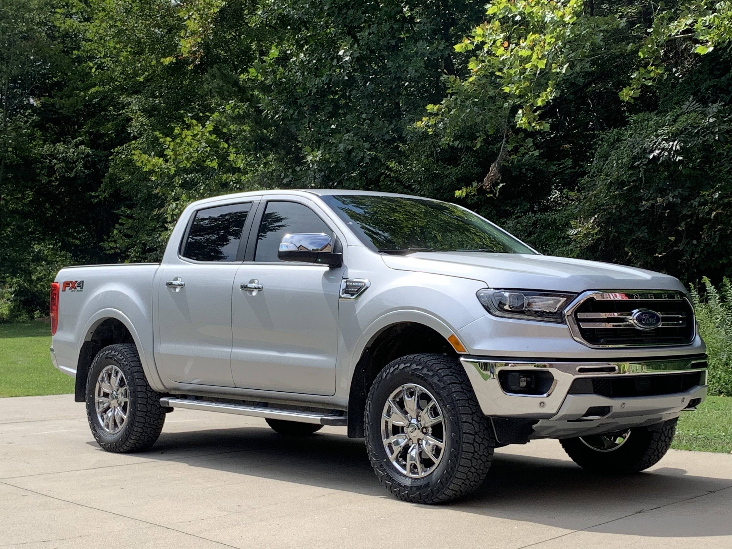

Scott,
My research showed that 265/70/17 or 265/75/16 is the biggest you can go on stock suspension. I have 265/70/17 and they work great...no rubbing. I got under the truck and double checked for rubbing...none

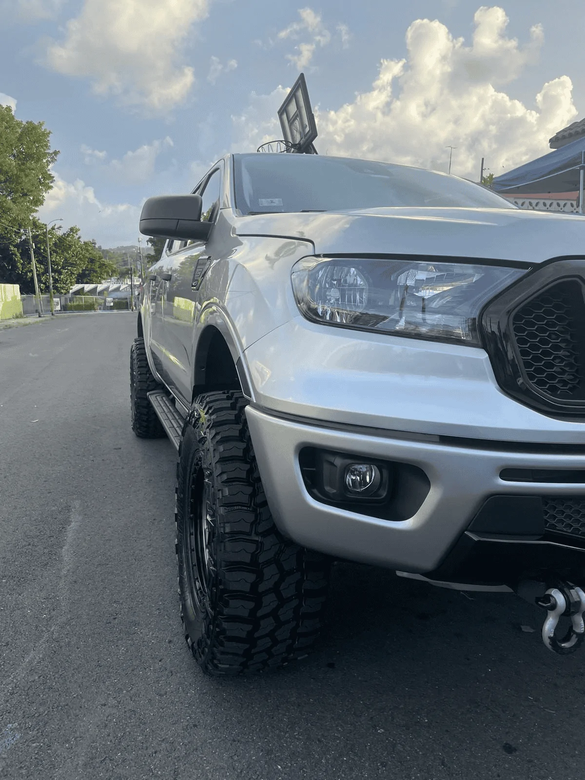

do you have a leveling kit?
Again, 265/70-17 fits a stock ranger with no other mods, without rubbing. These are likely the largest size that will. Someone should make this post sticky.
