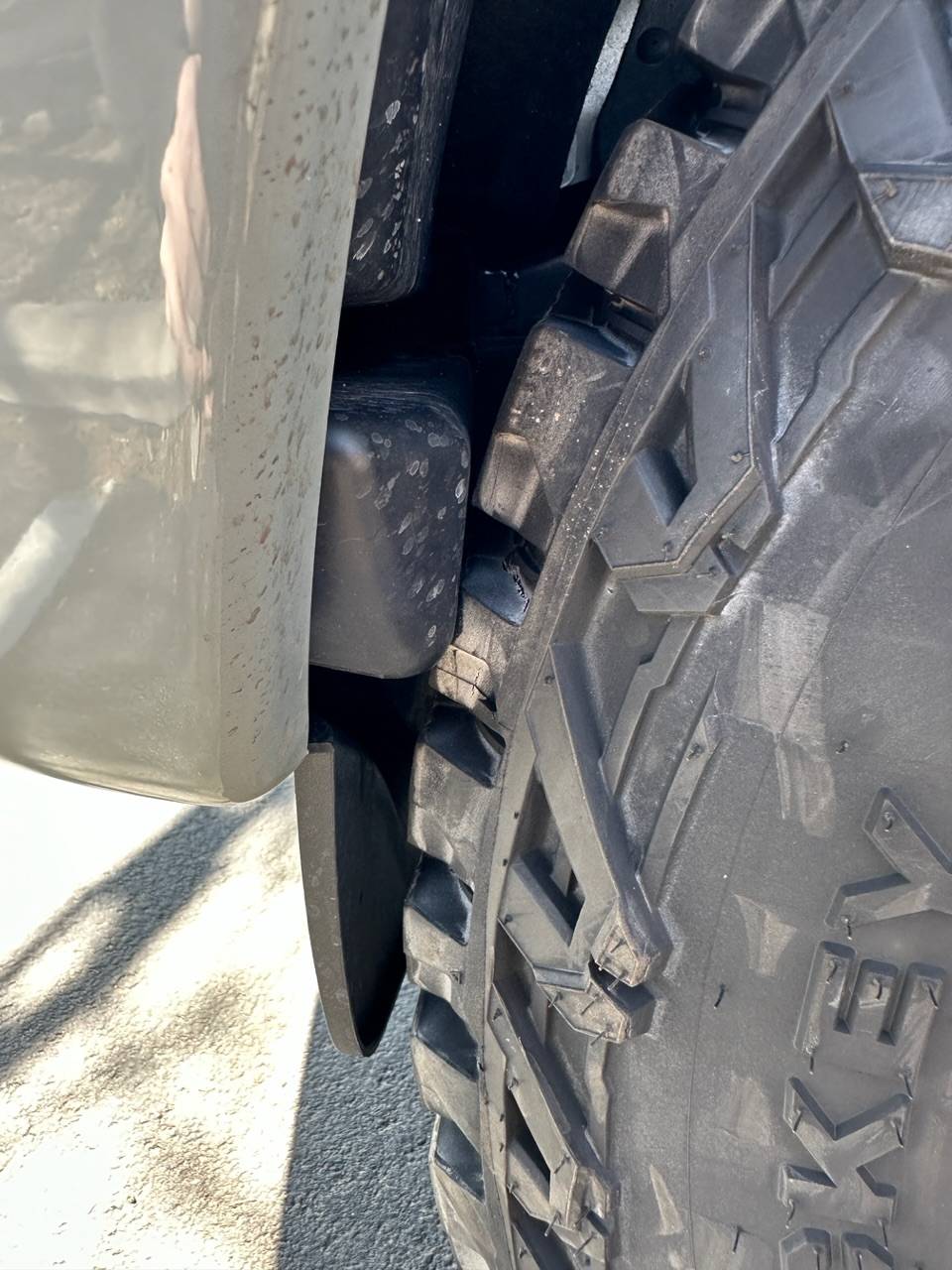

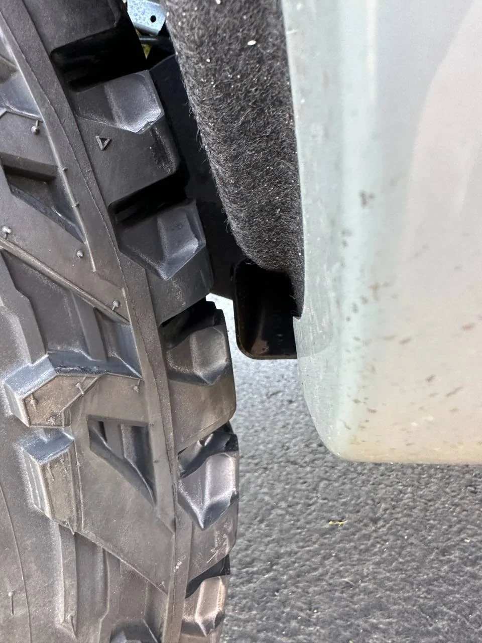

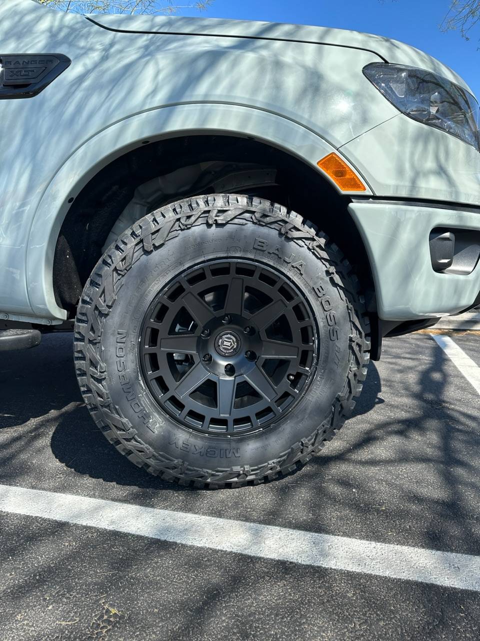

Well shit. After looking through this forum religiously I went with 265/70R17 Mickey Thompson Baja Boss and don’t get me wrong I LOVE them but they rub. Where? The front crash bar. Never once I remember seeing that be an issue. I was worried about the rear. I have a Eibach lift going on hopefully next week so I’ll have the shop help with removing them. Just sharing and still love the way it looks! Thanks!

Hopefully the lift will take care of this. If not, pretty sure the new bars will. BTW. Badass looking!!

I don't think I remember anyone saying that the 265/70/17 rubbed. They must be a true 32" where mine (Nitto Ridge Grapplers) are 31.6". They do look good and make sure all your driving is in a straight line until you get the lift on. lol

Aftermarket wheels and probably have less backspace. I have 265/70-17 Coopers on the stock wheels, stock height so far, and no issues, plenty of room between the crash bars.
