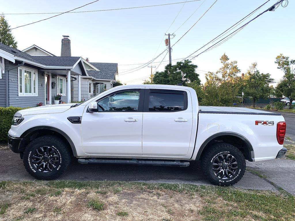

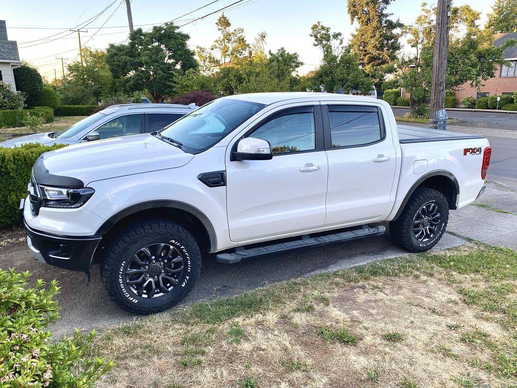

Found some gently used 265/70/17 KO2's on offer up for $300.
I forgot to specify at the tire place and they put the white letters out, I wish they didn't but its starting to grow on me.
The truck should have come with these tires from the factory.
Suspension is completely stock.
You'll like the KO2's. Lettering out looks great!
The OWLs look great on your white truck! They don’t always look that good but you’re certainly pulling it off.
