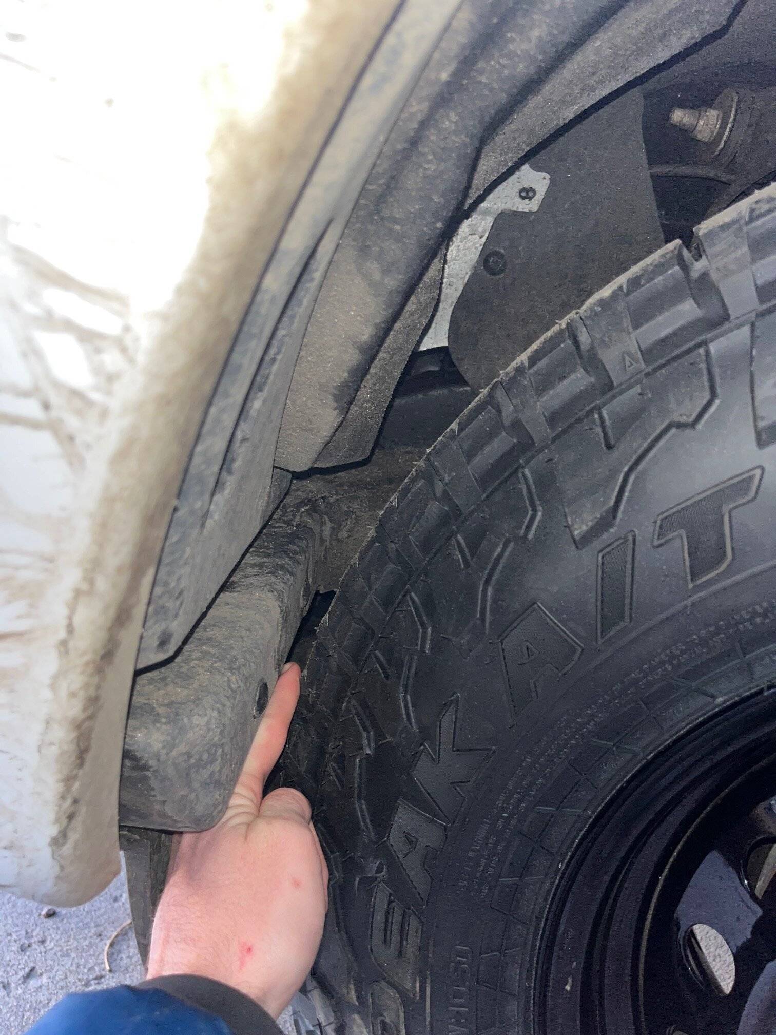

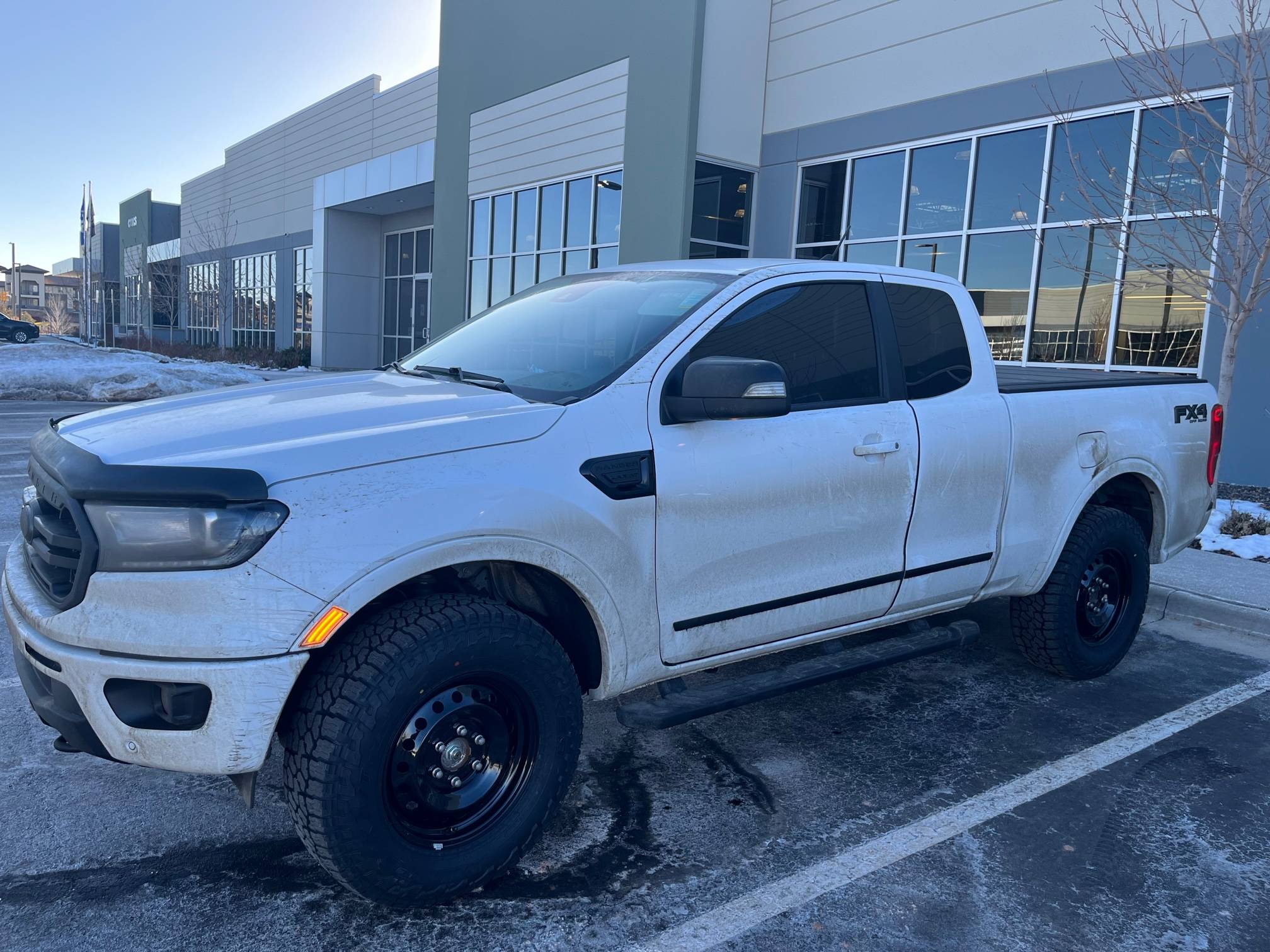

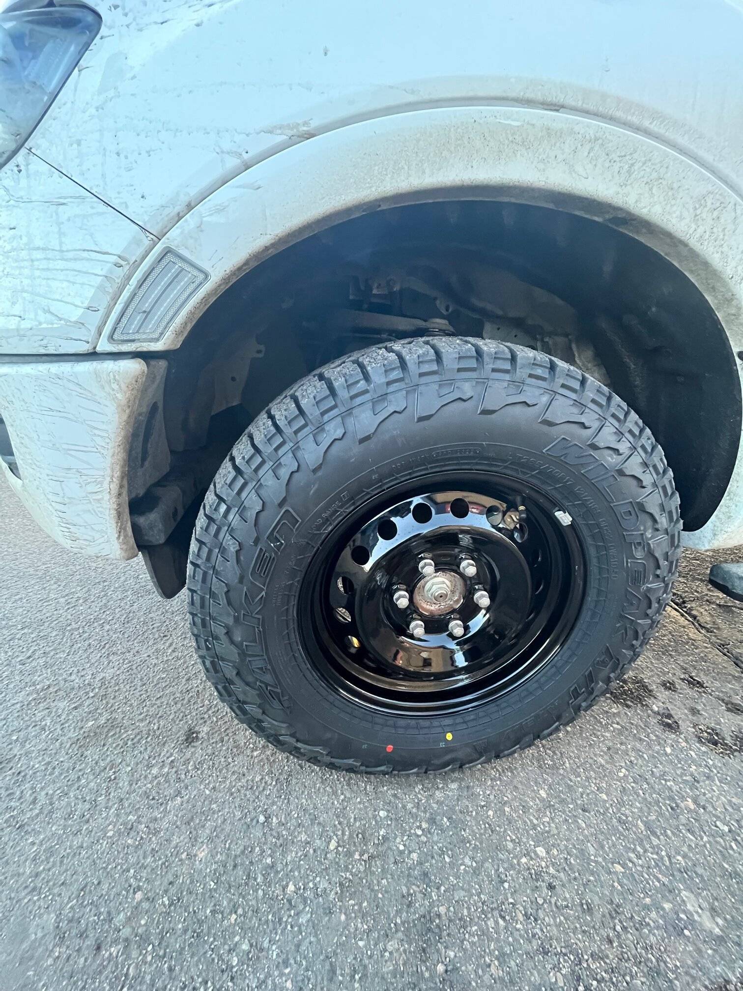

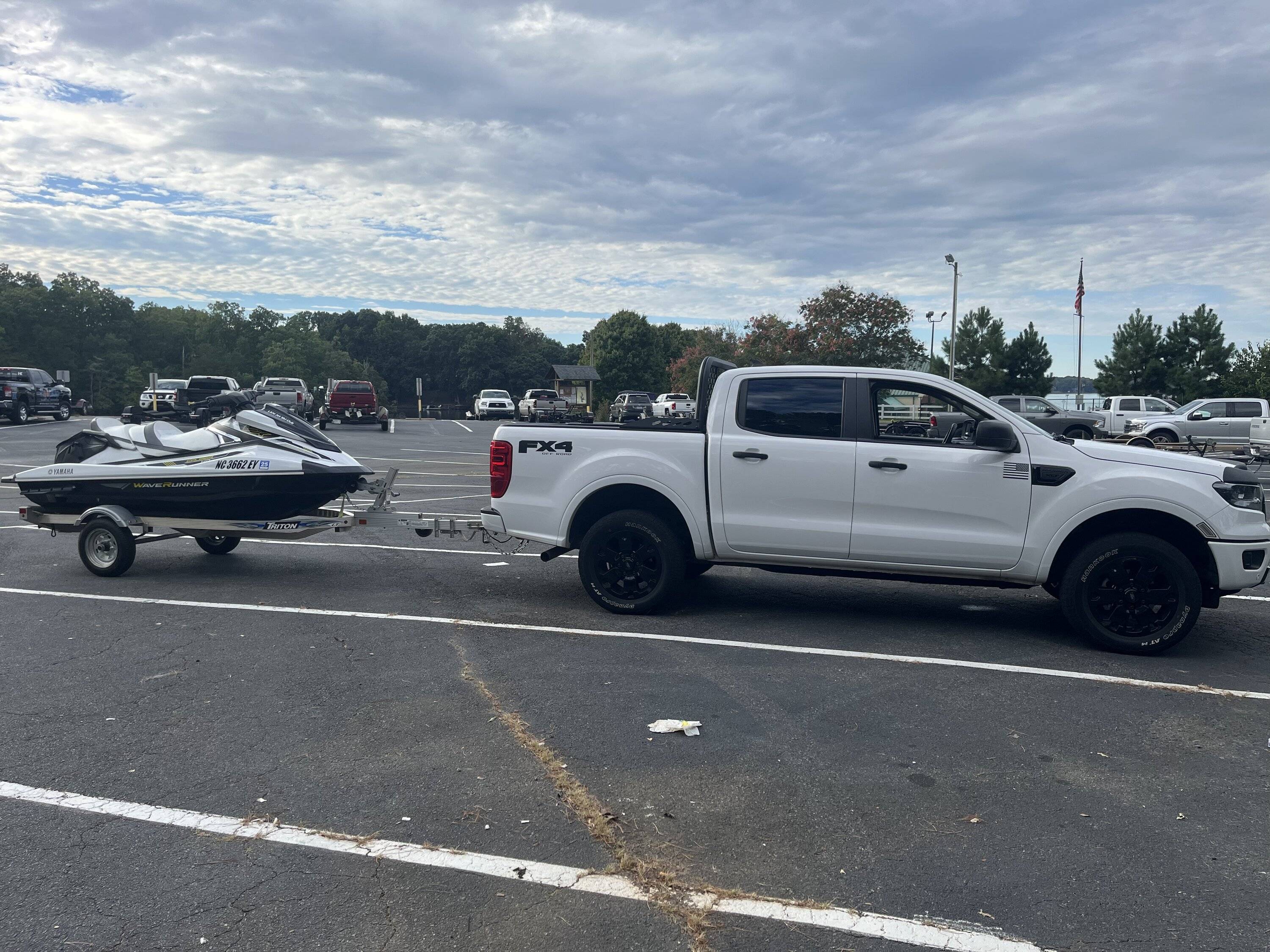

Installed some 265-70r17 Falken Wildpeak A/T3W load range E on my Fx4. No lift or crashbar modification - all stock. Very happy and no issues with rubbing (although its close in the front on full inside lock)
p.s. ignore my dirty truck!
Looks Nice ! Are those stock steel rims ?

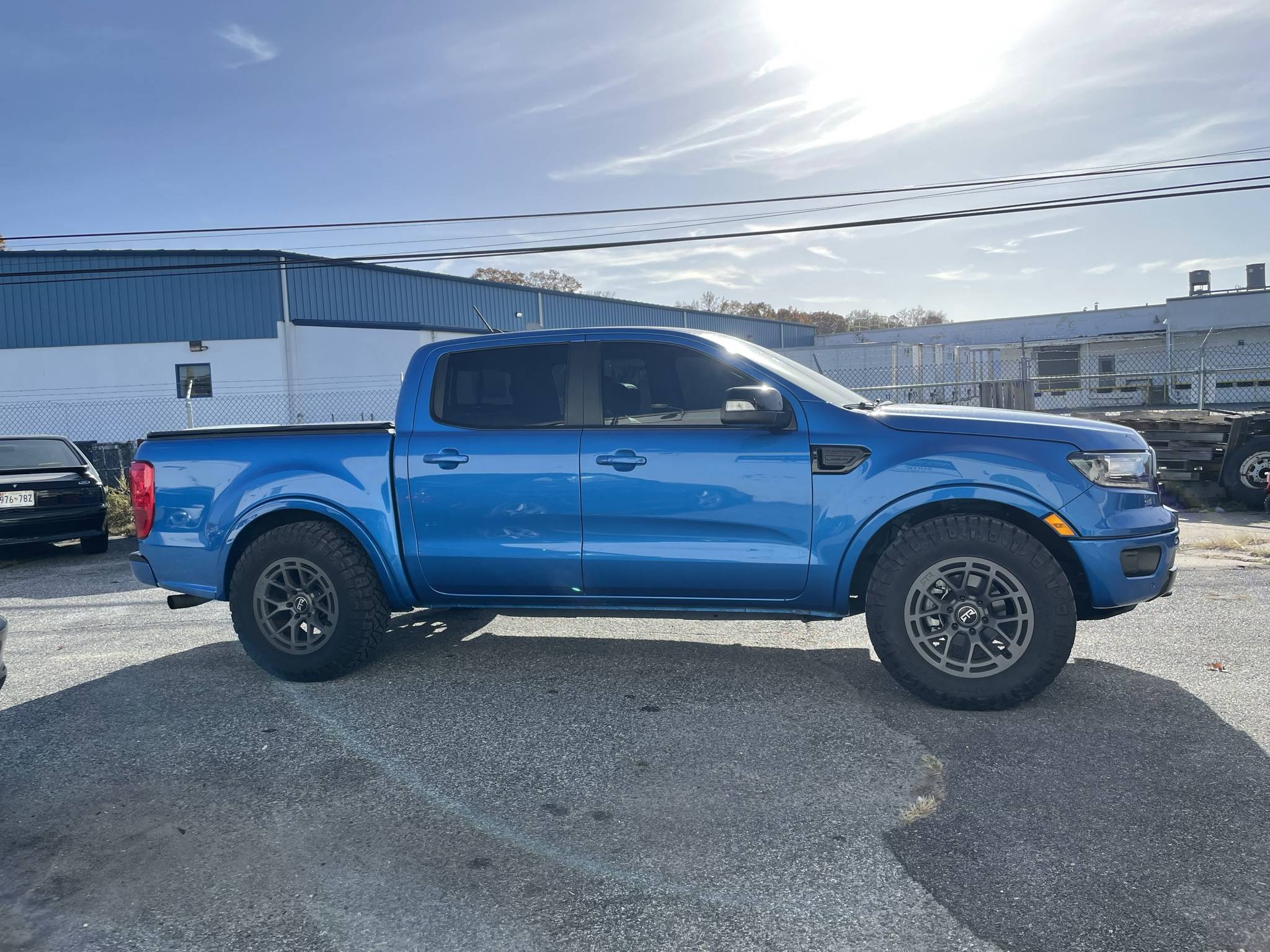

I have no “lift”
285/65/18 on 18x9 0 offset.
yes they will rub, yes I removed, bent, and cut things.
Looking pretty sick Mike. We’re going to have to start a new thread, “Biggest Tires, Negative Lift””
