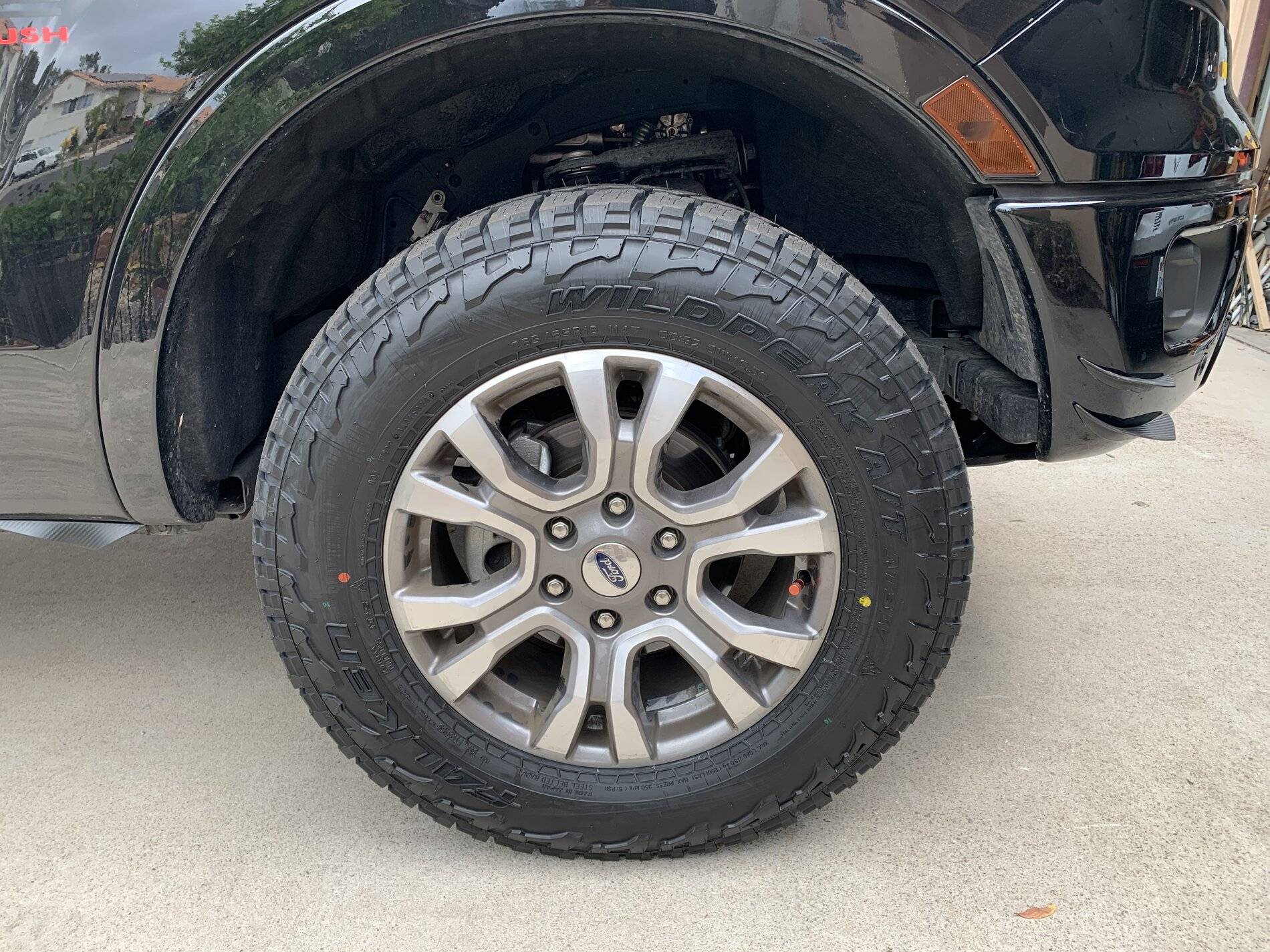

I went with BFG KO2 265/65r18 and there is no rubbing. I also added the Fox 2.0 coil overs to give the truck a better stance.
Hey Tony and fellow SD member. Do you have a picture of it showing how much it pokes out extra?

For the 18 wheel users. As @GTGallop mentioned, I would not go wider than 265. However, @Trash Panda has gone 265/70/18. Myself I have 265/65/18. Both of us report no issues. This is for no suspension upgrades, no spacers, and no crash bar modification. Not sure if Cody has taken it off-road and neither have I. Will update if there is any issues. Do notice an aggressive tread and sidewall will beef up the look a bit as well.

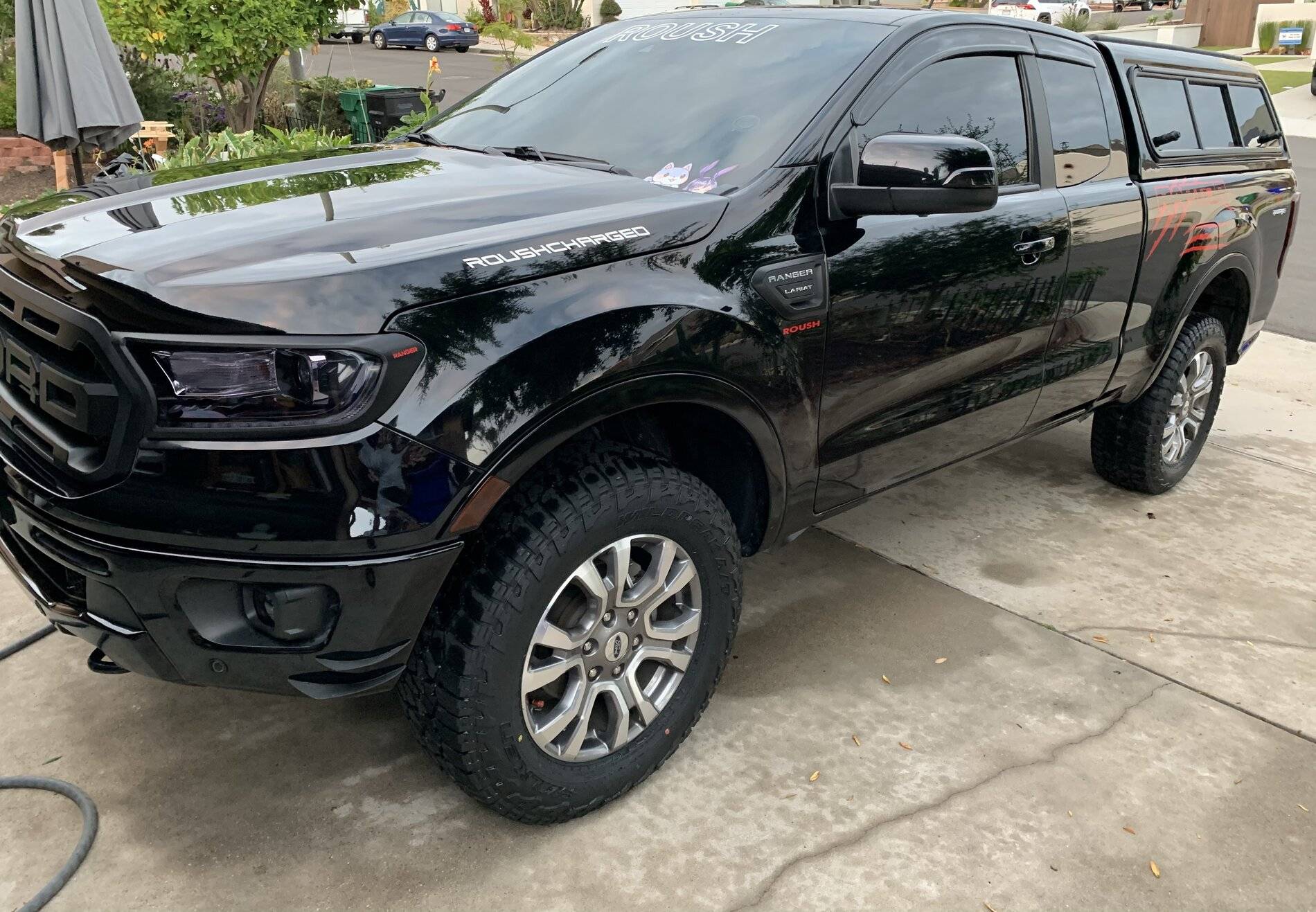

Yep, 265/70r18 Highway tread tires.
My truck is 2wd, I know I know, so I have not done any off-roading.
Street wise no scrubbing. Just an inaccurate Speedo due to the taller tires.

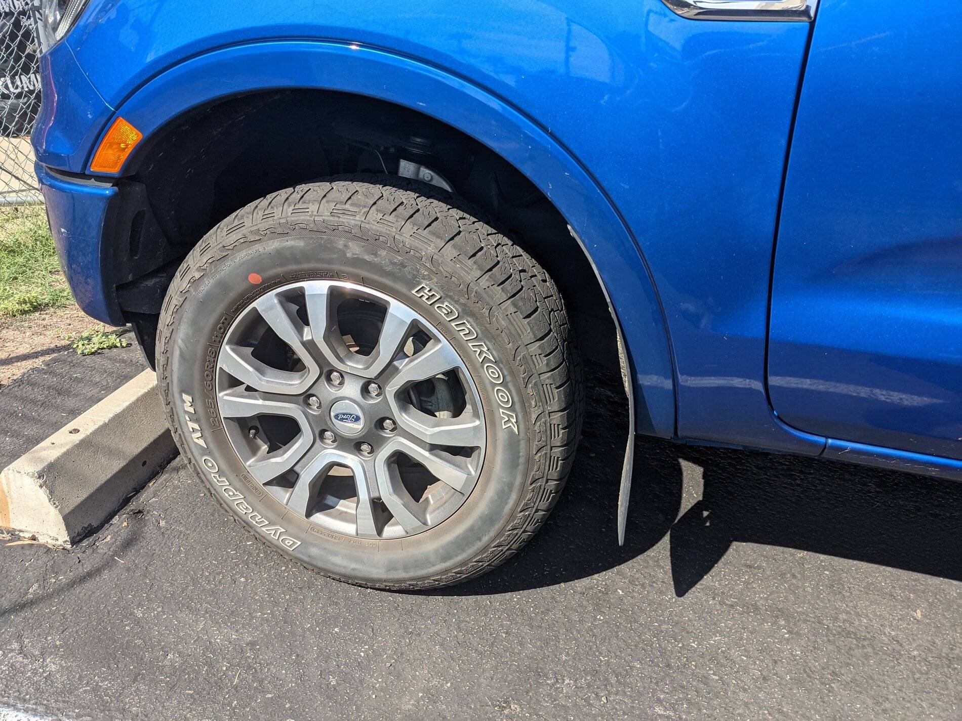

I have not taken it off-road which I would say is where it will be most important to test out... But, in terms of city/highway driving, I feel I have more grip and "feel planted". This is all from the feelings of my butt, so take it with a grain of salt. I will echo that the ride quality definitely did not decrease, however I did notice it loses slight grip over bumps going over 85-90. It was same bumps I went over with the Hankooks but keep in mind those are city tires meant for little highway bumps. My butt loves the ride quality though and my mind tells me it's better.
If you are looking to reduce the boaty feeling/body roll of the truck I would slap on some stiffer rear shocks or go the full route of coilovers in the front too. But I think rear shocks are sufficient enough at least for my type of off-roading and don't want to ruin my current center of gravity with the way I drive. Overall, yes it is a difference in ride quality but I really want to test the ride quality off-road primarily. Not to mention if my math is correct, I gain an inch of clearance as well.
EDIT: I have not adjusted the speedometer, so that may be the reason I feel a loss of grip at the same bump I take at 85-90. Now it probably is more like 88-95 in actuality. I have to watch out for the changes in speed at high speeds.

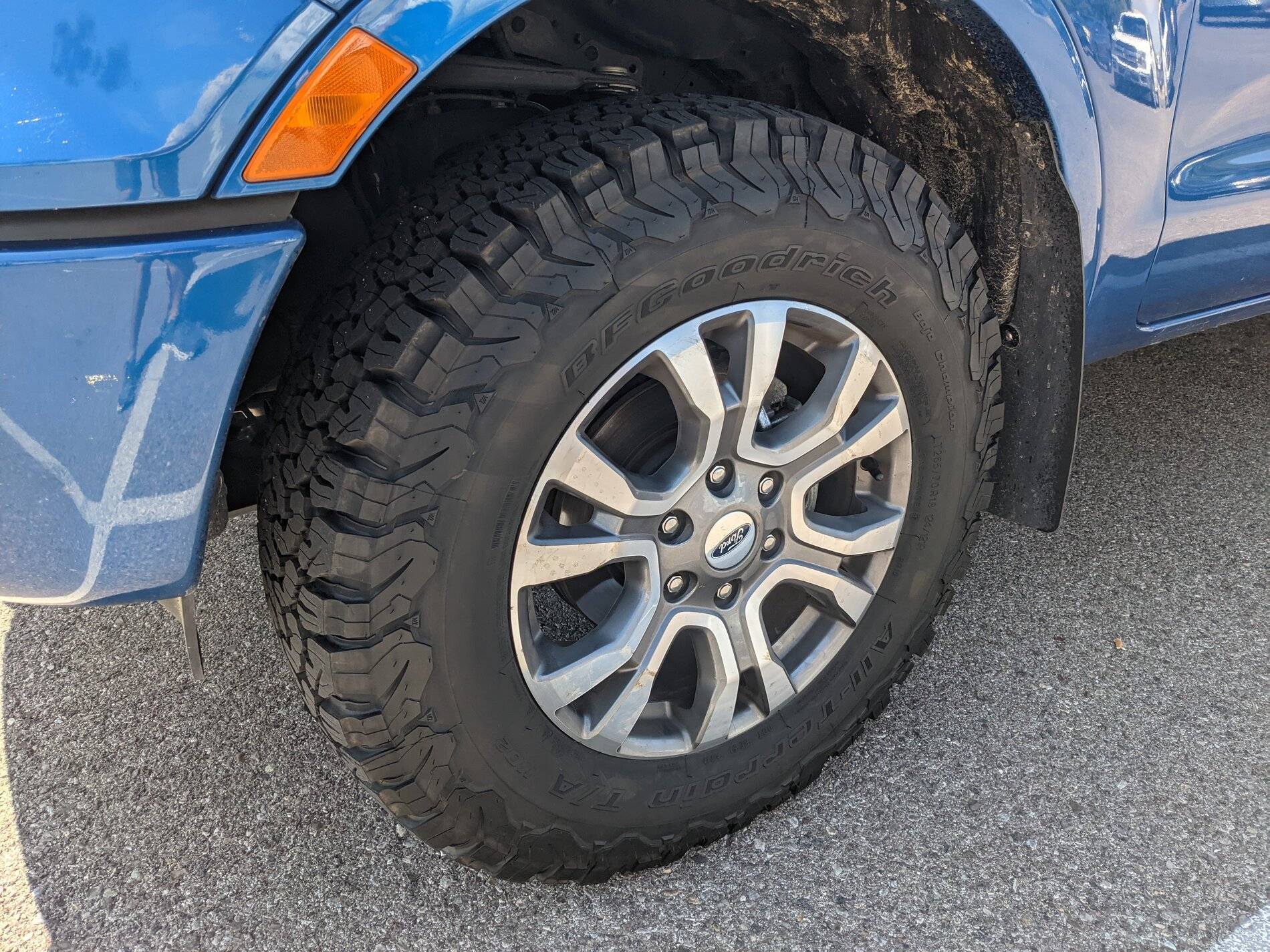

Just had BFG KO2's in 265/70r18 mounted on the factory 18" wheels. No rubbing and haven't had to adjust my front crash bars as of now. Plan to install a 2.5" level in the next couple weeks but what a difference over the factory size. Wish I would've taken like for like pictures before/after to have a better comparison to show.
