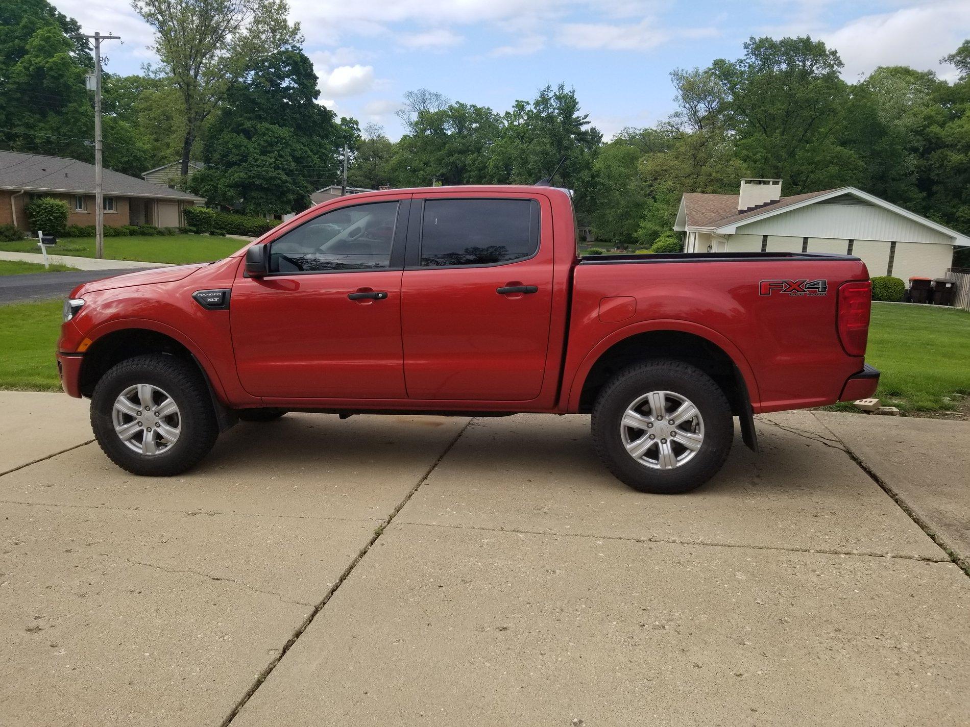

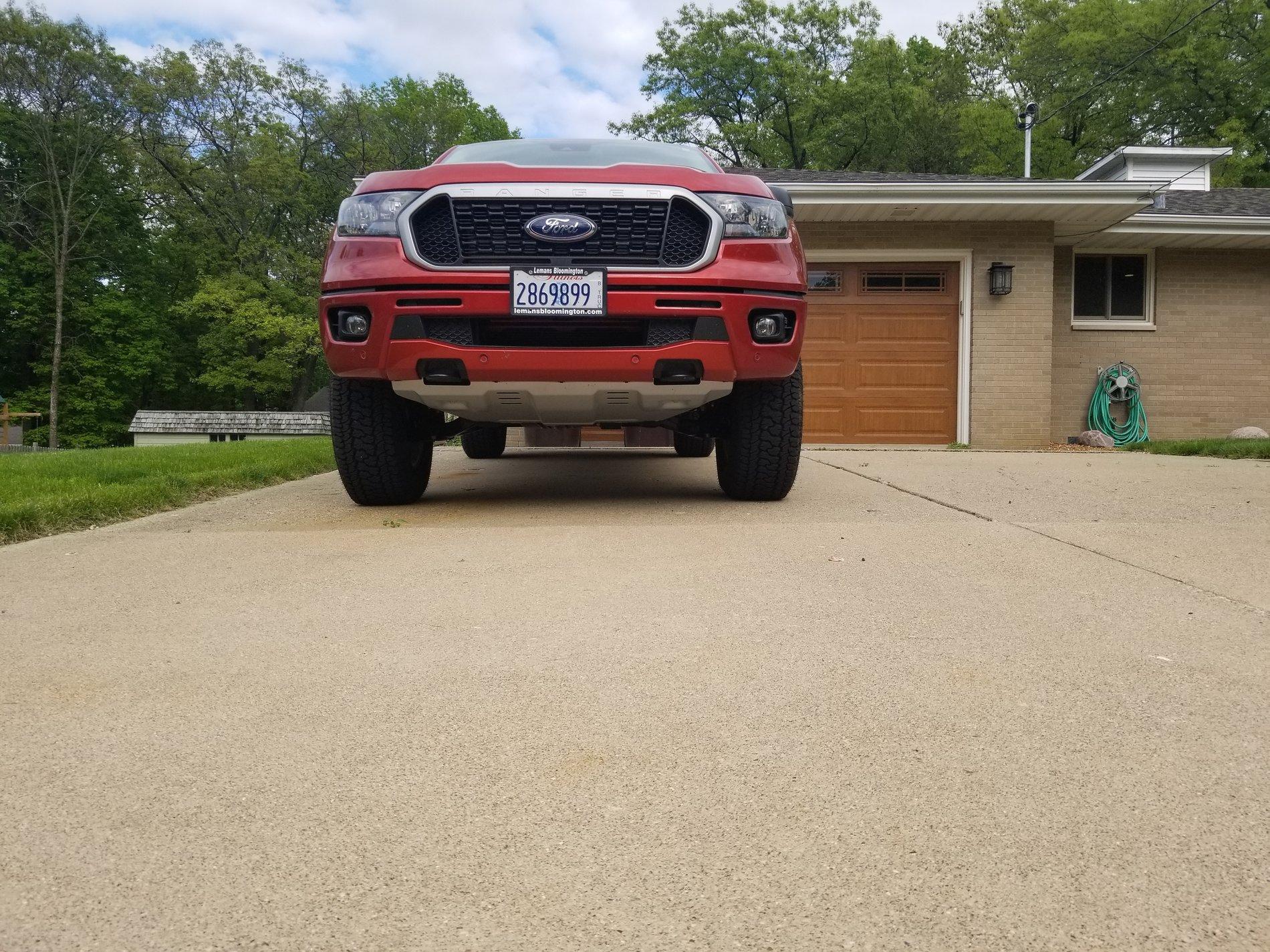

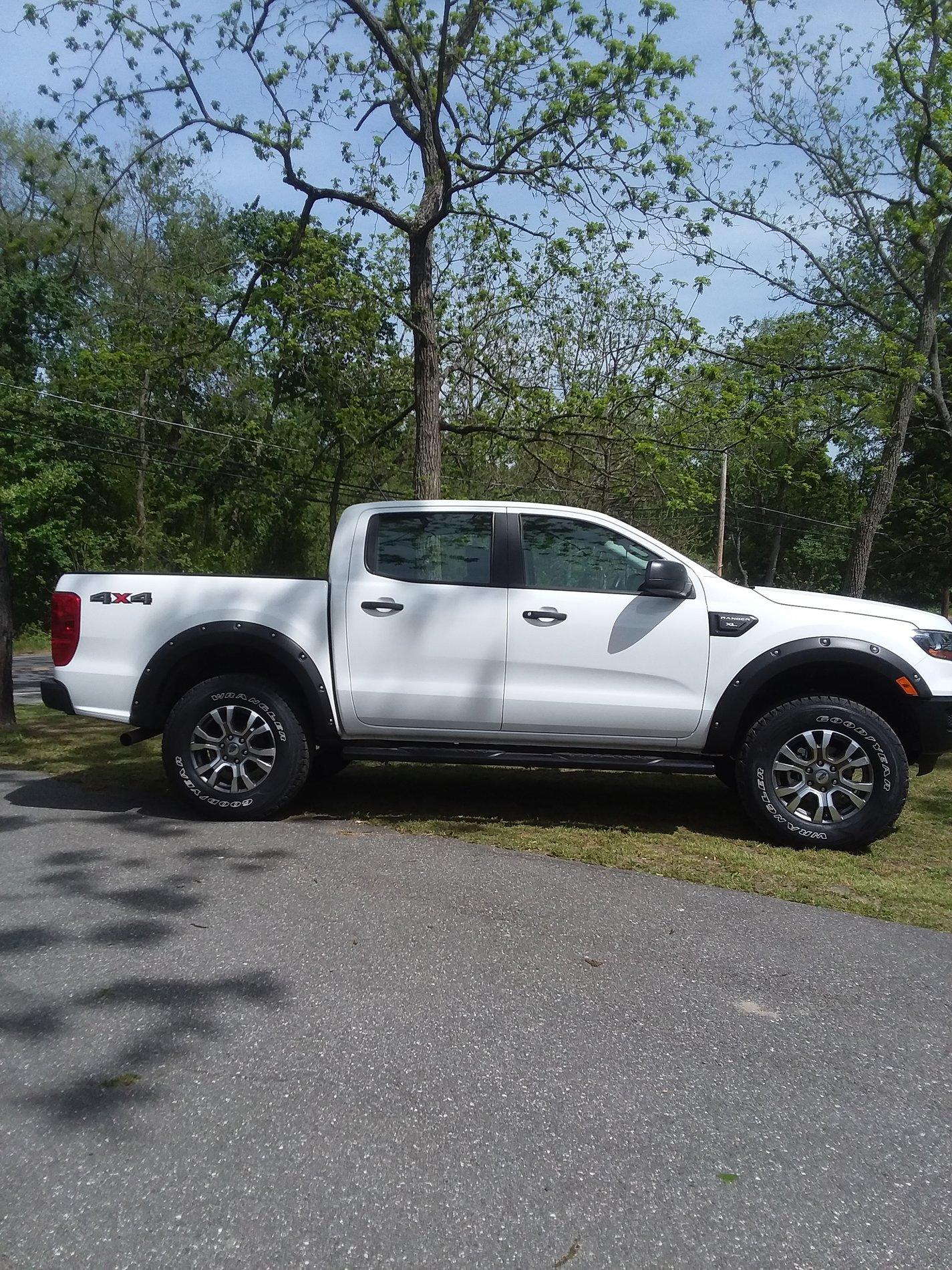

BFG KO2’s 275/70R17
Rough Country 2.5” Level Kit
No other mods. Stock Crash bars still in tact. No rubbing at all. 4,000 miles on this setup.
The BFG’s are the only tire Ive seen fit in this size without removing the crash bars. They run slightly smaller which is why they fit.
I can get better images tomorrow as It already in the garage for the night and Im too lazy to take it out.

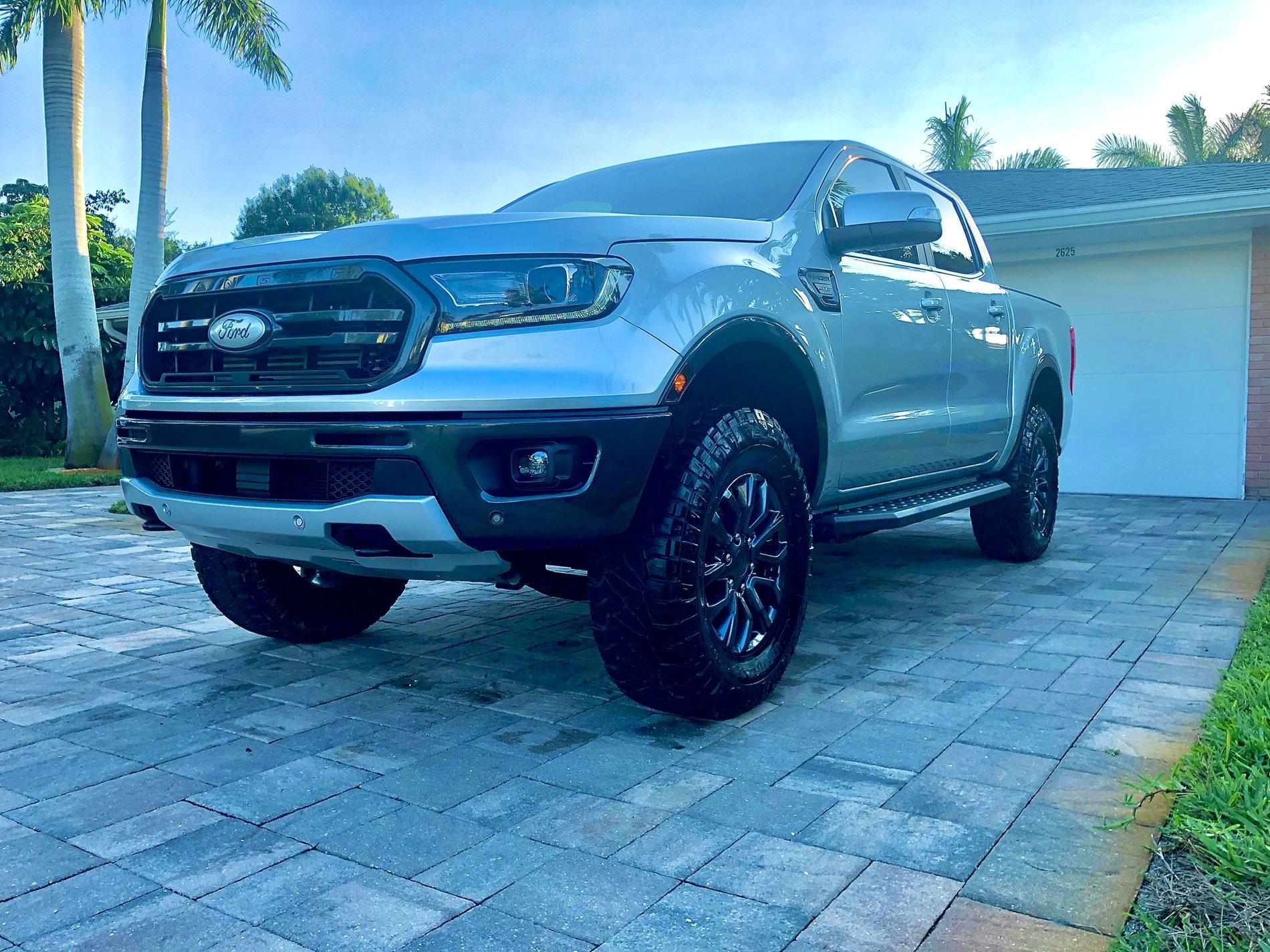

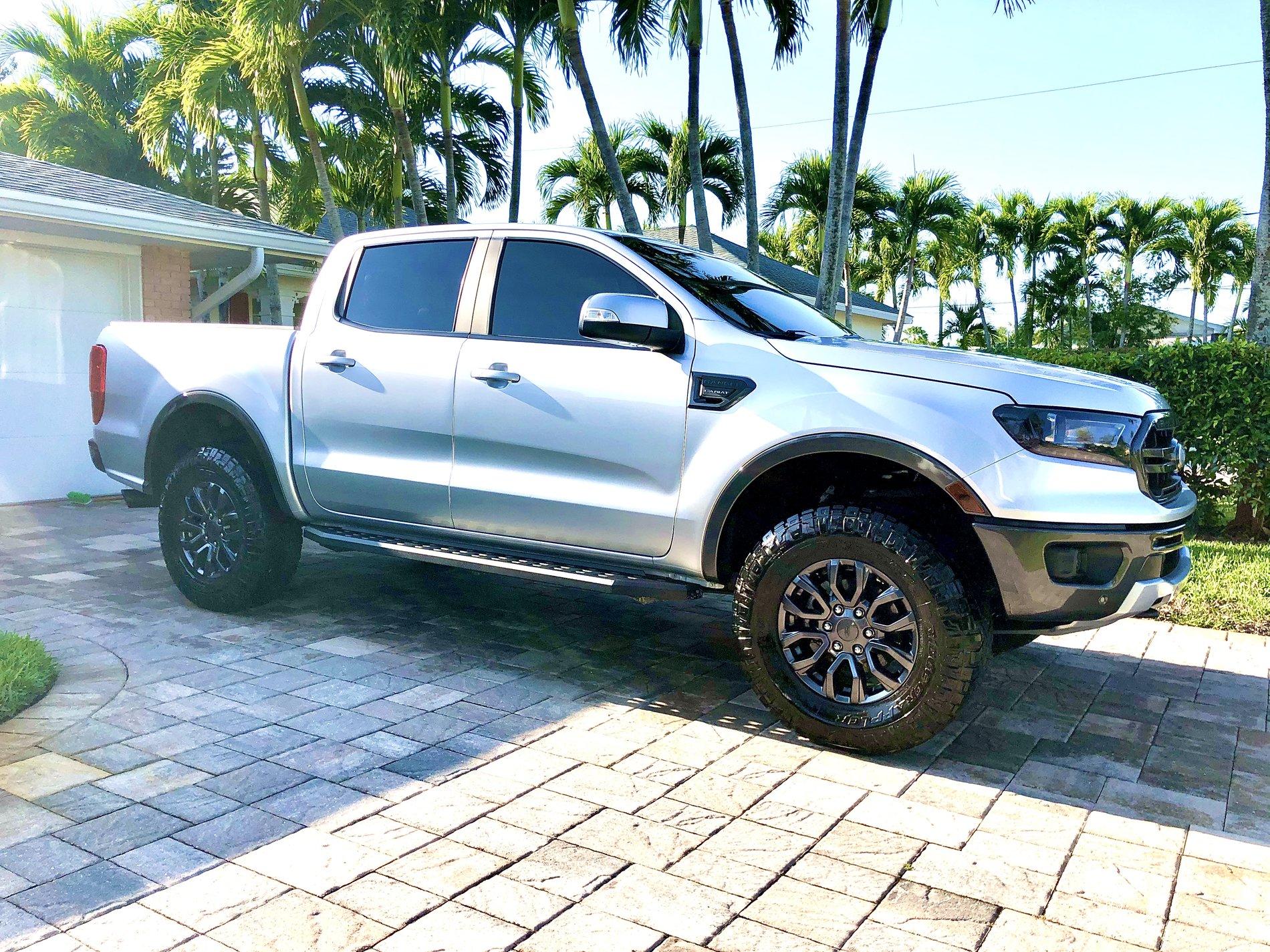

285/70/17, 3” level and 1/4” spacers in the front.

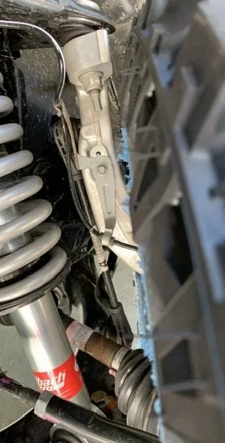

@HoldMyBeer

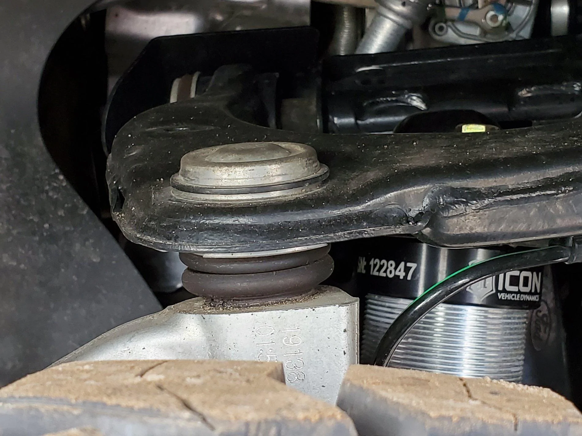

RIP ball joints?
Have you considered aftermarket UCAs?
CO2Ranger
Apr 27, 2020
34
1,094
2,090
What would cause his ball joint to look like that? Ouch.
I have the Icon stage 1 kit, so stock uca's and it doesn't look like that.
It looks like he's at full lock which makes it look worse than it is but if he's all the way at 3" of lift in front then new UCAs are probably a good idea in the long run.
