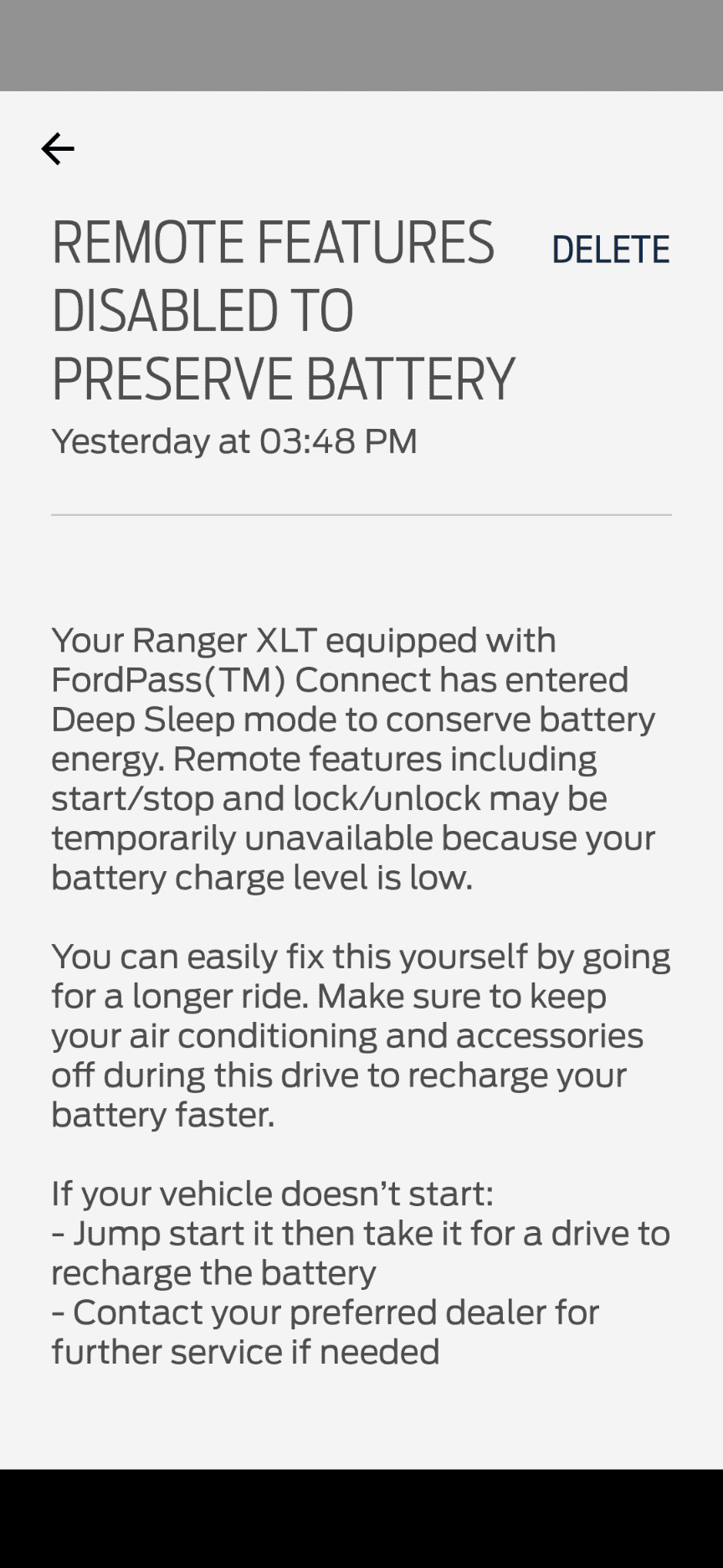

Battery failing?

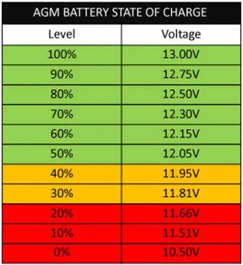

You have to take everything you were ever knew about charging systems and batteries from older vehicles and throw it away, I am still learning this annoying system myself but remember that the BMS keeps battery voltage at 70% or 75% (SOC)
I am researching exactly the Battery Voltage (Minimum) ASS is disabled, but cannot locate that spec.
This is a chart I found on Google; I do not know how accurate it is
