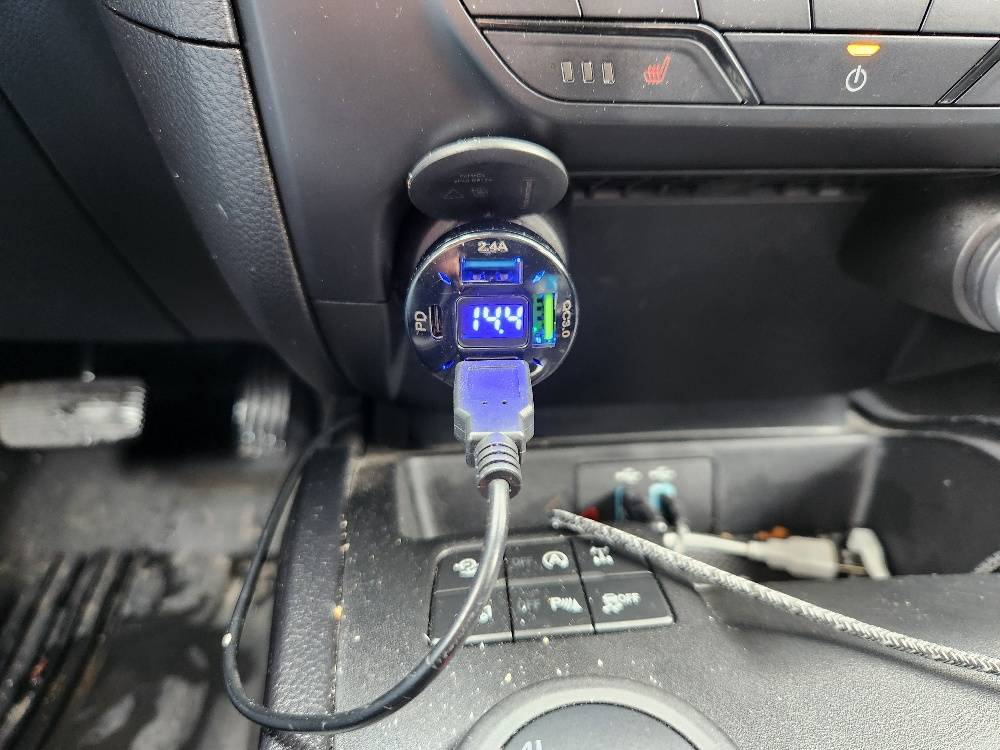

Thank you, I like that product! I’m assuming your camera didn’t capture the battery voltage level possibly from a slow display refresh speed. I can see the “V” on the face where it appears as tho it would display the voltage but isn’t visible.
Where might one get that product, amazon no doubt and how difficult was the install?
I didn't turn on the accessory mode. Or have the vehicle running. That's why the Volts is not displaying.
Amazon has plenty of options. You can simply plug in a volt meter.......
USB C Car Charger Adapter with Voltage Display, 30W Cigarette Lighter Type C Fast Charge Power Delivery & Quick Charge 3.0 (PD & QC), Volt Meter Battery Monitor, Compatible With iPhone 12 Galaxy Pixel https://a.co/d/eCsHqYx
Or have a permanent solution......
USB C Car Charger Socket, Qidoe 12V/24V Dual USB Outlet PD3.0 & QC3.0 Car USB Port with LED Voltmeter and ON/Off Switch DIY Car Socket for Car Boat Marine Bus Truck Golf RV Motorcycle https://a.co/d/3Lup5eL
Those are just 2 examples.
If you don't want to lose a 12 volt socket, I'll go with the 1st choice.

Some Plug in Voltmeters with the incorporated USB ports are limited to 12.6 Volts (Viewable)
If you want an easy cheap solution - For Voltage display only
These work great - Amazon
I also tried the plug in (USB / Voltmeter) Combo and I can only get it to read 12.6 Volts Max, it limits voltage to the USB Charging port.
So I cannot say all of the Combo's will be this way, but just to make you aware that this may be an issue for the Combo Meter's
Now with my testing and others seeing the same results.
Any plug in or direct wire - Voltmeter in the Power-Points will result in a small inaccurate reading of actual voltage. - They will read (.2) volts lower than actual battery voltage.
So, 12.8 at the battery will read 12.6 on the Plug In - Meter
This is the voltage drop across the power point relays.

I needed a new USB charger so I got a 4 port USB charger with voltmeter and it does read above the 12.6. It showed charging @ 14.5 when I took the Ranger to get new shoes. It would drop to 12.2 as soon as I shut the truck off. @subquark it was this one: https://www.amazon.com/dp/B0BLK1LWKS?ref=ppx_yo2ov_dt_b_product_details&th=1

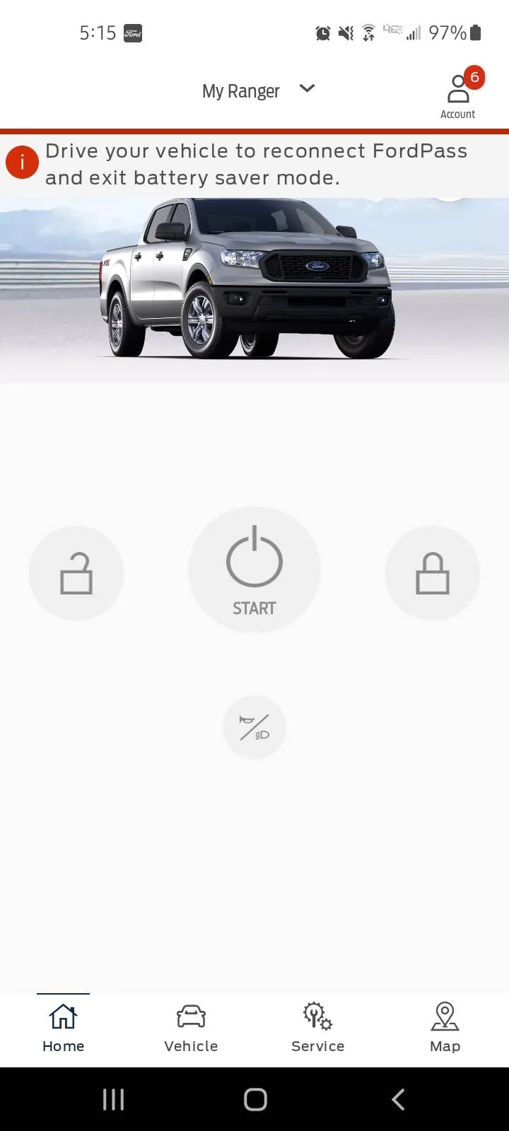

Does this indicate anything? Been happening lot more often past few weeks, starting to piss me off.
Happening to me quite a bit as well, also notably over the past few weeks. My battery is the OEM, only 10k miles and under 2 years. Hopeful this might indicate it's the app, if it's happening to others.
