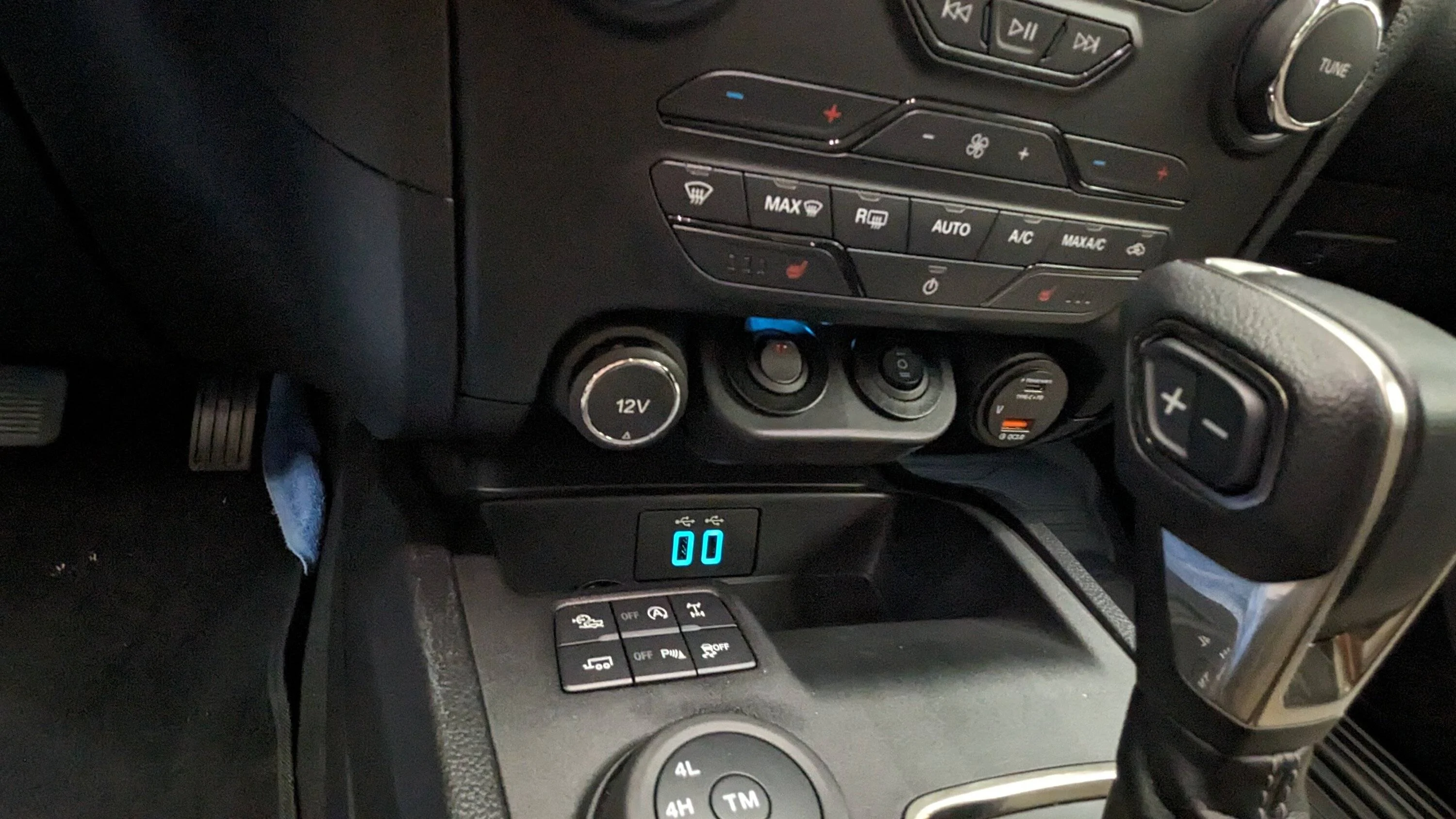

I have a 2019. I replaced one of my 12 volt sockets with a USB A and C charger with a built in voltmeter. Glad I did that because I can keep track of the battery status. It was showing 11.9 volts. Replaced the battery and now I have 12.6volts
That sounds very intriguing and Id like to see a photo of your modification if you don’t mind.

Thank you, I like that product! I’m assuming your camera didn’t capture the battery voltage level possibly from a slow display refresh speed. I can see the “V” on the face where it appears as tho it would display the voltage but isn’t visible.
Where might one get that product, amazon no doubt and how difficult was the install?
