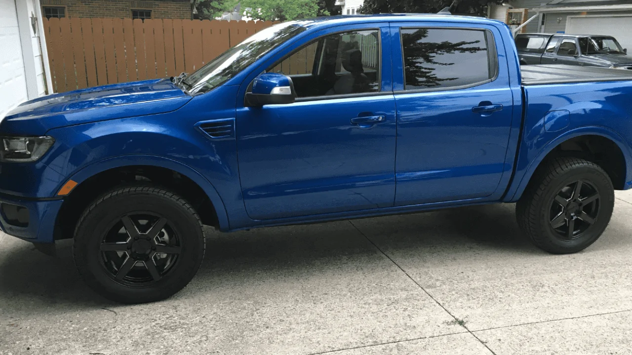

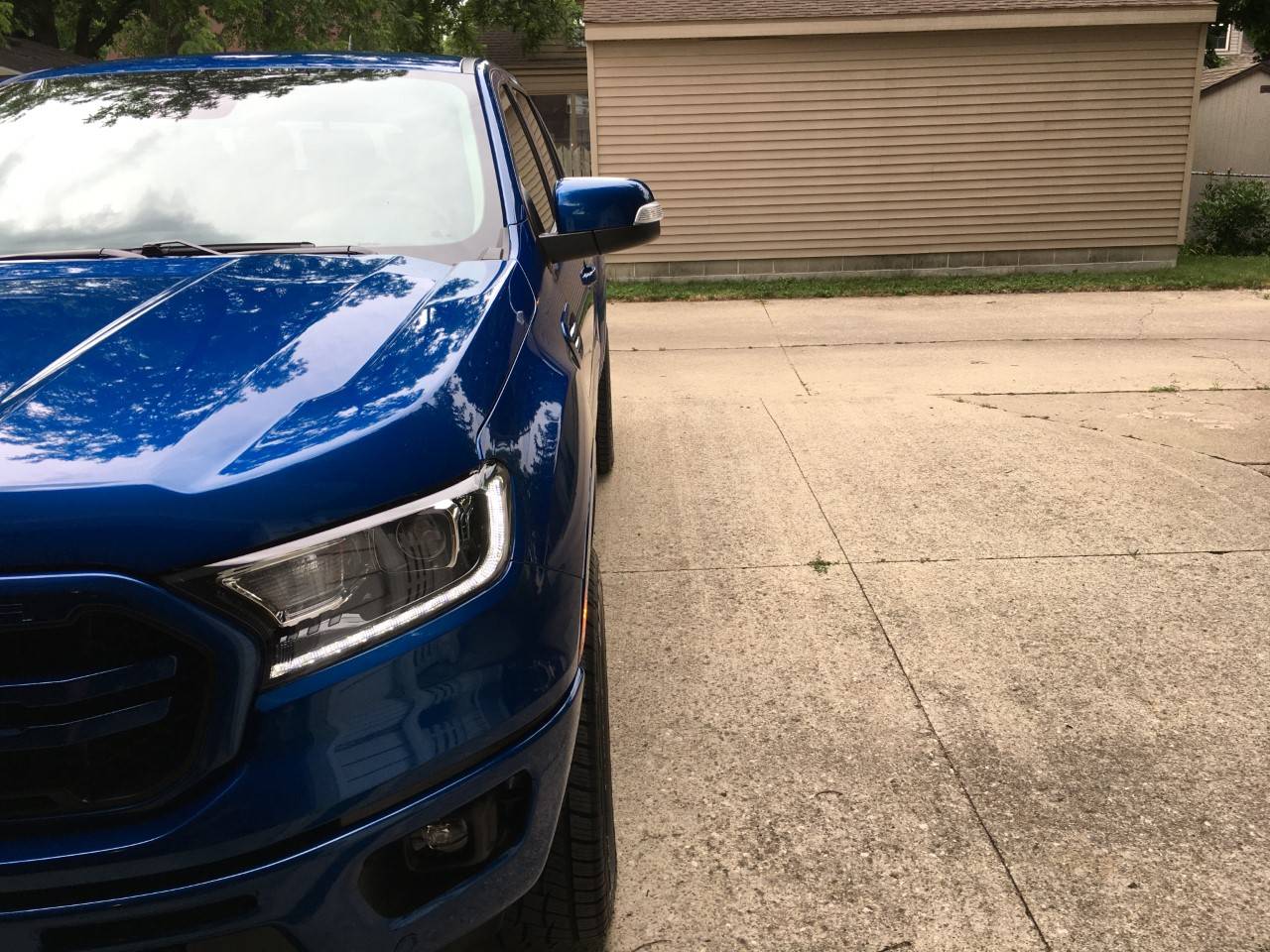

@da808moto -- As far as offset goes, these are Raceline 156B with +35 offset (20mm less than stock) with stock size Cooper tires 265/60/18 and they sit pretty much flush.

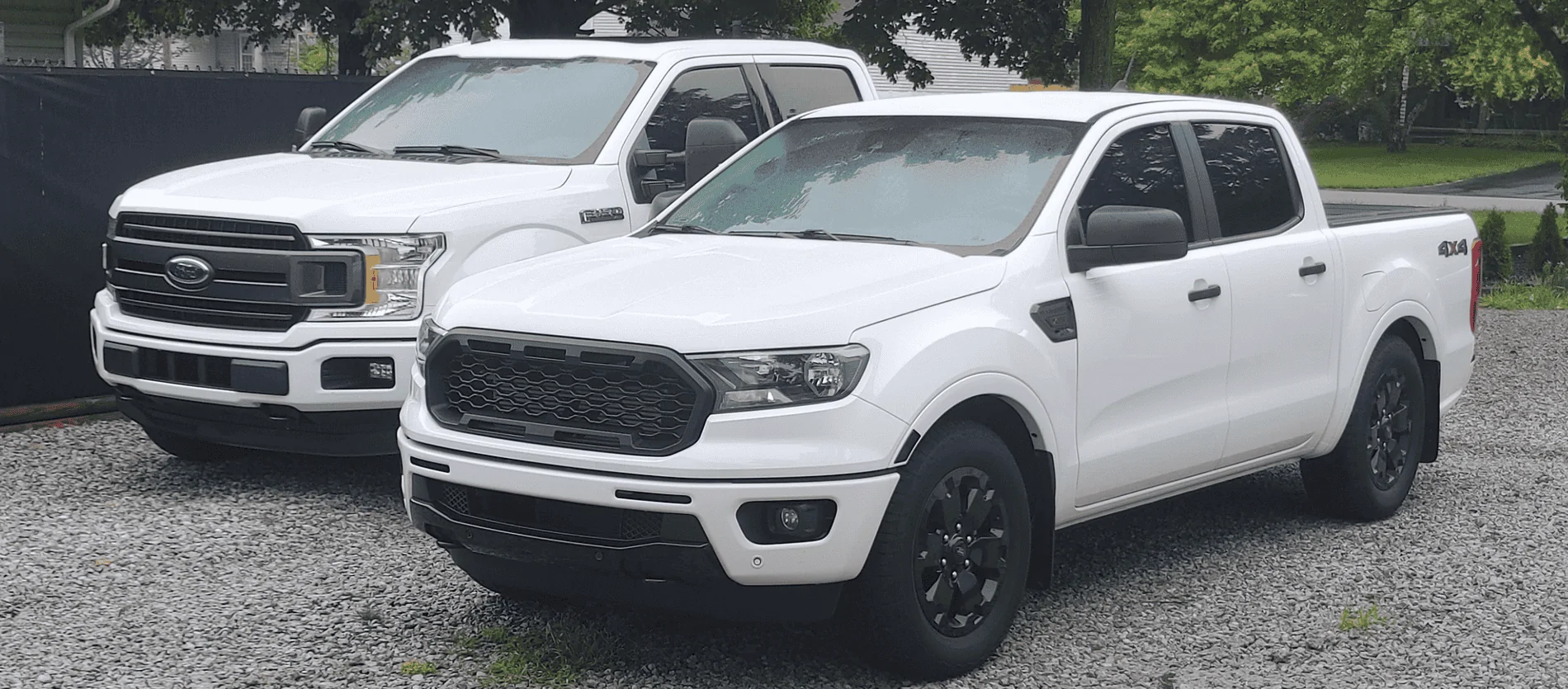

Finally got my wheel and tire experiment done! I am very happy with how the setup turned out. The wheels are 2014 F150 FX4 20" Wheels painted Magnetic Gray to match. I am running 1" thick BORA adapters to make them fit. The tires are 265/50R20 BFG Advantage T/A Sport LT. So far everything has ran well except for a bit of rubbing on the front crash bar at full lock. I may try aftermarket crash bars.
I have decided that I will do an inch lower in the front when Belltech releases their UCA. That project will have to wait until spring. Hoping the extra drop will fix the rubbing at the front.
Just ordered a LUND Elite roll-up tonneau cover and bed mat. Planning to tint the windows soon.

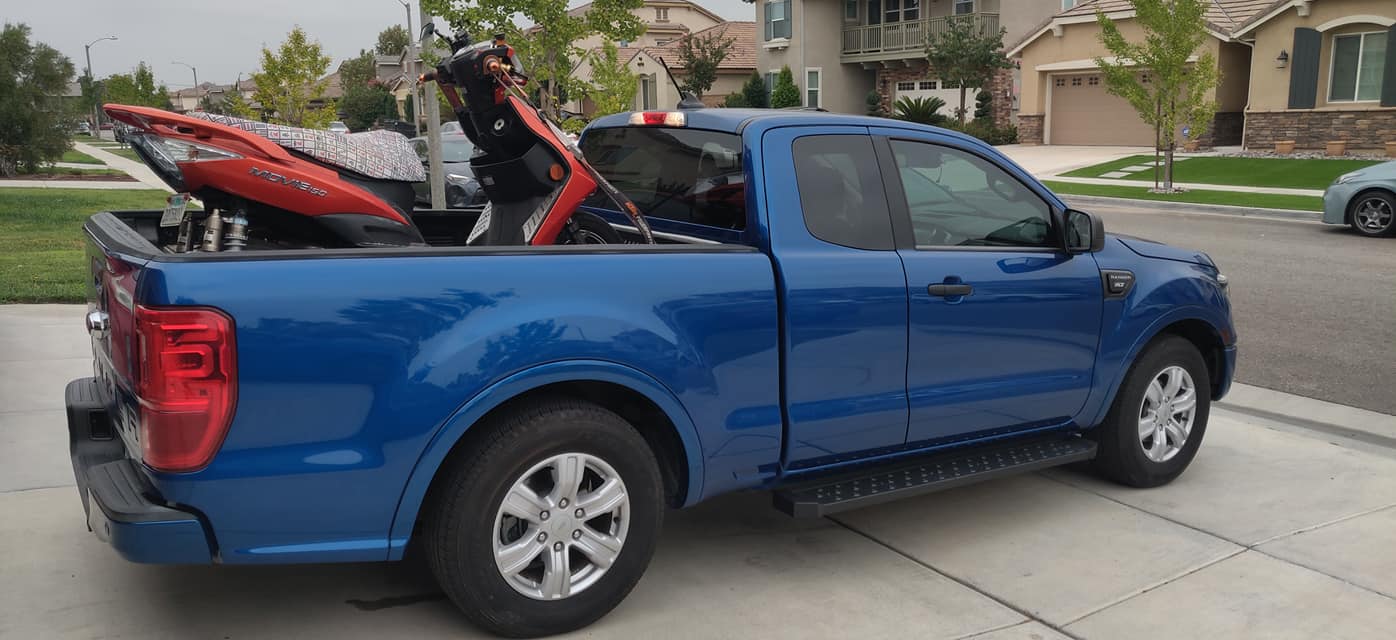

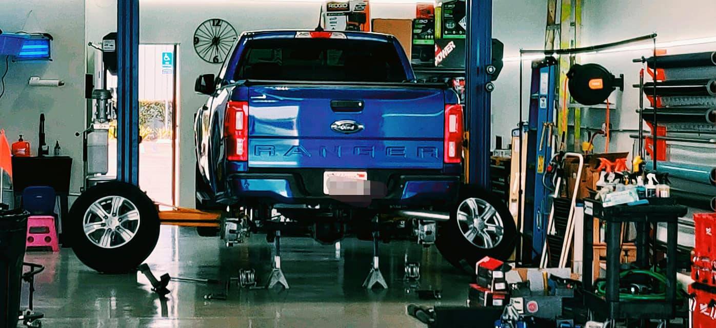

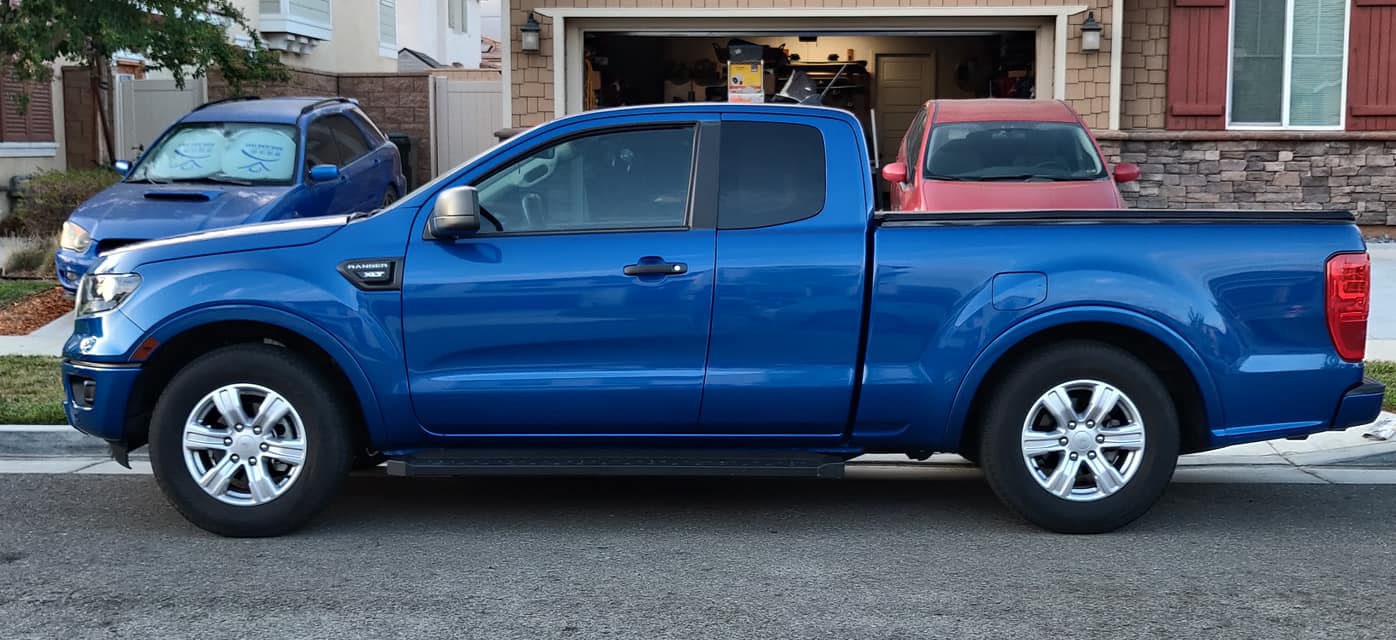

Installed the Belttech Kit like a month ago, when with 2 front 4 rear. I am planning to get either spacers or aftermarket wheels to make the wheels more flush with the fenders.
IF I plan to use my Stock STX wheels, what size spacers i should get?
If I plan to get aftermarket wheels, maybe 18 inch, what size rim, tires and offset I should get?
I would go with an inch think spacer.
You could tape a plumb line to the top of the fender and measure from it to the wheel. That will give you an idea of what thickness spacer you would like.
Also remember that you may have rubbing issues with a spacer. Turn your wheels full lock both ways and check how much space you've got to the front and rear crash bars.

That looks fantastic! I knew those wheels would good on there. BTW, that is one handsome truck you've got there.

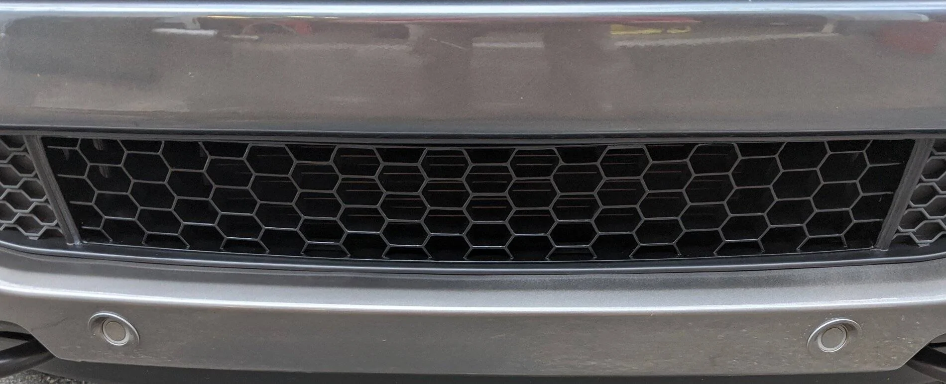

Have you done anything with the light gray lower valance? I can't stand that color and, really want to get it color matched.

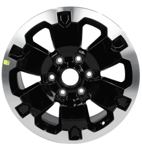

I totally agree! My Shadow Black Lariat 4x4 originally came with the upgrade to the 18" machined wheels with magnetic painted pockets -- the same kind of wheels as shown in @Doc 's profile pic. I think they look great on his truck, but on my black ride, I felt they made the truck look a bit "prissy"...certainly less masculine. As such, with my FordPass points about to expire, I decided to order the OEM accessory wheels pictured below. They're basically the wheels that come with the black appearance package, only the outermost face of the wheel is machined, not black. While I think they look better on the truck than the original "upgrade," the machined face just stands out too much and is starting to annoy me. But after seeing what @66F100 did with his truck, it has me considering getting my original "upgrade" wheels painted all magnetic.

Those Black Appearance wheels are my favorite stock Ranger wheel. The problem that I have is that I think that anything smaller than a 20" wheel doesn't fit a Sport Truck build. Just my opinion but that is why I wanted to get something larger than stock Ranger wheels.
Going with the painted F150 wheels worked out for me but may not for others. I paid $275 for the wheels with tires and sensors, $280 for the adapters, and $300 for the paint job. That totals $855 just in wheels. I have been trying to sell the tires that came on the wheels but have had zero interest. The paint was done by a friend of mine at a price that I think is really cheap and, the wheels were very cheap for my area. I think that my setup was quiet a bit less than most people would pay for similar.
All that to say that I am happy with the setup but you may not have such luck.
You really have to spend some time figuring the cost of stock wheels versus your choice of a custom wheel. I could very easily see someone spending more to get a set of stock Ford wheels to look and fit the way you want them too versus just buying a set of custom wheels that fit right out of the box. It's all a personal choice.
I wanted to share my setup so that others can see a different solution to the same problem. I likely would have went with an aftermarket wheel if COVID hadn't screwed up production at Centerline and American Racing Wheels in CA. But I am so happy with this setup that I am fine it went this way, everything happens for a reason!
Yes, I painted it a lighter variation of the Magnetic gray. By doing that, it kept the contrast but in a more subtle way than the silver. The color is Toyota Phantom gray 1E3
